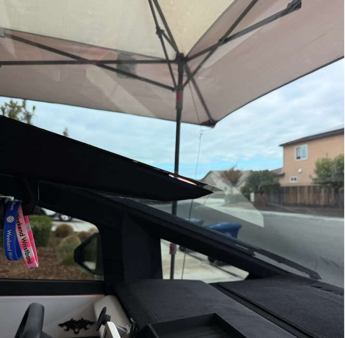

My nomination in the central windshield camera cover being slightly seperated, and not a tight fit, to the windshield... but only on the passenger side. The driver side is tight to the windshield. I brought it into the service center (along with other issues), and told them they must have done that when they cleaned the cameras and glass due to out-gassing, and they said it is just like that. They said they checked other Cybertrucks and they are all like that. Seems supect to me though...
Is everyone else's cover seperated and not a tight fit on the passenger side?
This happened to me after service center cleaned the windshield behind it. They made a mobile service visit to fix it - required adding a few pieces of white tape on the clip holders that helped it stay clipped into place better.
