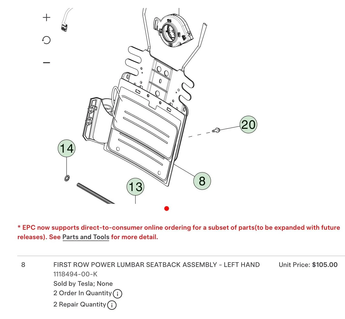

I have issues with the lumbar support In the driver seat not staying inflated. Works fine on passenger side.
I know there is likely a leak in the bladder there but SC has not yet acknowledged it.
Is the lumbar support different in the CT? In my Model 3, it's just a plastic plate that moves around. No bladder. Maybe that's why service is not acknowledging it if there's no bladder to leak.
Ok, went to look at the EPC, and it does look like a bladder:
Tesla Cybertruck What’s broken that you might not realize? Example: beast top speed of 114=bad inverters 1746979906602-2c
And since I wasn't sure if that was a bladder or plate, I went to the page for my Model 3, and it looks the same, so those must be plates, and not bladders, which kind of makes sense that Tesla would try to minimize parts. They've even got the same part #, though my Model 3 is 6+yrs old.

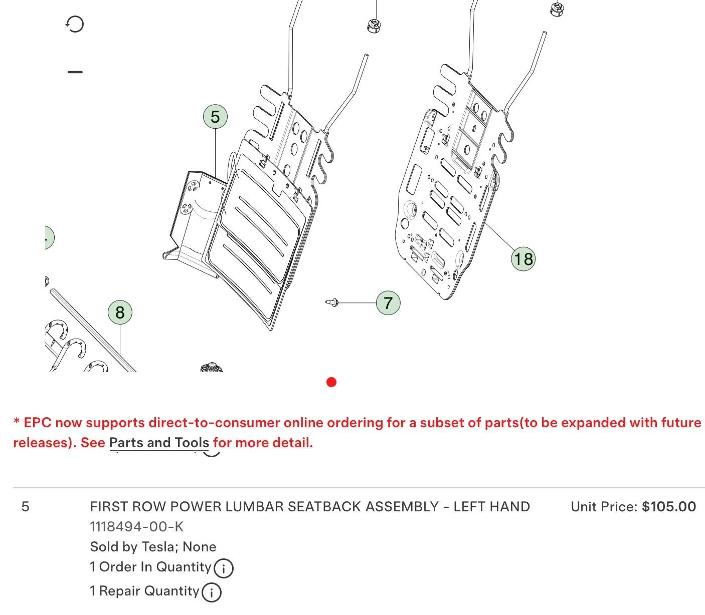

Bladders and pump

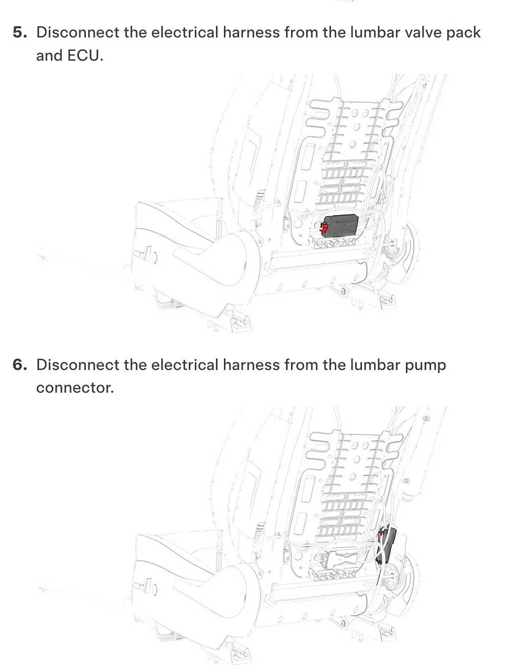

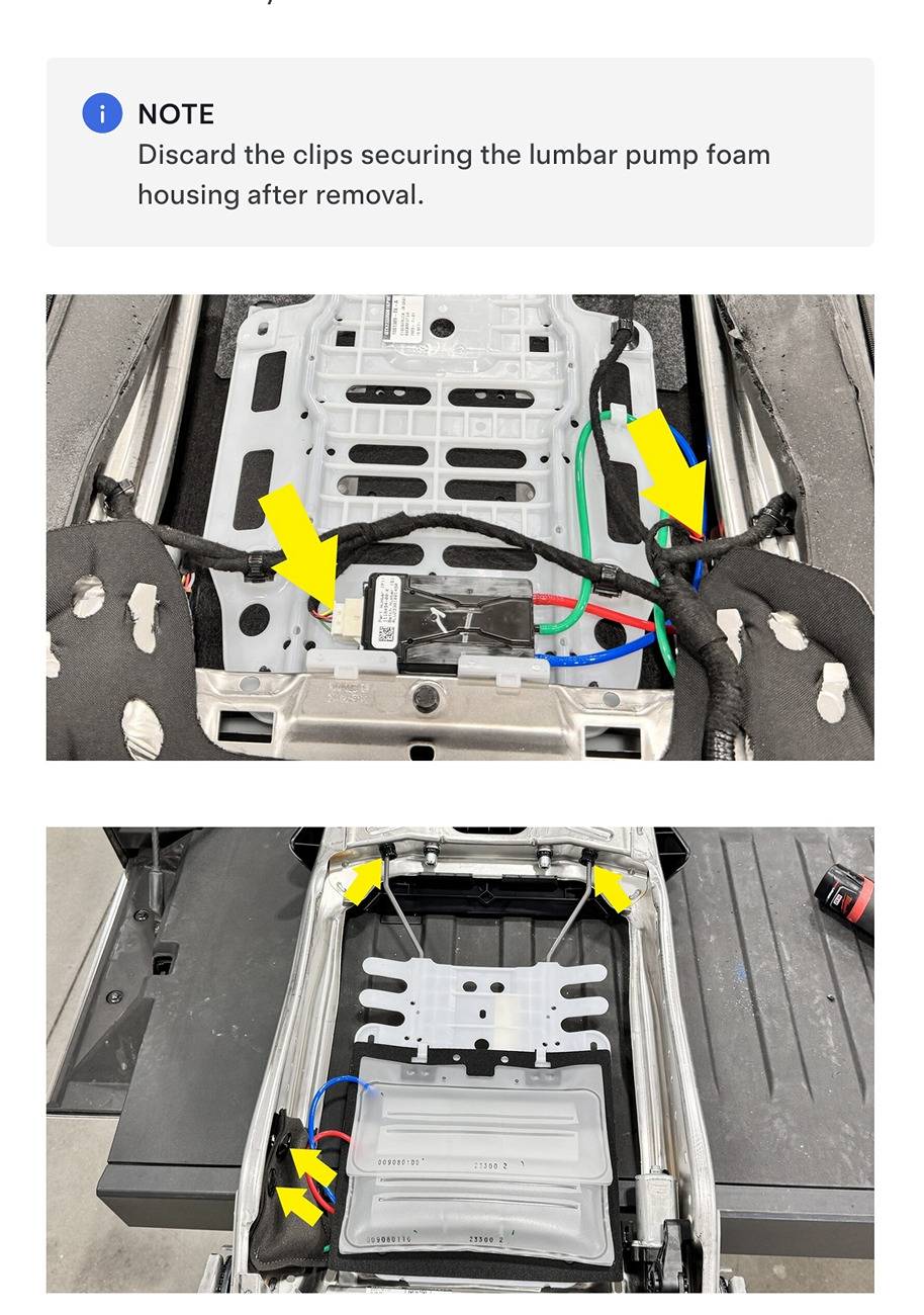

Bladders and pump
Interesting, so the replacement part for my Model 3 is a bladder, and not the original plate.

It's not, but a recent X thread with Lars mentioned possibly approximating the setting (there is no inflation feedback sensor to use like the other seat adjustments have).
Model 3 has always been bladders also. The assembly includes a plate though.
Tesla Cybertruck What’s broken that you might not realize? Example: beast top speed of 114=bad inverters SmartSelect_20250511_175010_Firefox
Tesla Cybertruck What’s broken that you might not realize? Example: beast top speed of 114=bad inverters SmartSelect_20250511_174850_Firefox
