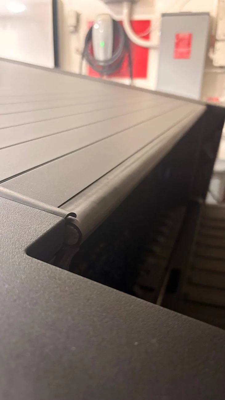

here’s a pic.
also, after inserting the foam, make sure to leave around 2” excess on both sides before cutting. Leave it for a day with the excess to give the foam time to shrink back before cutting the excess.
the cone makes it easier to insert and fish the foam to the other side of the weather seal.

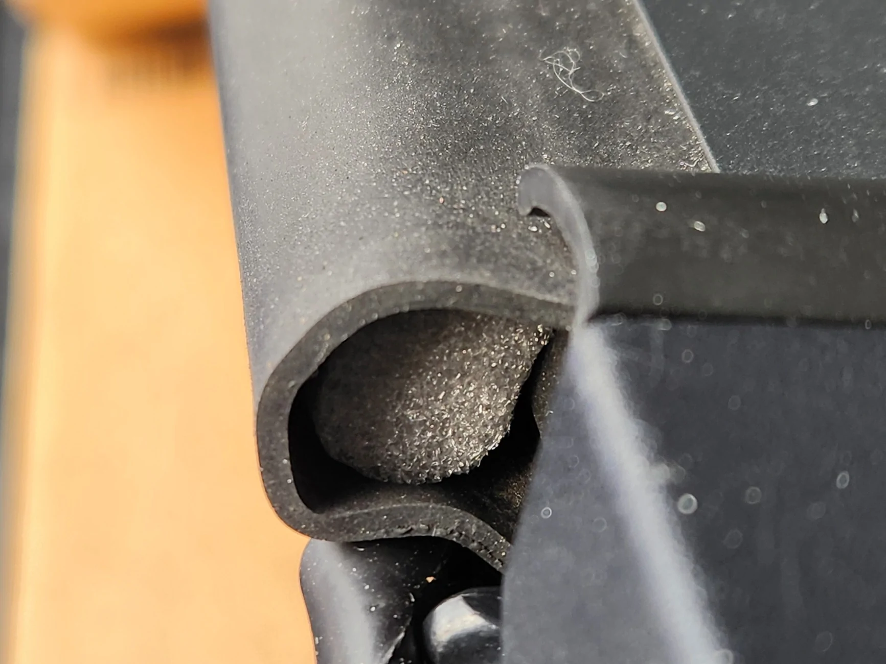

Here ya go man. Not much to see. I took a short video too so you can see it pushes the tailgate just a bit.
For some reason the pic isn't uploading but you get the idea from the one posted above. And yes, as mentioned leave extra foam to cut after a day or two. I didnt and mine is a bit short

I don’t think my vault leaks there. Only in a couple spots up front by the window and even those have gotten better with repeated bitching at the service center.
that’s a really cool solution though.

People were saying they wanted to do it more for dust, but mine had a little water leak there because I don't think my tailgate is perfectly square, the gap on one side was just a little larger so the rubber didn't quite seal it off... I haven't water tested it because it's too cold out for a hose.
I also did the foam on the bottom of the bed where it meets the tailgate to prevent dust there too. Used a different foam there tho as the rod would just fall out every time you open the gate
