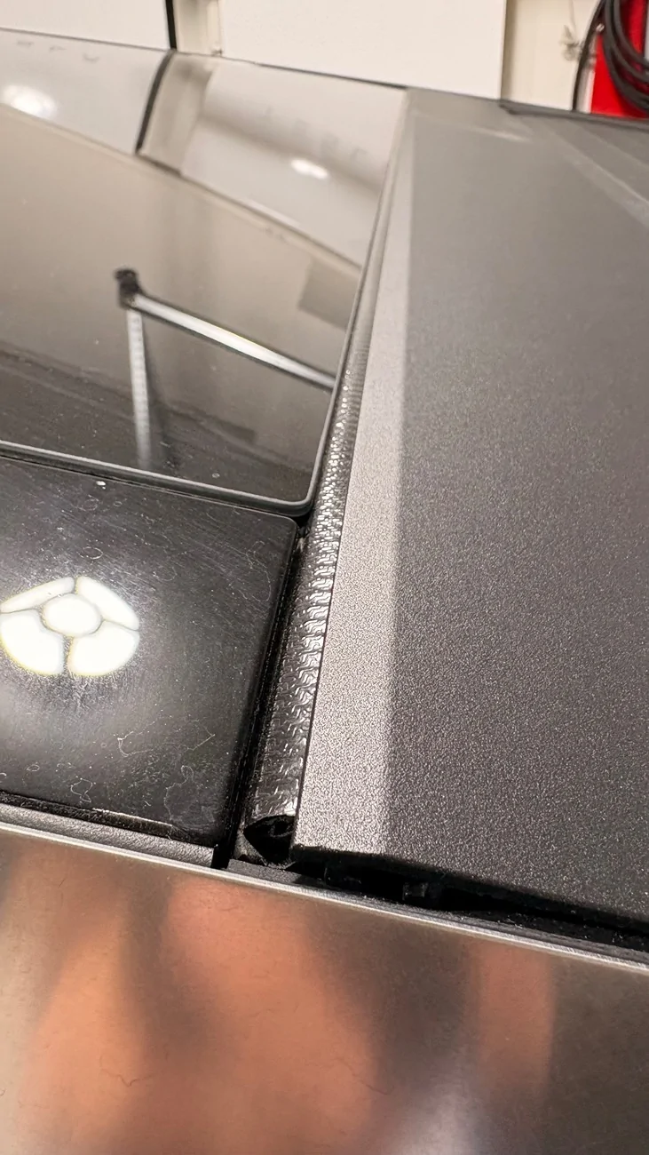

Was looking at this one which seems to resemble yours.
https://a.co/d/3QxPiMl
And this one which looks like it’s a more pliable material and intuitively might seal better
https://a.co/d/2hKtmkc
Any advice? What made you go for the textured/corrugated option?
that’s left over from my doors. So I just used what I have.
the non textured ones will look better but it might be too soft to make a tight seal on the glass

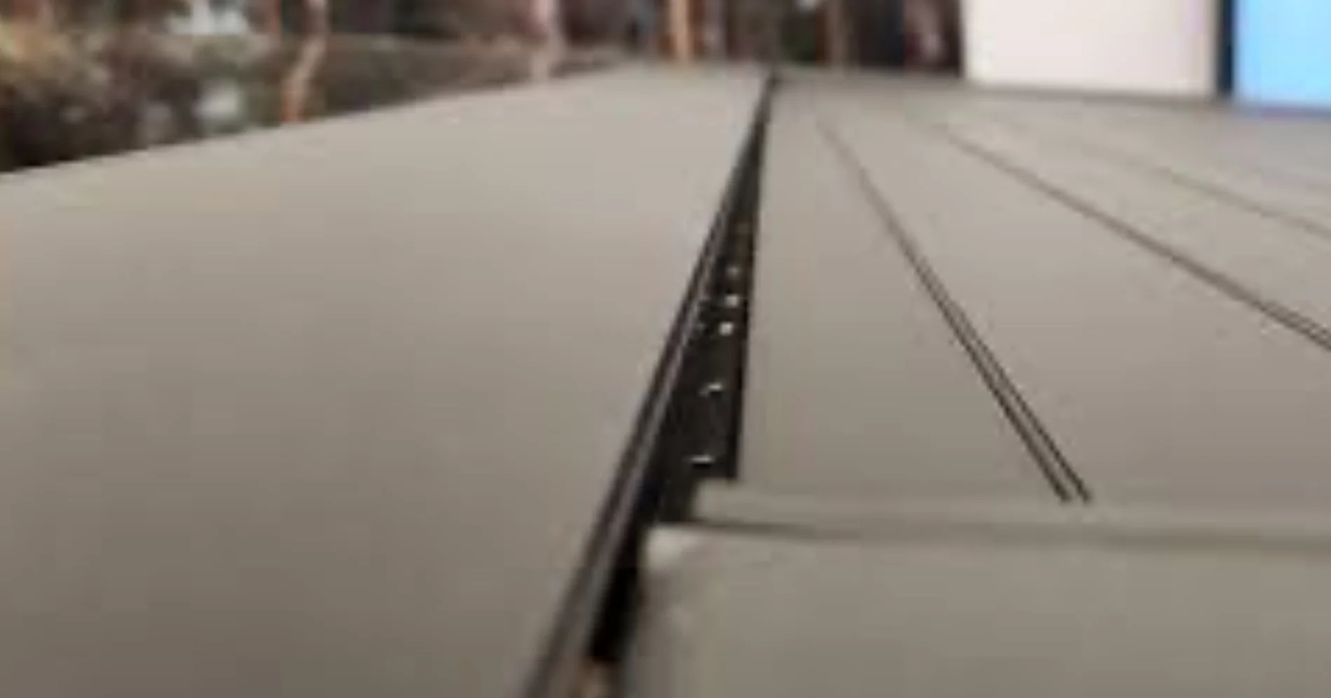

Is there a product you use to keep water/weather/dust out of your tonneau? Going across my ranch it's filled with dust in seconds.
With the tonneau closed are rivets visible at the back side? This is a common problem with many Cybertrucks. It allows water and dust enter the bed.
Check your truck…if you have rivets showing, your tonneau is too short. There is a fix for it. Tesla will add extra slat section to the tonneau. Tesla will fix it ONLY if you ask for it and let them know of the water/dust issue.
Once I had my Tonneau “fixed” I have no issues.
