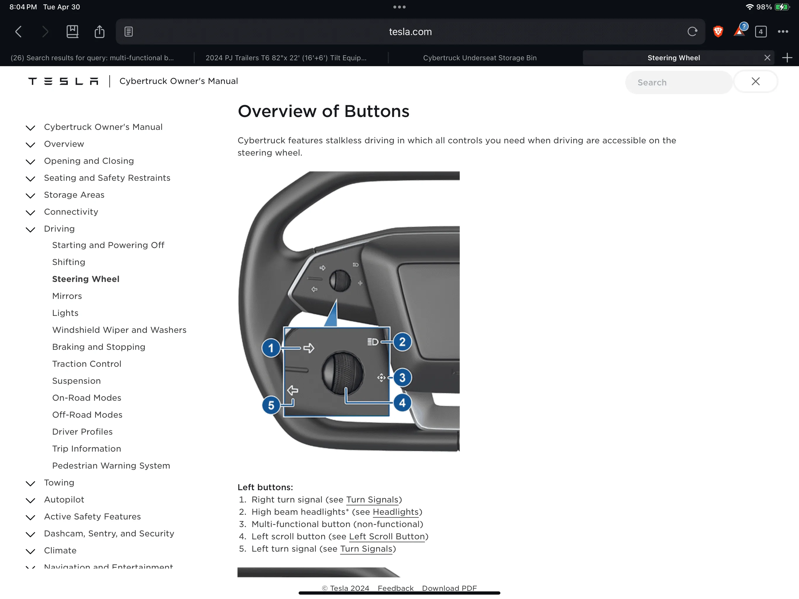

I keep looking at this mysterious button on the steering wheel of my Cybertruck and I have no idea what it does. The manual calls it the “Multi-functional button” and describes it as non-functional. Is this expected to be a programmable button in the future or something like that?

Check the newest update? You can program it I think!

Yup, the 2024.14.3 update allows it to be customized when held down. You can choose to have it control one thing or to ask each time.

The “multi-function” button refers to the scroll-wheel. Each side of the steering wheel has 3 labeled buttons, and a fourth label that is not a button but instead refers to the scroll wheel. I spent days trying to press that thing lol
The left scroll-wheel can indeed be given a custom function. I just now set mine for the glovebox, so now I just long-press and voilà!
This was not intuitive to me either. Same applies for the right side. I was trying to press the icon for cruise control, not knowing I was supposed to press the scroll wheel.

Yep, it works for me now after the new update. I went with fan speed control.
