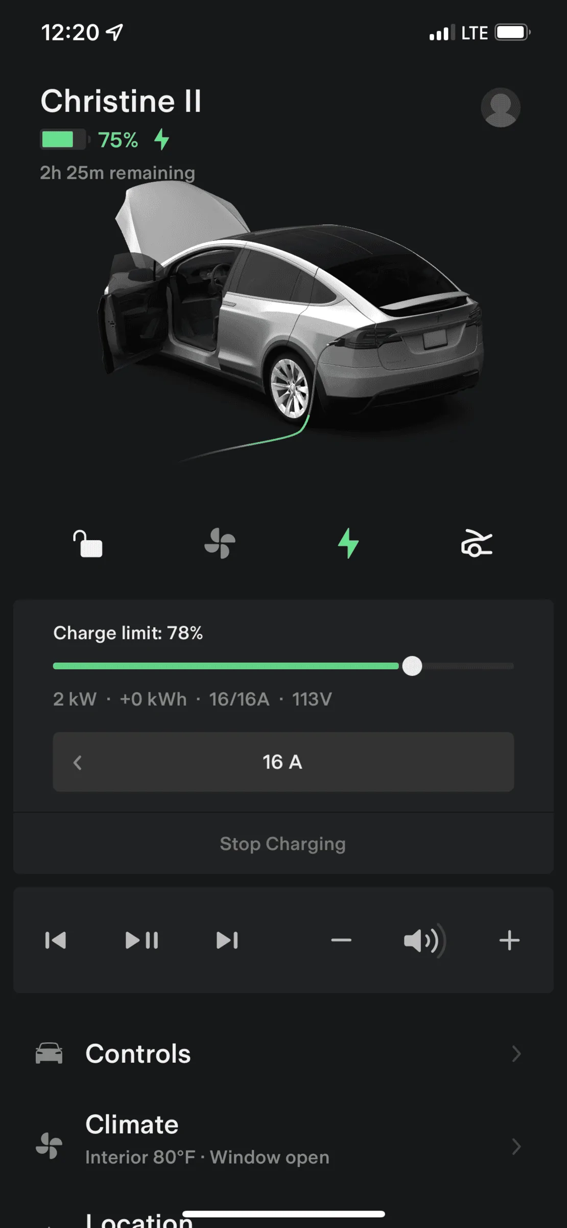

So what's your take on the set up/ voltage requirements to be ready to welcome home your new CT???
It just occurred to me that an important aspect of the answer to that question is Tesla's new policy of NOT including a UMC with its vehicles any more so that if you don't have EVSE set up at home you will not be able to charge at home from any outlet in your house be it 120 or 240. Keep this in mind when (and if) the CT actually ever starts delivery. By that time Tesla may have reversed the policy. I hope so because I think everyone should have a UMC with the adapter kit on board whenever he is out and obout in his Tesla. Now I admit that I am on my second Tesla and have never used the UMC (except for some tests yesterday to rebut the absurd comments made about it at 120V) and as the public charging network expands it definitely provides less security but I still like knowing it's in the frunk.
While discussing the UMC I'll mention a feature of it that has not been mentioned here (that I recall) and that is that it accepts 16A from a 20A 120V receptacle. These seem to be required in some parts of a house (such as kitchen and garage) these days and are distinguishable from 15A outlets in that the neutral "pin" is T shaped rather than I shaped as in a 15 A receptacle. That allows them to accept the NEMA 5-15P (| . |) and 5-20P (| . -) plugs the latter being rated for 20A. The UMC has adapters that program it to tell the car how much it may draw. Thus to get the 16A you must have the 5-20P adapter which can be bought separately or one can buy the adapter kit which includes it. The only adapters that come with the UMC itself are the 14-50P and 5-15P. While 1920W may not seem much of an improvement compared to 1440W it is a 33% gain.
So you will have to buy EVSE, be it the UMC which used to come free with the car or a wall "charger" or some other portable solution. This gets us back to what I think the OP really wanted to know: how big should the wiring be? The answer to that is, IMO, as big as you are comfortable with financially. A factor to consider with the Cybertruck relates to its consumption of over 400 Wh/mi relative to the 200 -350 Wh/mi consumption of other BEV. Home charging is done to replace miles consumed in daily use. If I use 100 mi/day in an MX that means I need to replace approximatley 32 kWh each day. In a CT it might be 49. EVSE on a 60A circuit can do that in about 4.25 hr. EVSE on a 30A circuit would take twice as long (8.5 hr). Note that the corresponding times for the MX are 2.8 and 5.6 hrs using, respectively, the 48A from a 60A circuit and the 24A from a 30A circuit.
Most of you should be able to do the math for your own situations based on your anticipated daily use. Obviously having to add more than 100 miles per day in a vehicle that consumes 450 Wh/mi is going to drive you towards the larger wire size (and with it, more cost but do not give much credence to anyone who tells you that 50A is "astronomically" more expensive than 30A). Think about the future too. Will you acquire a 2nd BEV within a year or 2?
