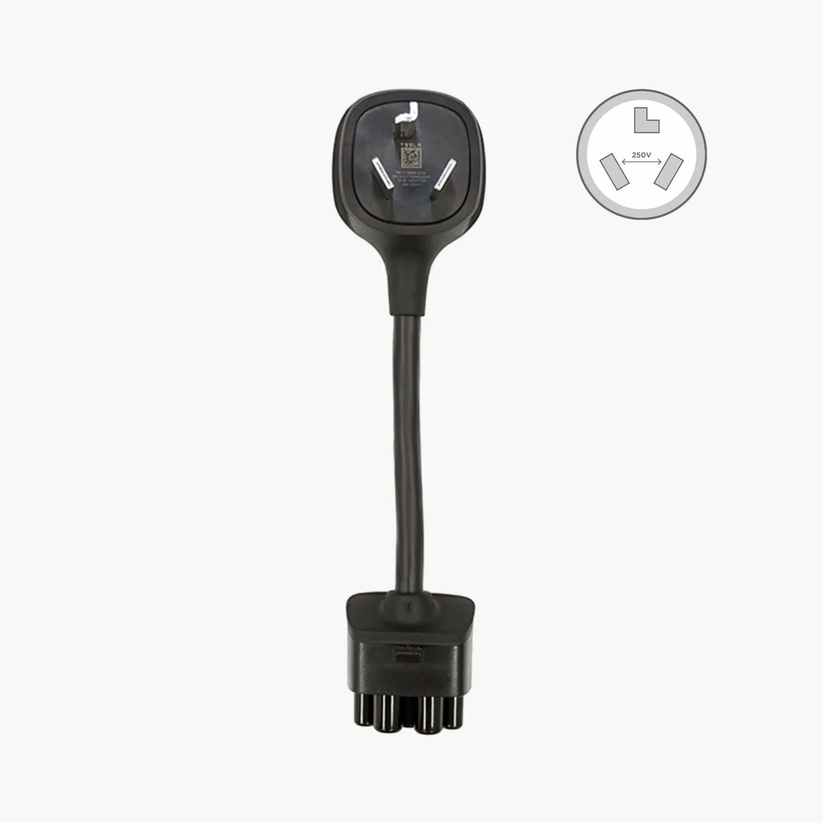

Also, it needs four wires in the US, not three. Hot, hot, neutral, and ground.
That's just not true, most things in the US do not need a neutral. I've never installed a Tesla plug with a neutral; worthless. You order the 10-30 plug from Tesla, three prongs. Some appliances need the neutral so that they can power 120v components, but most do not. I can't think of any shop tool, welder, motor, etc that needs the neutral.
What is this in respose to? What's just not true?
] Me either. HPWC do not require neutral because they do not draw 0 sequence current.
useless[\QUOTE] Again you advertise your lack of familiarity with electrical systems. The neutral is there for a reason. It conducts 0 sequence (imbalance) current in any system which has it such as your house, your modern clothes dryer and, of course any tool or applicance (such as the many on my garage shelf) which do not differentially tap the phases.
Would we expect an appliance which does not require the neutral to use plugs that do? No but the UMC is not an appliance which does not require the neutral as it does require it for the 120V adapter. And includes it.

Anyway, no, 4 wires are not required if the connected appliance does not use the neutral and no, most EVSE do not use it.
Note also that my post said most of the difference was in the wire as the box, outletconduit and circuit breaker are all the same or nearly the same. I suppose you could argue that the electrician will require more hours to pull the heftier wire (or will charge you more in any case).
I will also add that whenever I have a 240V circuit pulled I always pull the neutral too. You do not know that you may, at some future time, want to replace that EVSE with some other appliance that does require the neutral.
