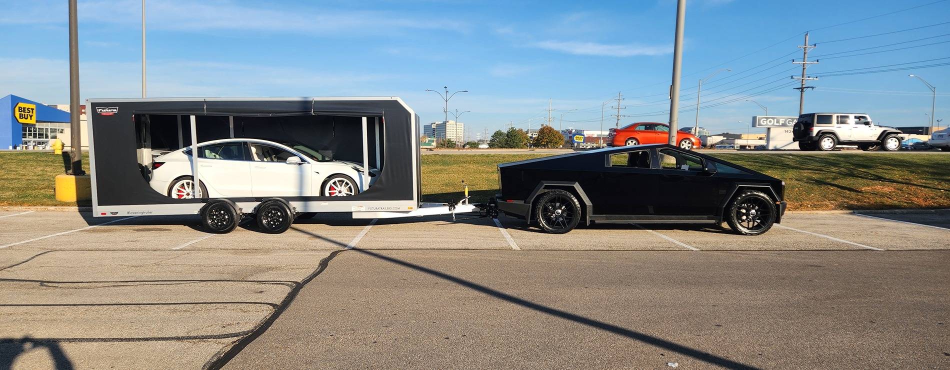

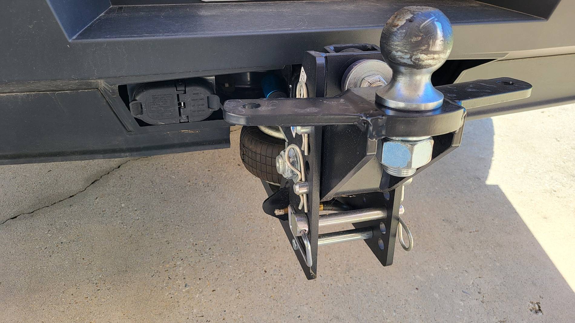

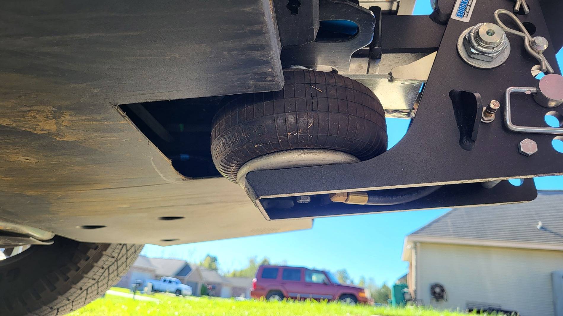

I have the "Shocker Air Equalizer & Chain Style WD Hitch 12,000 lbs GTW for 2-5/16 Ball - 8 Hole XR Frame (#SH-7002/SH-7500)"
Tesla Cybertruck Which "Shocker" shock absorbing trailer hitch? Hitch
It works perfectly.

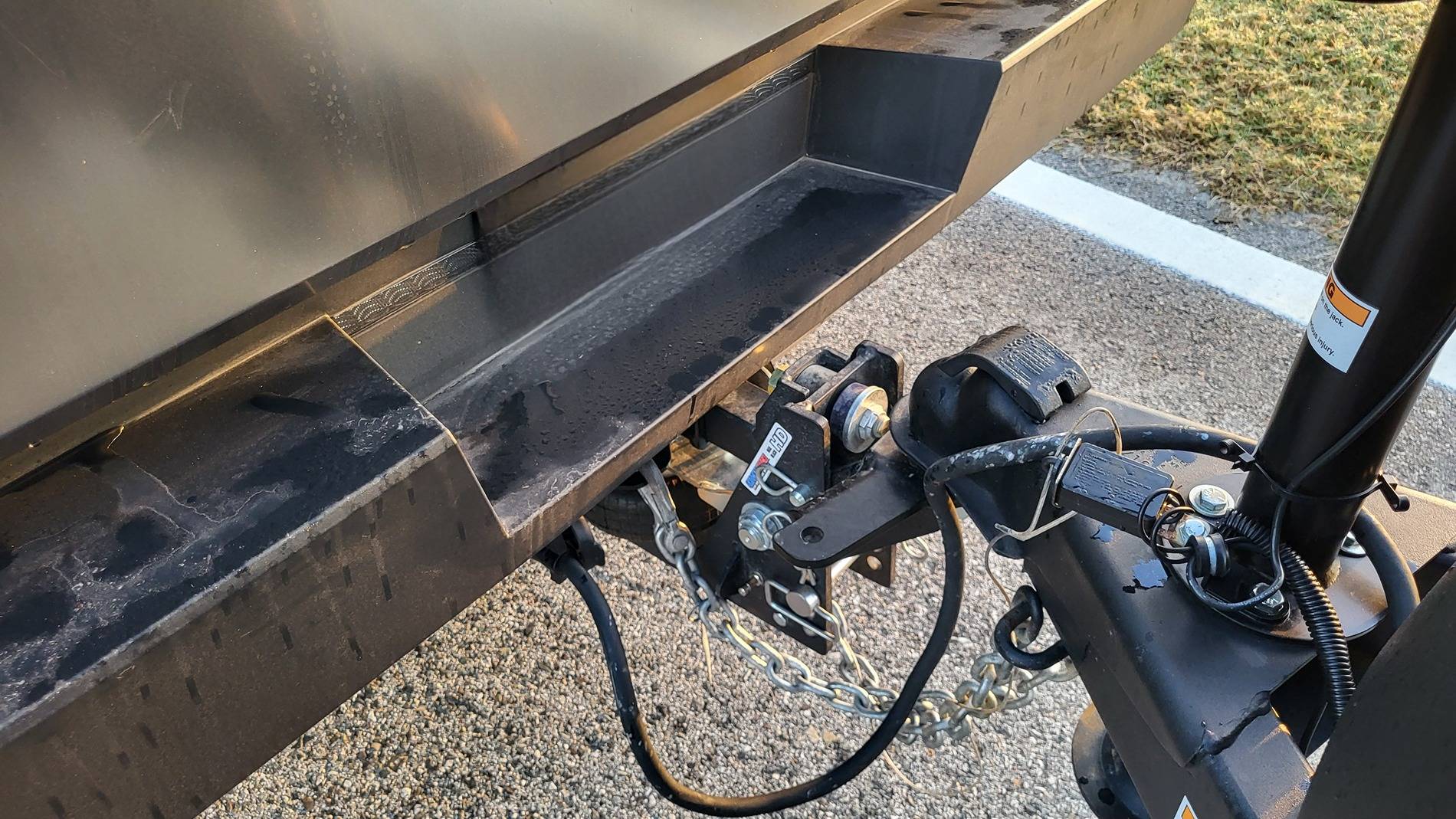

The shocker hitch is great. I have used it for a few years starting with my model X. It is a completely different experience towing, and you don't feel anything behind you. No jolts, bumps, jerks when the trailer goes over road imperfections. I find it also improves stability when road conditions are slick or wet - tire grip can be used for actual traction instead of dampening out trailer jerks.
Folks that advocate against this simply haven't experienced the bliss of a normal ride while towing. You won't go back.
I got mine from ebay as a remanufactured unit from the same folks that make them. From what I could tell, it looked brand new and was just a few hundred cheaper. I guess they want a piece of the used market.
One upside is the ball is extended an inch or two, which for my trailer is enough for me to max out my steering and not clip the truck. One less thing to worry about.
Only downside is I had to cut out part of the lower valence. I leave it attached to the dust cover by the middle of the three twist locks. When I am not towing, it still fits and covers everything up just fine. Be advised the pedestrian warning speaker wire is in the path of where you cut, so you first want to reach in and ziptie it to the top of the bumper hitch thingy so its out of the way.
