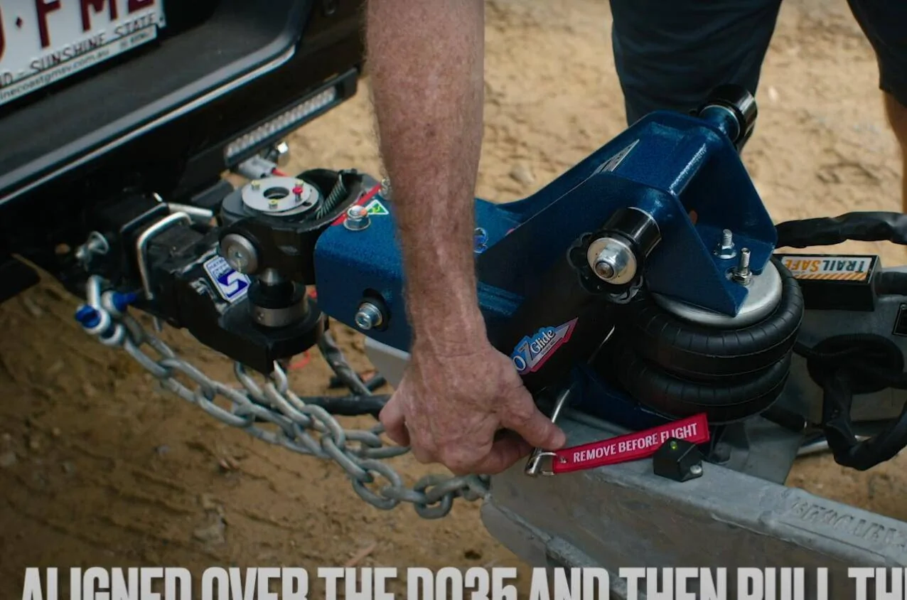

I had considered the Shocker Hitch, but now leaning towards this :
https://www.ozglide.com.au/
It attaches to the RV, so no need to handle a heavy hitch, but it connects directly to the trailer .. no good if you need it for more than one trailer. I will use it on a 3 ton trailer, I think it will work for me. Bit pricey.
