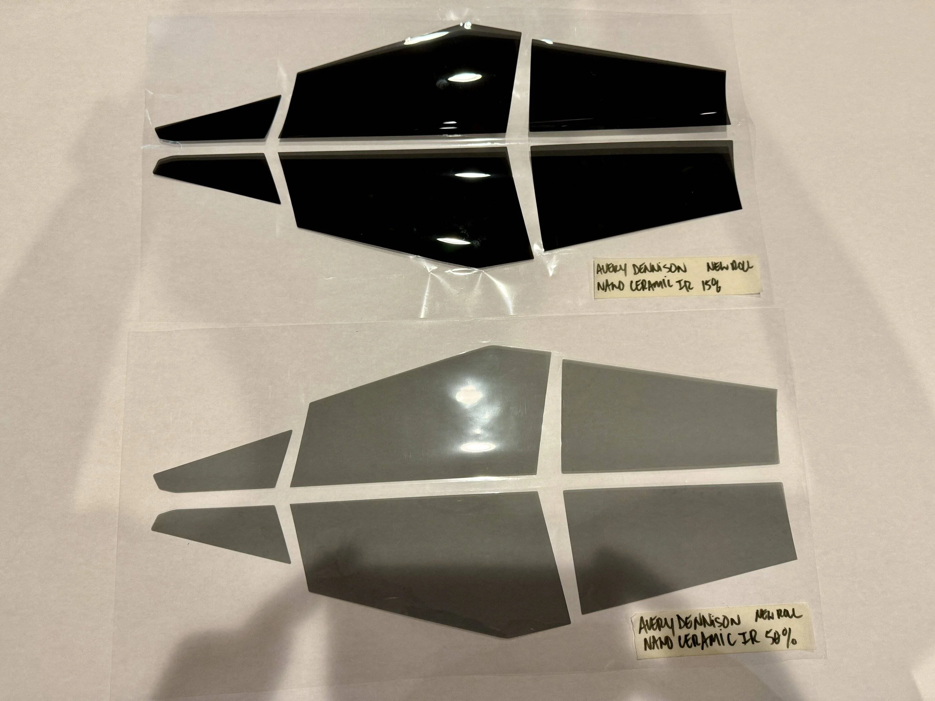

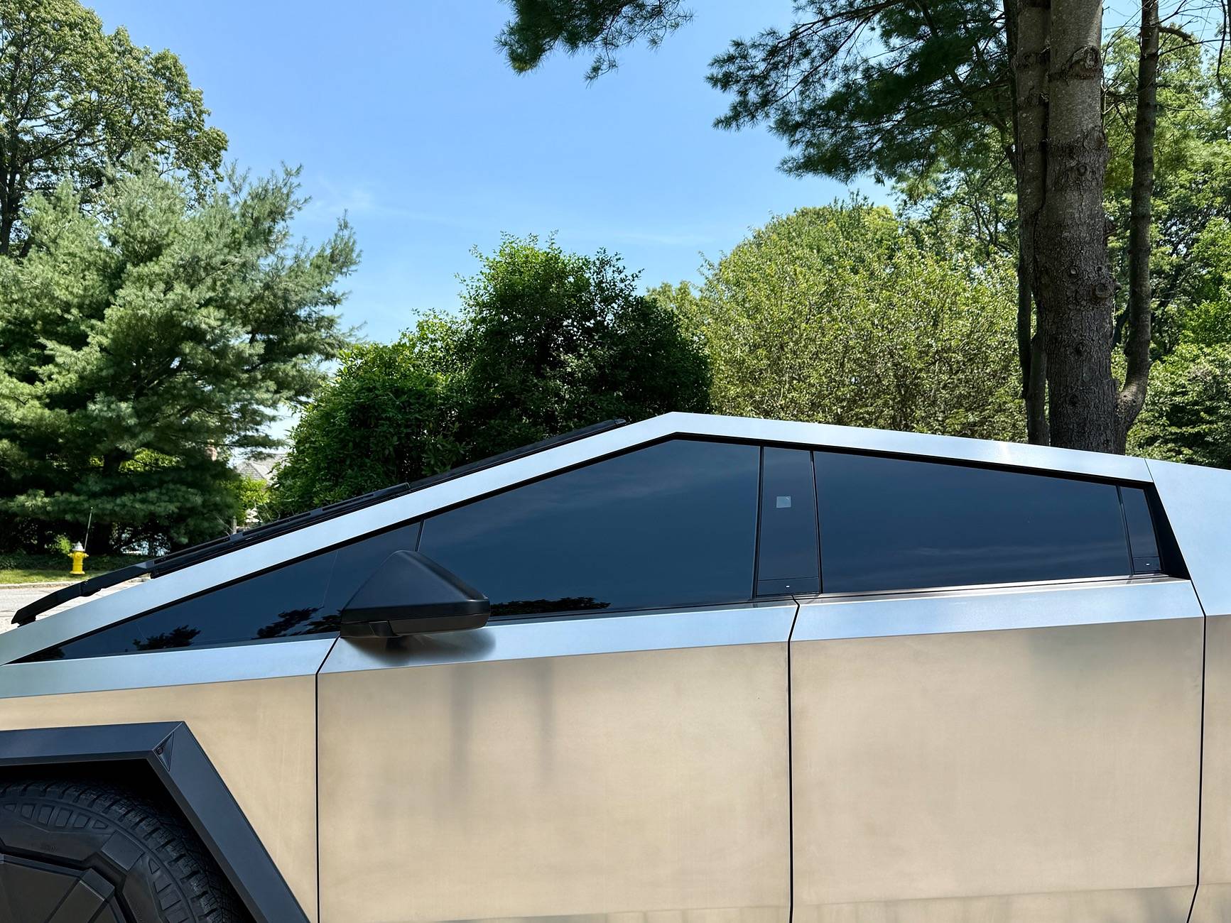

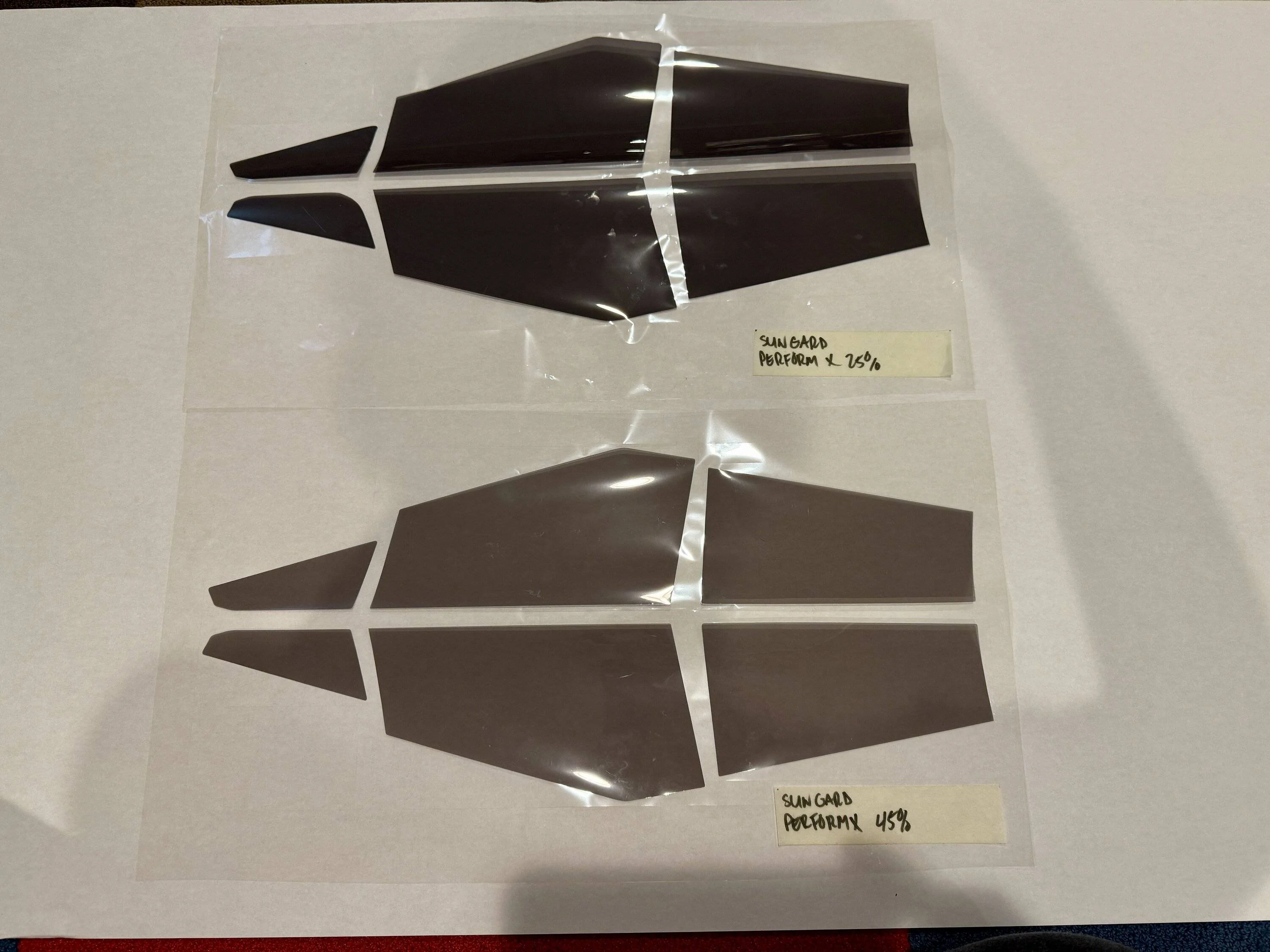

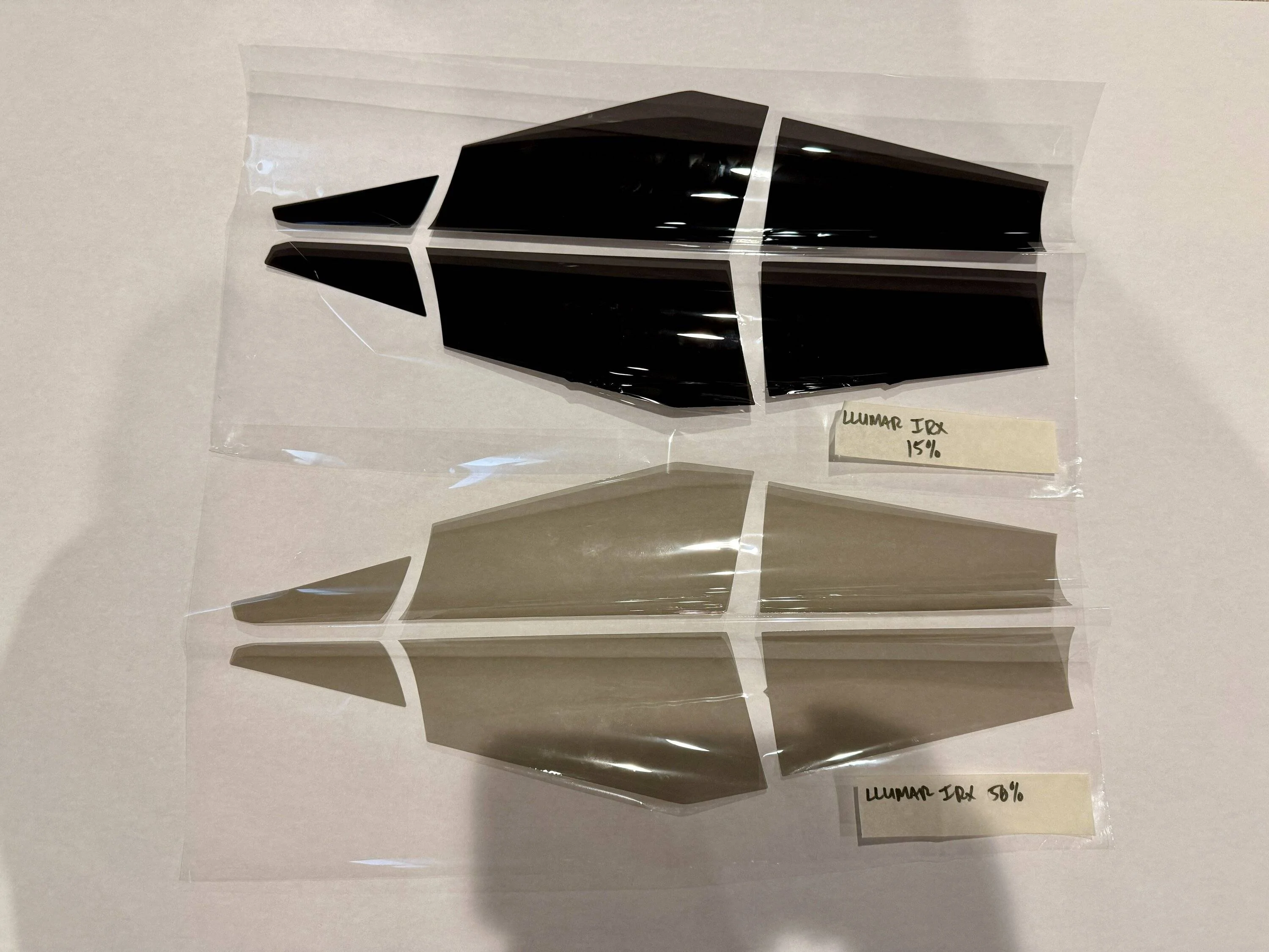

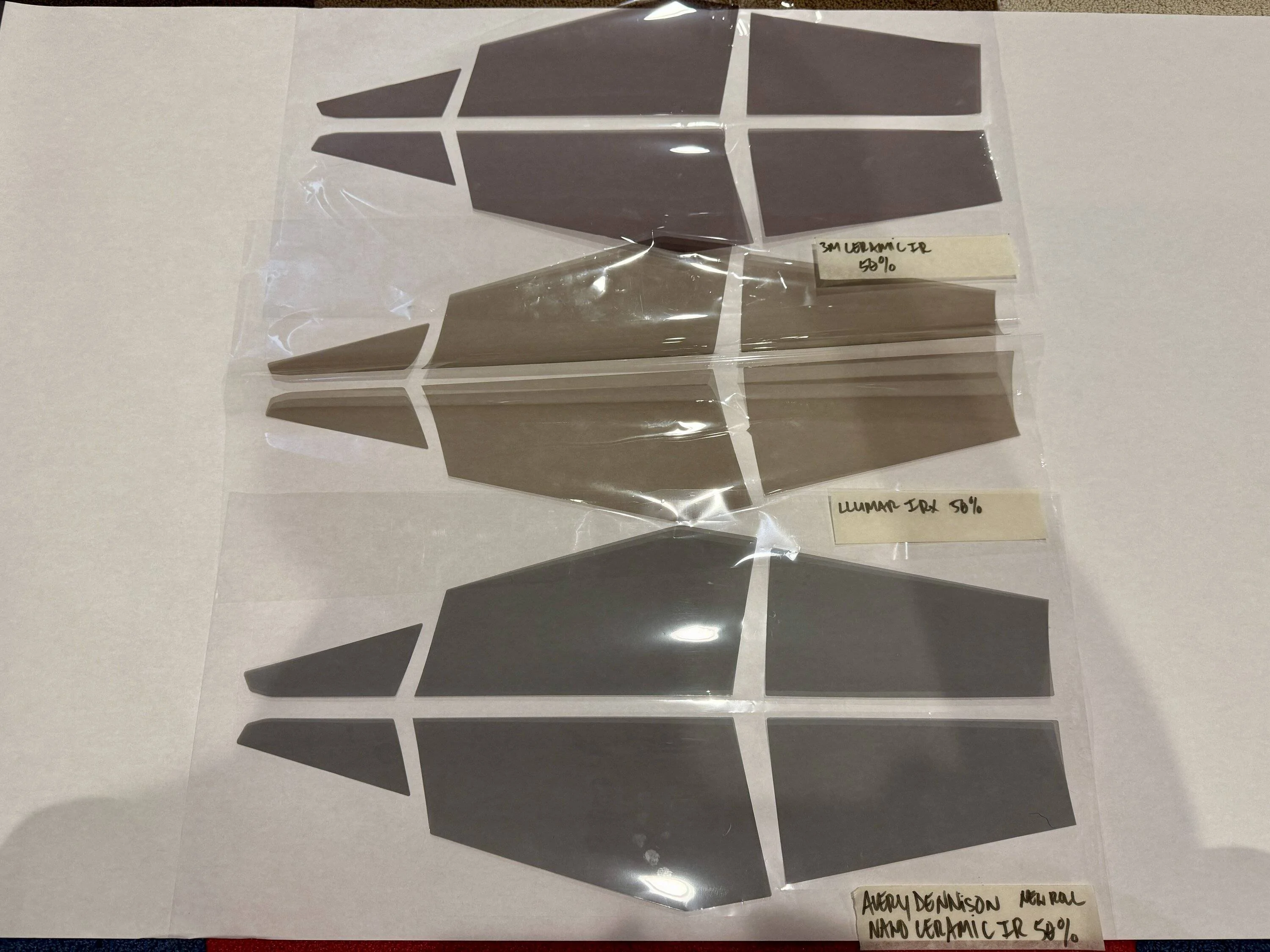

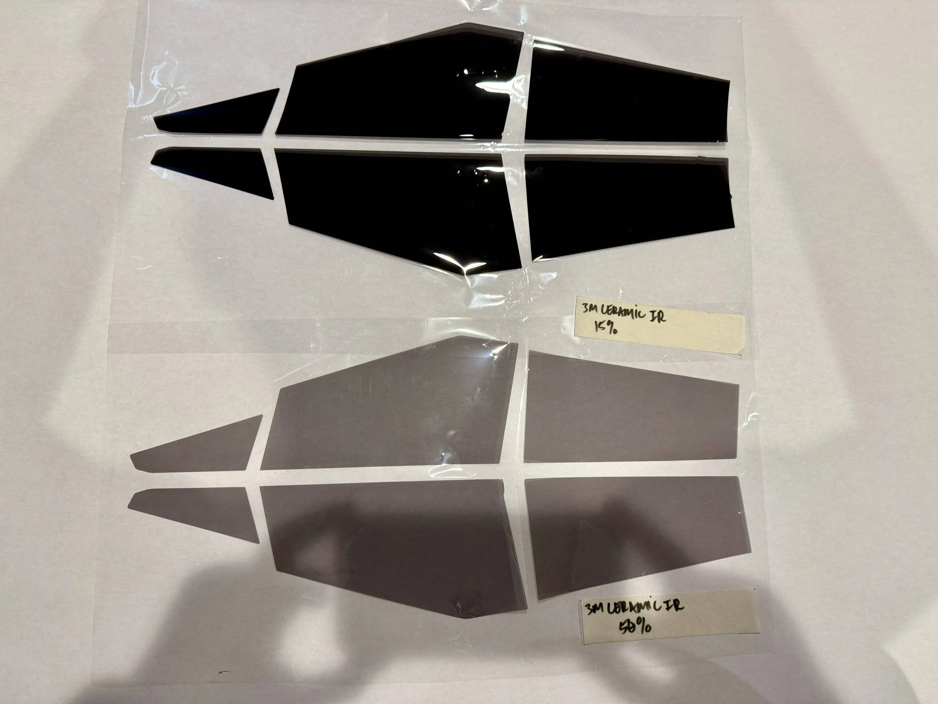

Ordered some sample tint film to compare. Went with Avery Dennison Nano Ceramic IR (20% front / 50% rear). Will change the front to 15% to match better w/ the rears as the front is a few % lighter than the rear.
The 50% tint color hues are very different from each vendor. Also, the Llumar IRX 50% metered close to 60% VLT, the other 50% metered closer to 50% VLT.

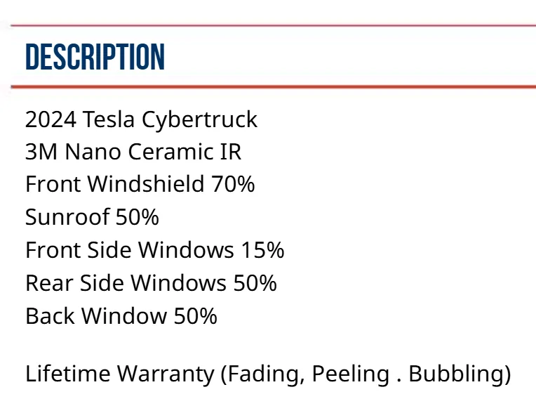

This is what I went with. I'm super happy with the look from the outside, and with the sides matching and dark, it makes looking in from the windshield difficult, even though it's only tinted with 70% darkness. The heat rejection is also very good.
Tesla Cybertruck Window Tint Samples 1749761317906-oy
If anyone is in Orange County, ask for Brian. https://octintsolutions.com/

Why add tint to the roof? Isn’t it already tinted? Would this be for heat rejection?

Exactly, extra heat rejection.
it was expensive to get it all tinted but should pay for itself over 80 years by keeping the truck cooler, which reduces the times Cabin Overheat Protection kicks on, that saves me precious energy so I can save a buck or two a day.
