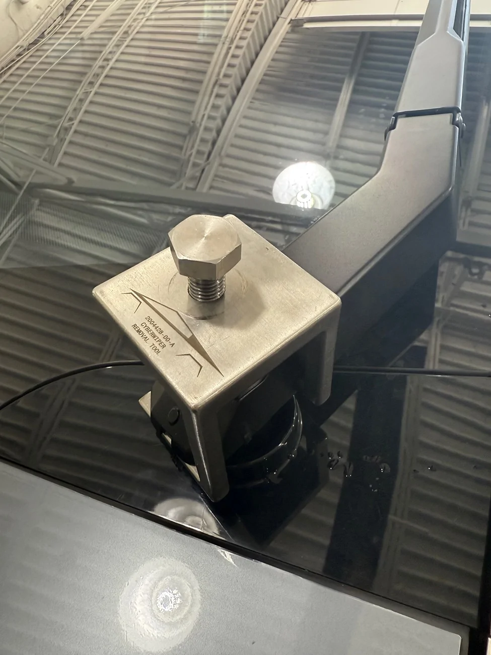

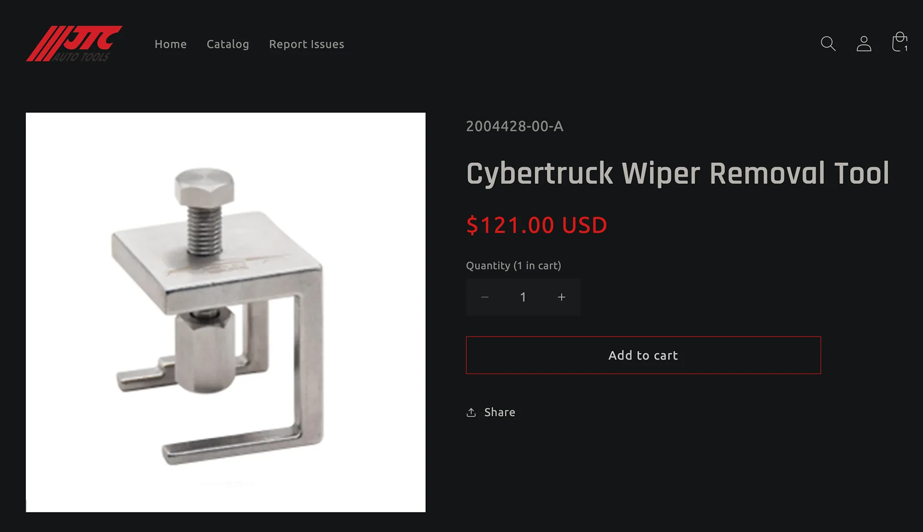

You can buy one here (I'm not affiliated with this company in any way) but it's pricey for what it is.
Tesla Cybertruck Wiper Arm Removal 1754319828288-v9
