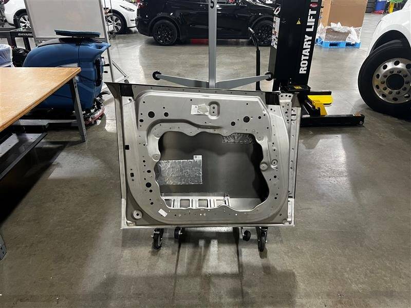

The removal continues! This time, we looked into removing the door panel. In all honesty, I was working on the mirror plate cover and I dropped the piece inside the door panel so I was forced to remove it. But there's always a "steel" lining.
The panel is actually in two pieces. Multiple clips remove the top, but it's aggressive. I recommend using an air pump to release the clips. Once you remove the top panel, there are three 8mm to remove. There are two connectors which are most likely the lights. Once you remove the top panel and bolts, you use the air pump to release all the clips (there's a lot). Comparatively, it's much harder than any other models I've removed. You'll reveal the speaker, window regulator, controller, and sensors. Be careful! The inner steel is insanely sharp. Put my hand right in there and sliced my hand like butter. The plastic plate is held by 8mm all around the perimeter. Behind is the window regulator bracket.
I plan on removing the rest of the car and doing a video series at some point. We typically do removals when we first receive the car out of curiosity. Let me know if you have any questions!

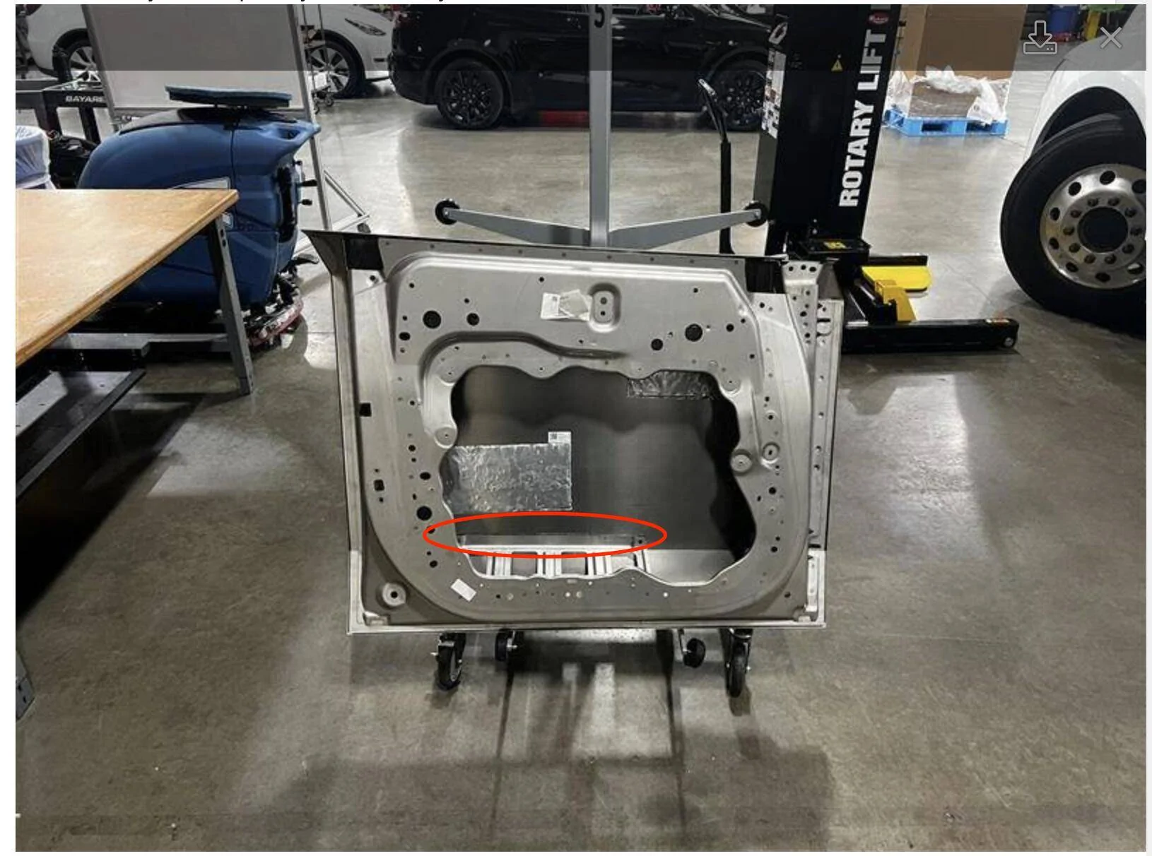

Well, you inspired me and so long as one is careful, getting the door panels off isn't all that hard. Unfortunately the rattle I had in the door was behind the large plastic panel and I had to take the window glass out in order to get that panel out of the way.
It was getting dark and my wife was getting impatient providing a second set of hands so I didn't get any pictures, but if anyone else comes across this thread due to a rattle when you shut the door, the issue I had is there is a brace that looks to be adhered to the exterior door panel with some kind of glue and that glue had failed. I ended up putting some felt tape on the inside of the door skin where the bracket met the exterior door skin/panel and that seems to have resolved it. I'll keep my service appointment and let Tesla look at it if they want to, but at least the door doesn't sound like it's falling apart when I shut it now.
I know my adhesive on the panel has failed as well. Can you point out on this photo where you put the felt tape?

Yep, the circled part is what you're hearing rattle if it's the same issue I had. Unless things have changed, there was a strip of butyl tape put between that bracket and the outer door skin, but it had failed. If you have butyl tape, you can replace it so the bracket is adhered to the outer door skin. I only had felt tape on me, so I put that in just to get it to be quiet until I was able to get in for service to fix it properly.
Just be careful with that door interior. Lots of sharp edges and it's a bit of a bear to get into.
