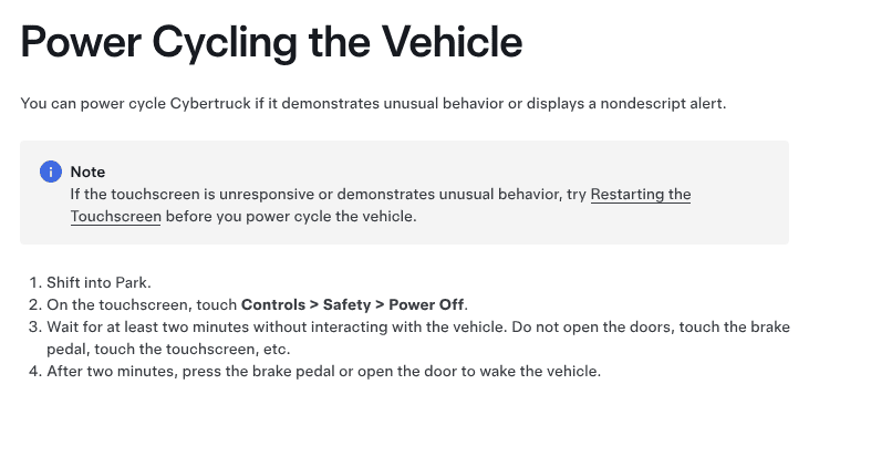

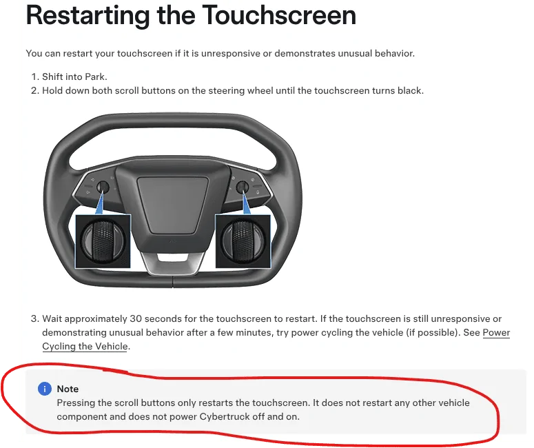

Pressing the 2 scroll wheels will do a screen reboot. Make sure you power cycle the truck.
Tesla Cybertruck 100% Charged for 150 mi?? (UPDATED) 1721145441913-ok
Tesla Cybertruck 100% Charged for 150 mi?? (UPDATED) 1721145375579-55
