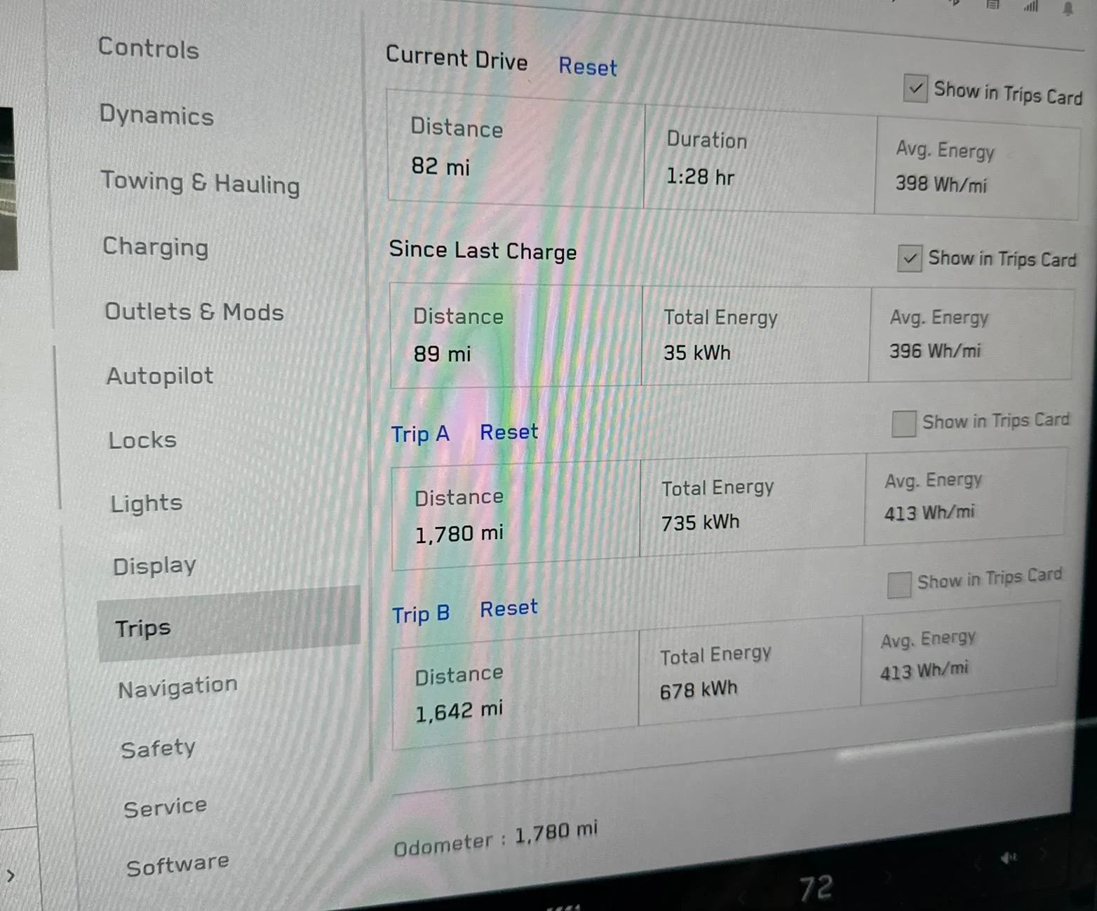

What does the consumption screen says about the recent drive?
So the last trip was 2 miles only. Avg energy is 651wh/mi. And I have no idea what that is.
Initial mile will always show high consumption. Drive for few more miles like 5-10 just to make sure. Your overall usage is pretty reasonable. Did you check the tire pressure?
PS: I noticed you drove 4-5 miles to Whole Foods.
