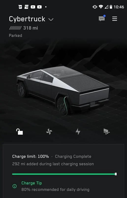

The first time I charged to 80% I got 234 miles, which corresponds to 293 miles. This worried me since it was supposed to be 318 miles with the AT tires. The second charge was 240 miles, then it got up to 245. I then charged to 100% and got 307 to see what was happening. Charged again to 100% for a road trip and got 311 miles for the range. I then got back with well under 10% for my road trip and decided to charge to 100% to see how the range would be with a full Tesla recommended "calibration." Below is what my truck charged to this morning after 1255 miles.
Tesla Cybertruck Don't worry about lower ranges your first few charging cycles! Estimated range will increase 53554213948_e106ee7125_c

That’s really interesting. Makes sense that there would be a larger calibration period.
what type of driver are you, cautious, aggressive, hyper Miler, average?

Thanks for experimenting and sharing your findings. It’ll be nice to know when the math ain’t mathing just to give it more time, miles and charging cycles.

this number is the rated range and has nothing to do with what type of style the driver is, it uses a fixed efficiency number like all other teslas do. the estimated range in the energy app will vary based on driving style.
the BMS just needs to learn what the capacity of the pack is by charging and discharging cycles. and its

I actually just replied to one of your older responses on a diff post. Glad to see you got the 318 miles at 100% as well!
