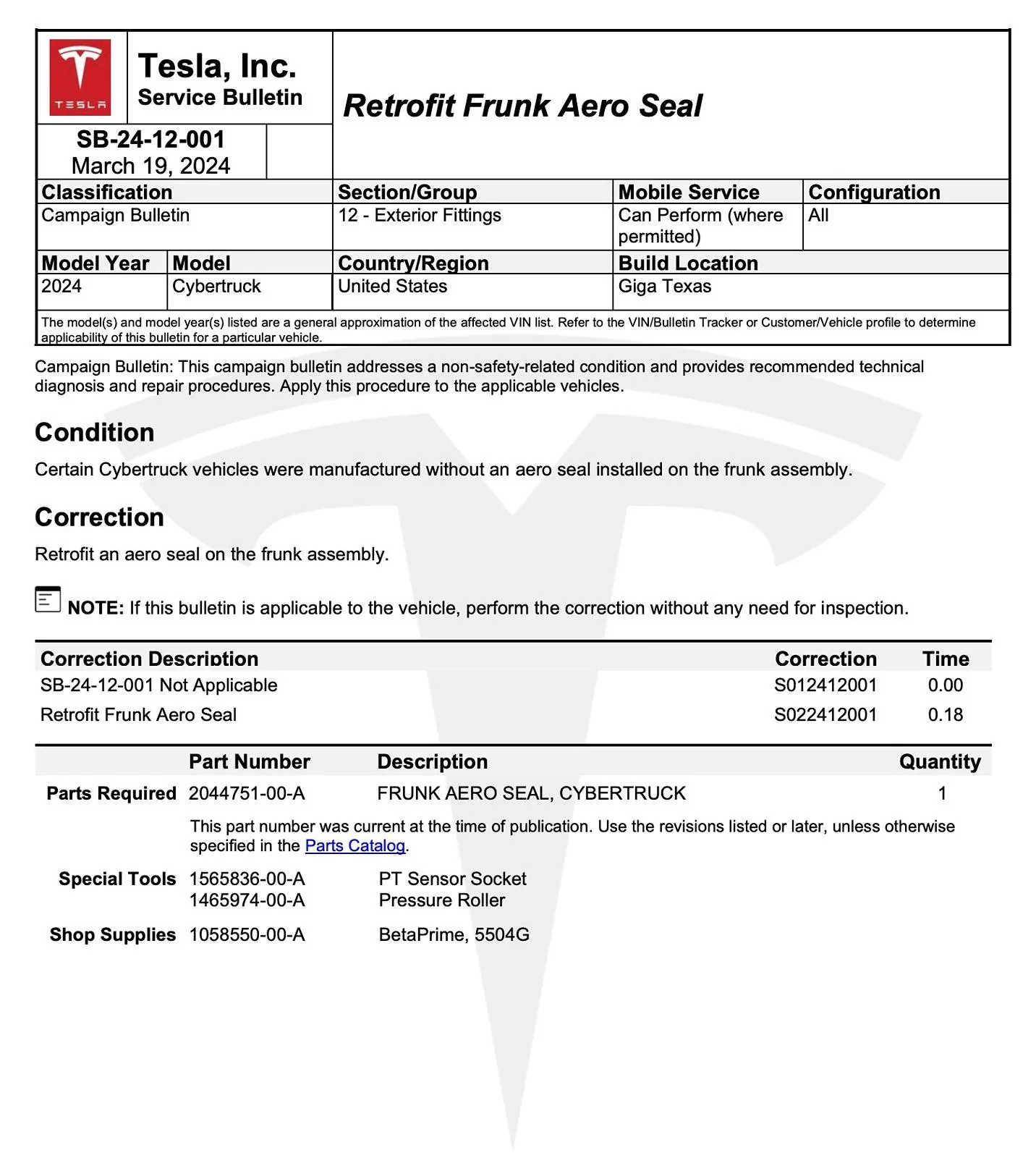

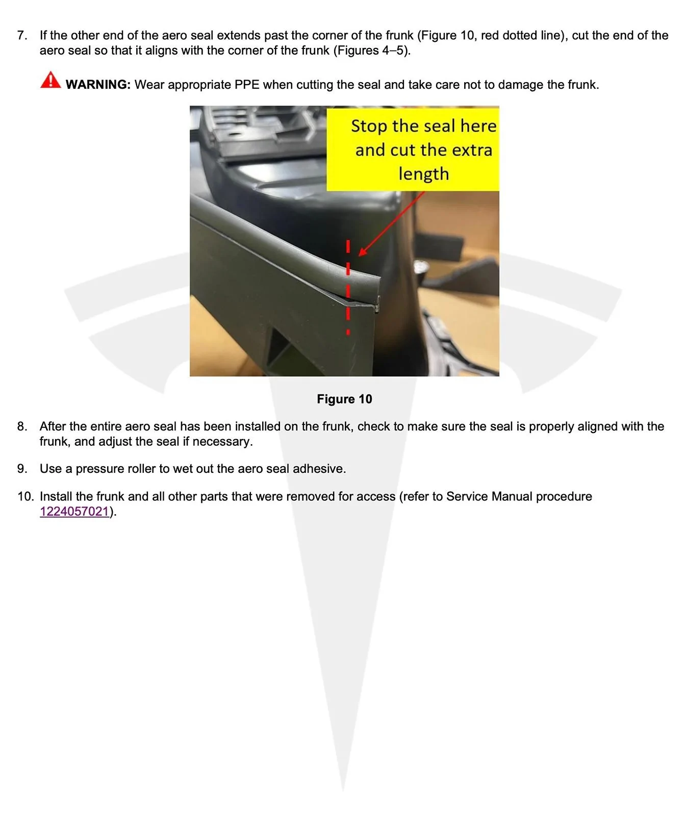

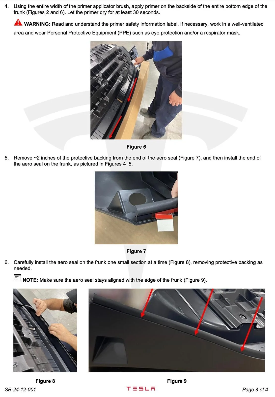

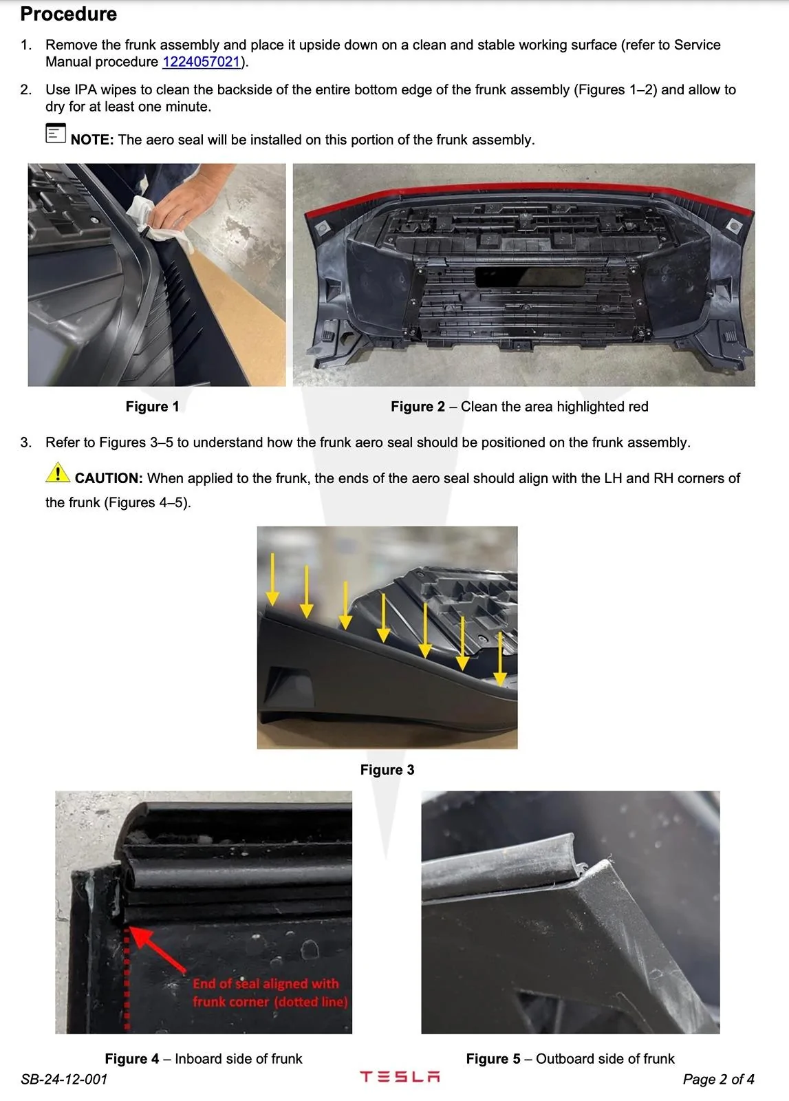

Can someone post of a picture of this on their truck? I am having a hard time figuring out where those parts on the TSB are on the truck...

I was told this retrofit is not applicable for my VIN (2600+) during a service call today.
Speedr
Dec 17, 2023
665
1,403
Dual Motor Cybertruck
So are you saying this was only an issue with the first few thousand produced, and it's already been updated?

They ended up replacing my entire frunk enclosure, some notable differences is the metal on the top is only flared on the front edge, and the seal mounts appear to be further from the left and right sides. Road noise is noticeably better.

@eousphoros, what are you referring to when you say frunk enclosure? The outside too (i.e. hood)? Did you take any pictures of the before/after? Thanks!

Yeh the hood got replaced too which was sort of annoying since I had polished the old one too perfection and the new one has a crap finish on it. I also preferred the old flaring but you win some and you lose some. I’ll dig up some photos when I get home
