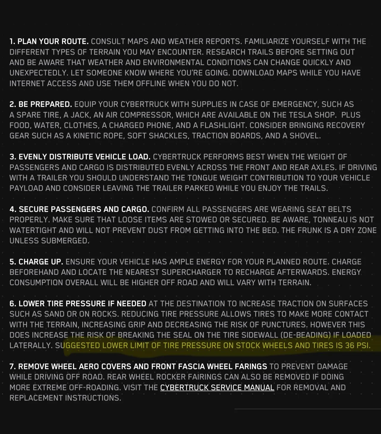

Driver probably didn’t air down, but it does call to question this cyber truck has a beach truck with the stock set up. Assuming he also had no recovery gear like traction boards, a shovel, a jack, kinetic rope, or anything like that.
Still… the off-road guide Tesla put out the other day suggests airing tires down to a minimum of 36 psi from the 50 recommended for Street use (or risk the tires coming off the wheel). This is for the goodhear
It’s pretty typical for beach drivers to air down to 15 to 20 psi normally.
it’s possible to cyber truck stock all-terrain tires just aren’t very good beach tires, at least on soft sand at slow speeds.
for those looking at this use case, you may want to end up replacing the tires. That means, it may make more sense to wait until the non-foundation as you are paying an up charge for those tires anyway.
It's not Tesla or Cybertruck, it's an EV that wants the different tire configuration.
Range in an EV is highly dependent on a low rolling resistance. The classic radial tire that just deflates like a blob of silly putty is the antithesis of a good EV tire. It's actually not that great for ICE either.
The good EV tire is going to be stiff to reduce rolling resistance. That then becomes a trade-off with ride. Stiff tires make bumpy rides.
As you deflate the EV tires with stiff sidewalls, you'll see that the don't just look like they are melting, the sidewalls stay stiff. Too much air out increases the probability that you will loosen the bead and, well get to 0 psi!
And then there is the situation that EVs are a little heavier.
Is the Cybertruck with the Foundation Series All-Terrain tires the best for soft sand beaches? Of course not. But there are some options and will be more to make it better.
And of course, no vehicle is immune to driver inexperience.
