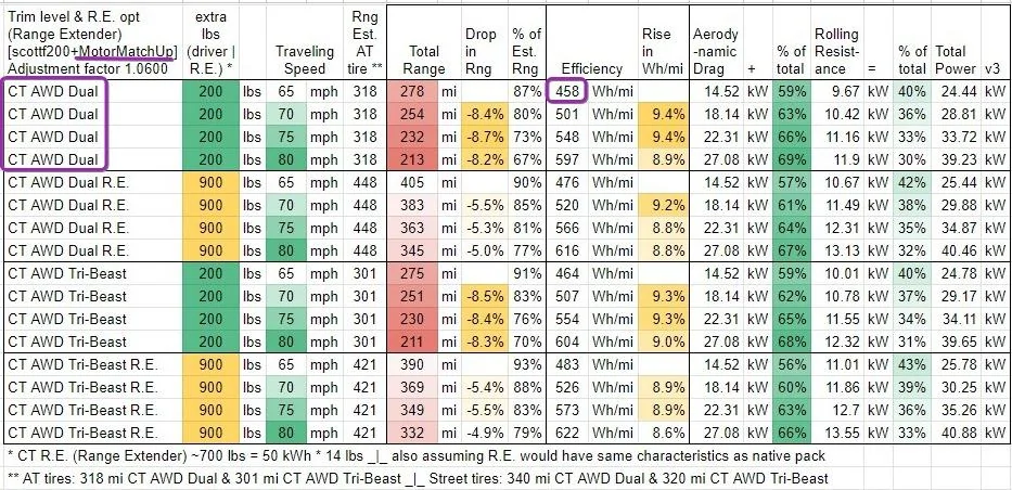

I was doing a *bunch* of testing with CT AWD Dual with and without the Range Extender. The charging results (start & end SOCs) didn't make any sense to me.

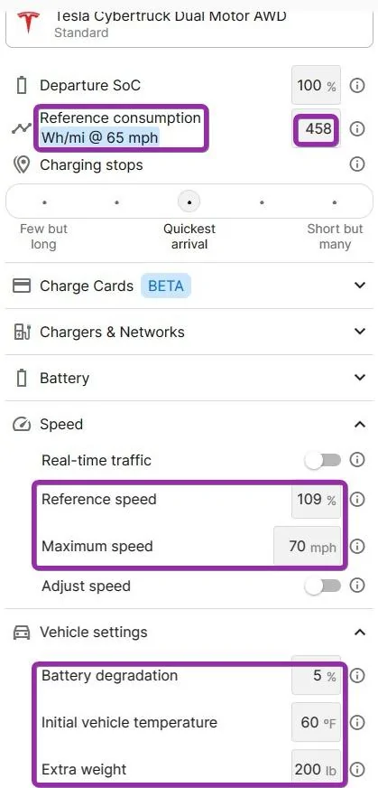

ASIDE: options I like to start with for my own planning

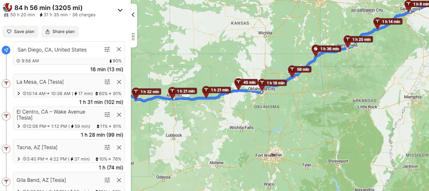

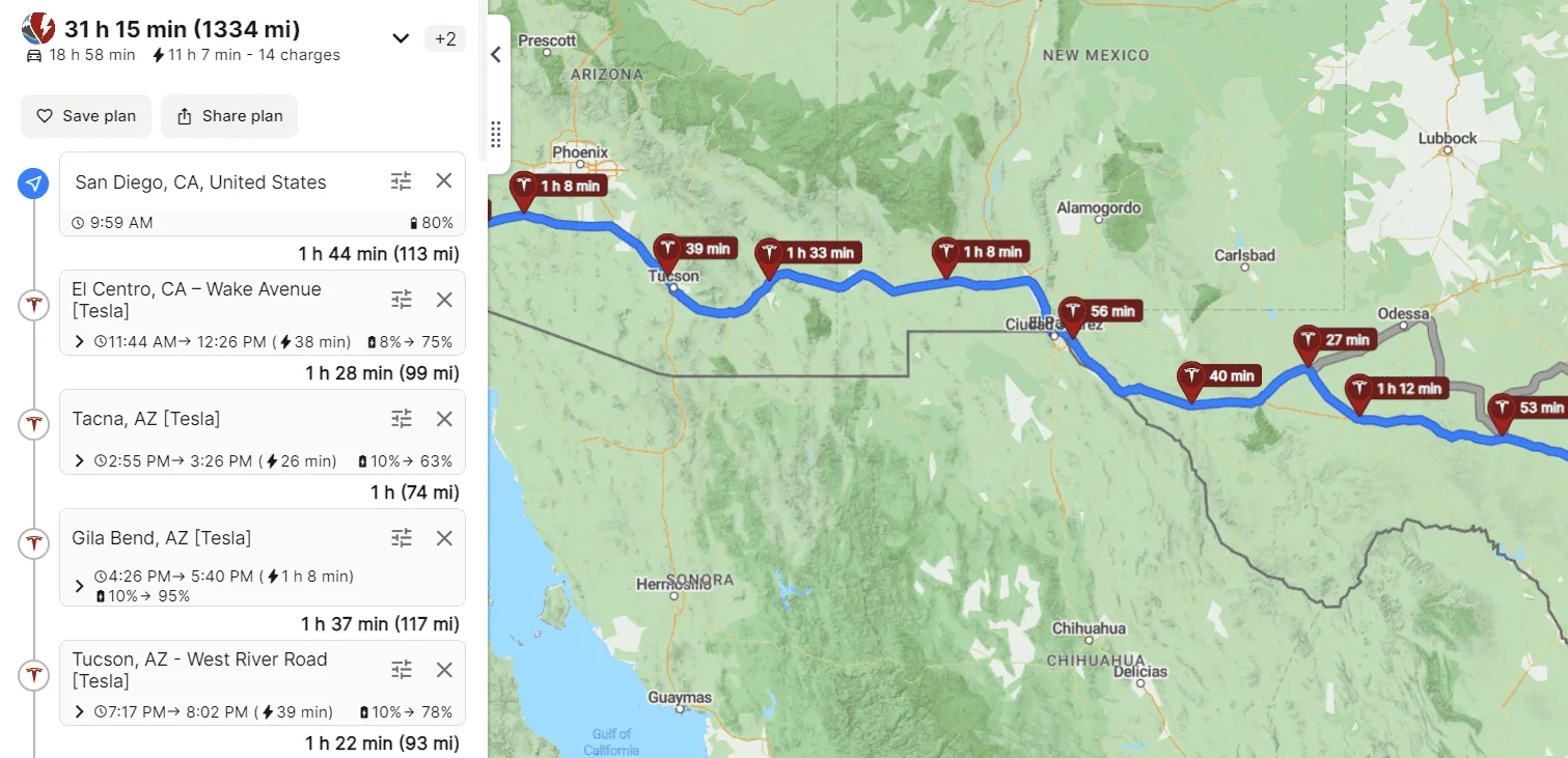

Ah nice, was getting some "unable to complete route" errors on there.
Working much better now, especially for longer routes, over 600 miles.

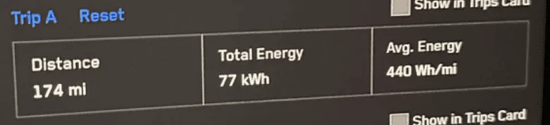

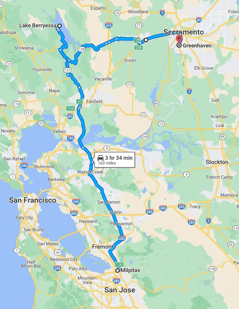

Trip A:
From south bay to Lake Berryessa to Sacramento. Stopped by the supercharger at Davis for some battery juice. 70% highway, 30% county roads with some twisties. 440 Wh/mi.

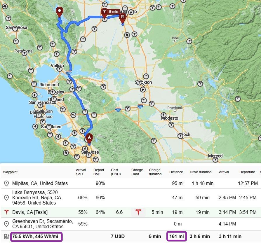

@susu2142 - nice job and thanks for taking the time to share.
@Anyone - I did a rough simulation of that using the updated ABRP (other thread) just throwing in the names from the map and the stop at Davis for a few minutes. I came pretty close with ABRP to his Wh/mi.
Distance: Him-174; Me-161
Wh/mi: Him-440; Me-445

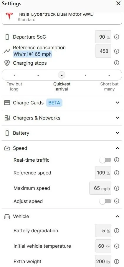

Options I used - in case someone wants to duplicate and play with their own options.
FYI, I used 65 mph related to "70% highway, 30% county roads" *** ~71MPH (65 * 109%)
FYI, I set my current Tesla to 9% over in the settings for relative speed to the speed limit signs.

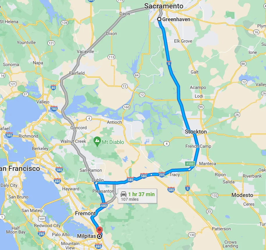

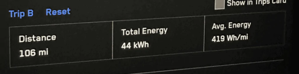

Trip B:
Sacramento back to the bay area on I5/I580. All highway, tried to keep the speed around 75-80mph, but got caught in some light traffic. 419 Wh/mi.

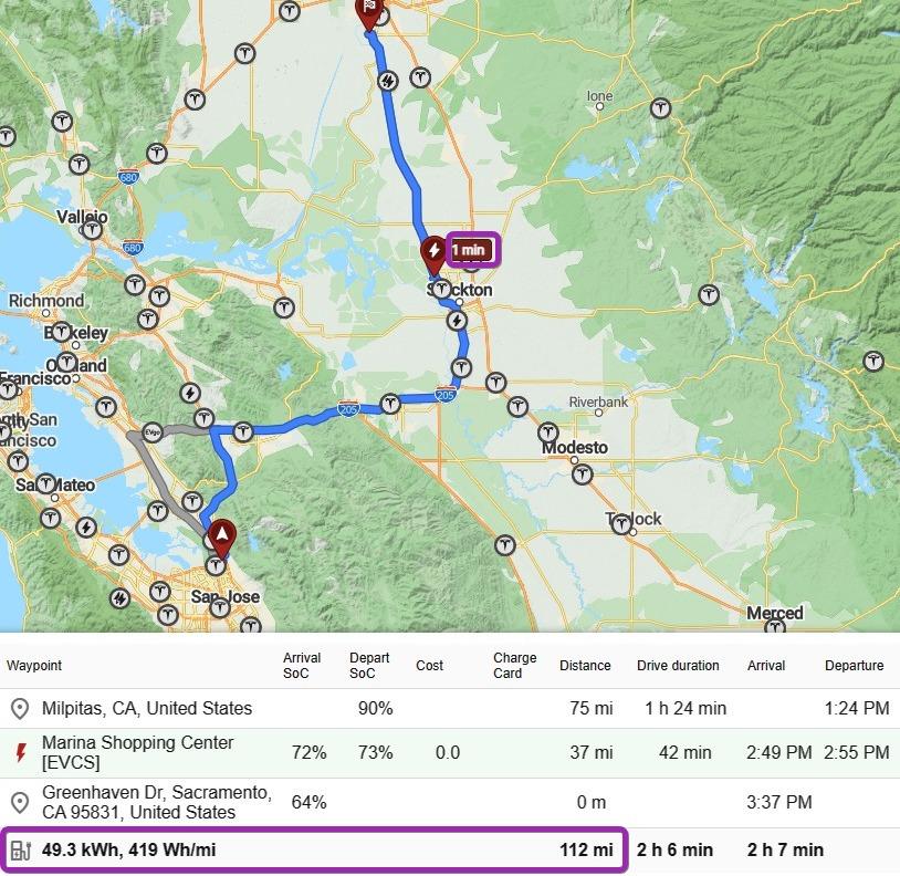

@susu2142 - nice job and again thanks for taking the time to share.
@Anyone - I did a rough simulation of that using the updated ABRP (other thread) just throwing in the names from the map and the stop at Stockton for a minute as it triggers distance stats in the table. I came pretty close with ABRP to his Wh/mi.
Distance: Him-106; Me-112
Wh/mi: Him-419; Me-419

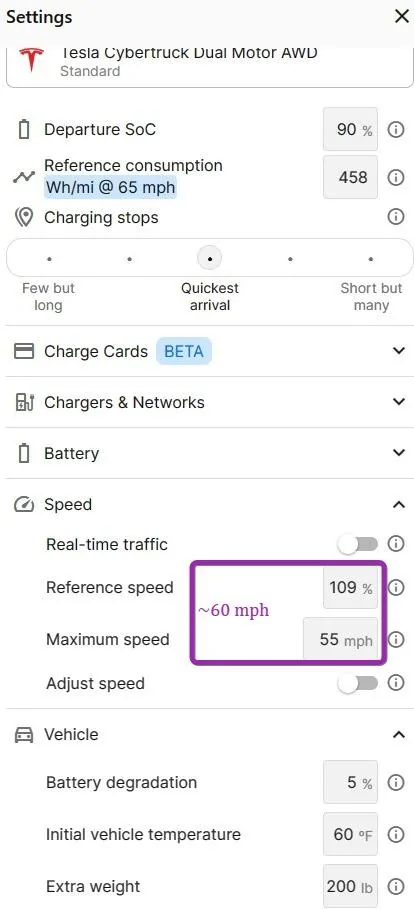

Re: tried to keep the speed around 75-80mph, but got caught in some light traffic
I could only get ~419 by going a speed of ~60 (55 mph * 109%).
