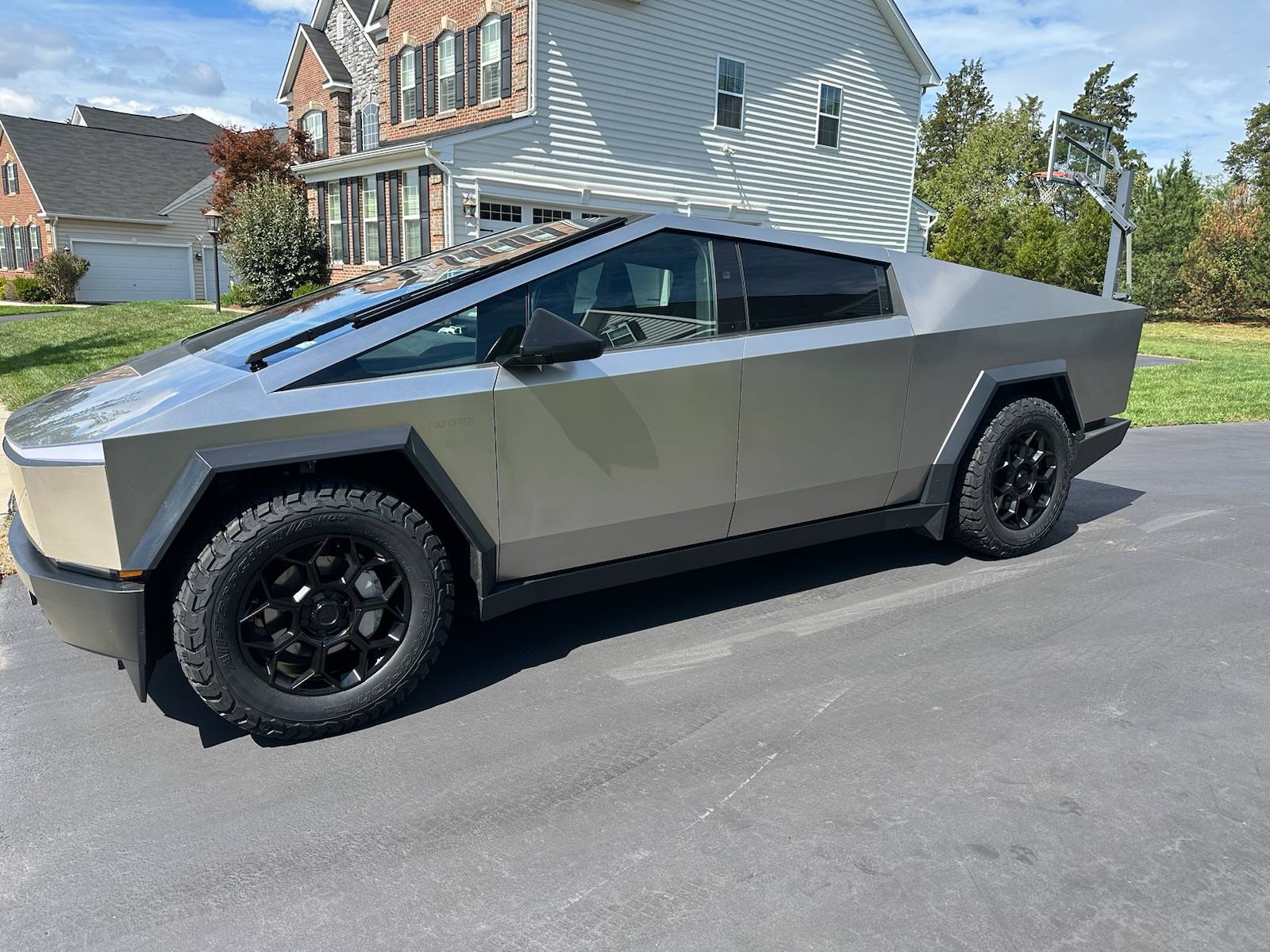

Your tires and wheels look great, I would like to know how 285/65R20 Nitto ridge grapplers on stock wheels would change efficiency that is what I am thinking of doing, I have had them on several vehicles including my Bronco and they are quiet very good looking and great performing tires.

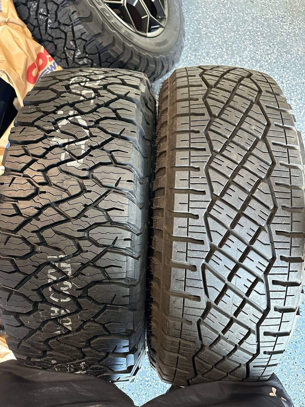

Today I installed a set of four wheels and tires from Tsportline, and this post summarizes an efficiency comparison I just performed vs. the stock wheels and tires.
What I Bought
  • Tsportline 20" Fully Forged Lightweight Wheels (31.8 pounds)
  • BF Goodrich KO3 Tires (285/65/R20) [note: stock tires are 285/60/R20]
https://tsportline.com/collections/...tweight-tesla-wheel-and-tire-package-set-of-4

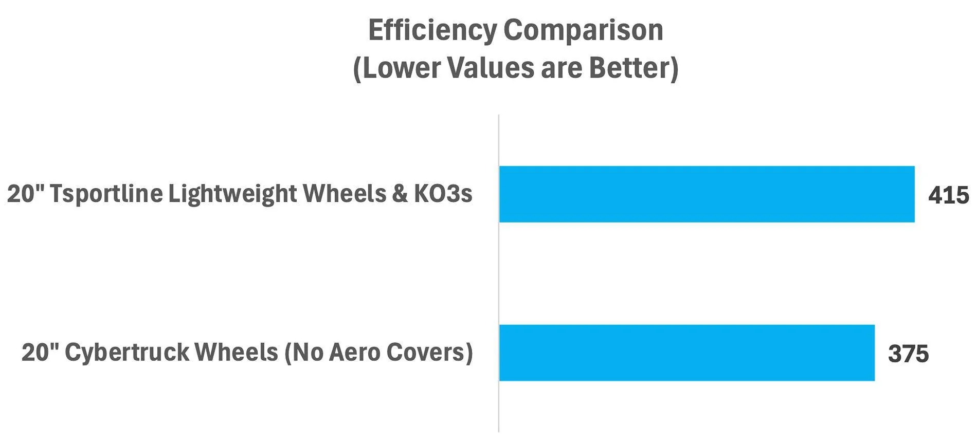

The Efficiency Test I Performed
  • I drove 36 highway miles from Leesburg, VA to Blumont, VA and back at approximately 65 mph.
  • I first did this route with the stock wheels and tires that came with my Cyberbeast and no aero covers, and then I repeated it with the new wheels/tires.
The Results
  • The new wheels/tires (415 wh/mi) are less efficient by 11% relative to the wheels/tires that come with the Cybertruck (375 wh/mi).

The stock tires from Tesla are 285/60/R20 vs 285/65/R20 for the ones installed.
Therefore, the with lf the tires is the same, bur the new ones have a bigger sidewall.
Also, the stock tires are load range D, whereas the new ones can handle more weight as load range E.
https://www.tesla.com/ownersmanual/cybertruck/en_us/GUID-9284C9F2-A2F2-4604-83BF-6599F47766B7.html
Did a big write-up just to see the post right after mine stating that the OEM tire is 285/65/R20, NOT 285/60/R20. So the old and new tires are the same sizes (spec wise anyways).

The OEM stock tire is 285/65R20
I wonder how much is the tire and how much is the wheel.
Both 20" wheels and neither of them have an aero design so pretty much negligible.
The OP says is 11% less efficient, I ask could be tire vs. wheel, and you say there's no difference. So why don't you just respond / tell the OP that he is wrong, because you looked at the tires and said they have the same stats so no difference...
