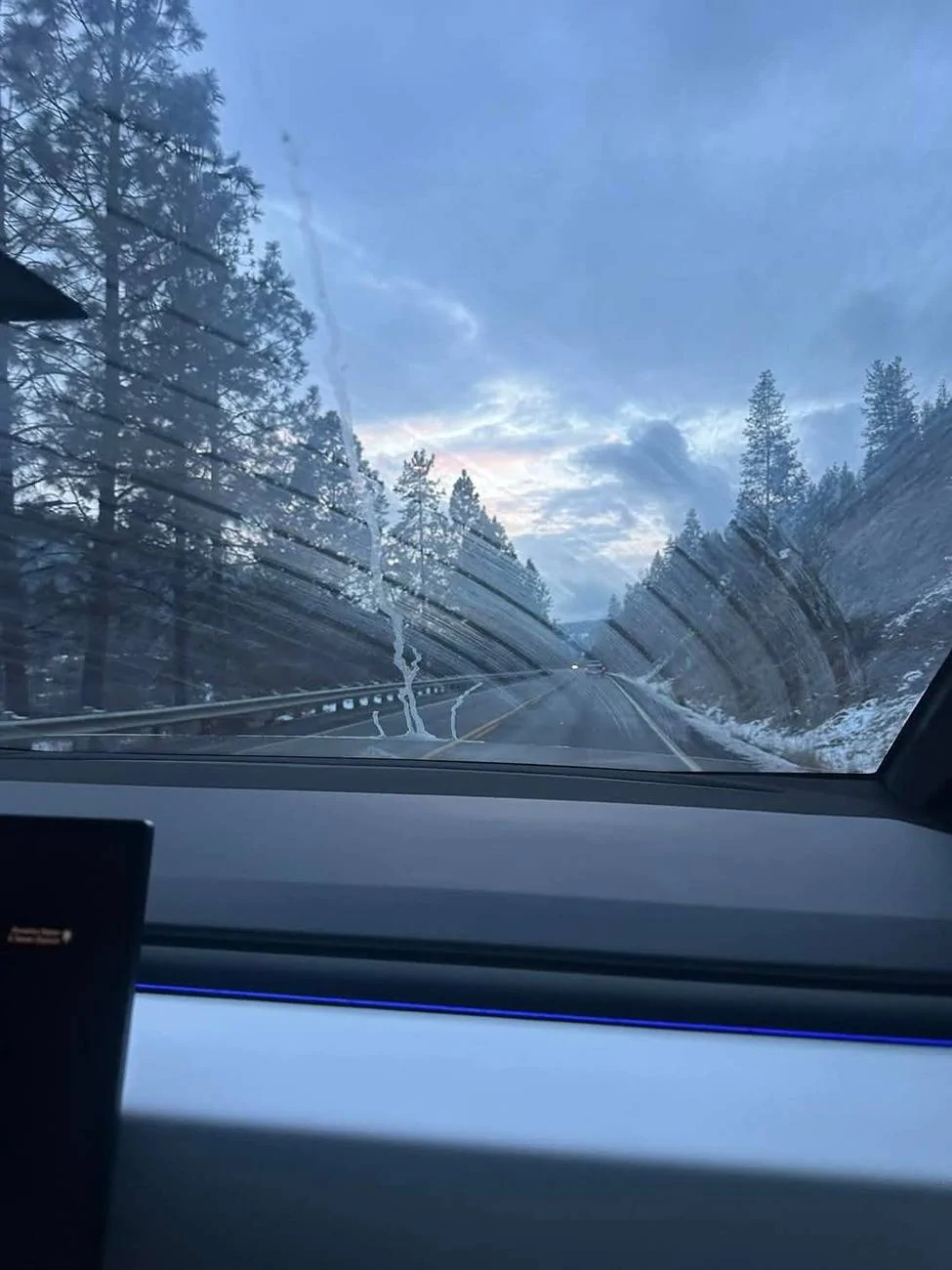

Do you have any pictures of what your old wiper was doing to windshield? I got a "revised" blade too but it was no better.... I wonder if some people are complaining about the new blade... Can you show a picture of your old windshield streaks? Please :)
I checked, and I do not have any pictures of what it was doing, but it was smearing like crazy and hardly any fluid was coming out at all. Had to go to the car wash daily to clean the windshield or manually do it myself.
Did it look like this? This is the way mine looks before and after "revised" arm
Yes exactly and I have the new arm also. If washer dispensing fluid issue did not resolve itself with the new wiper blade. I was going to run warm water with a little bit of vinegar in it along with running compressed air through that also at the end.
You can disconnect one of the connection points for the hose line to do that which should help. You could have something clogged or build up in there. SC said the holes in the old wiper blade were too small and not dispensing fluid properly. Hence the new part number.

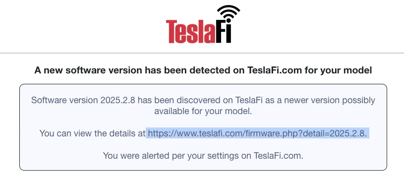

It was confirmed in this video right at the beginning(first minute of this video) last night. This video shows Chuck Cook downloading it in his truck and showed the wiper fluid updated feature:
I stand corrected.
Clearly Not a Tesla App got the notes wrong.
