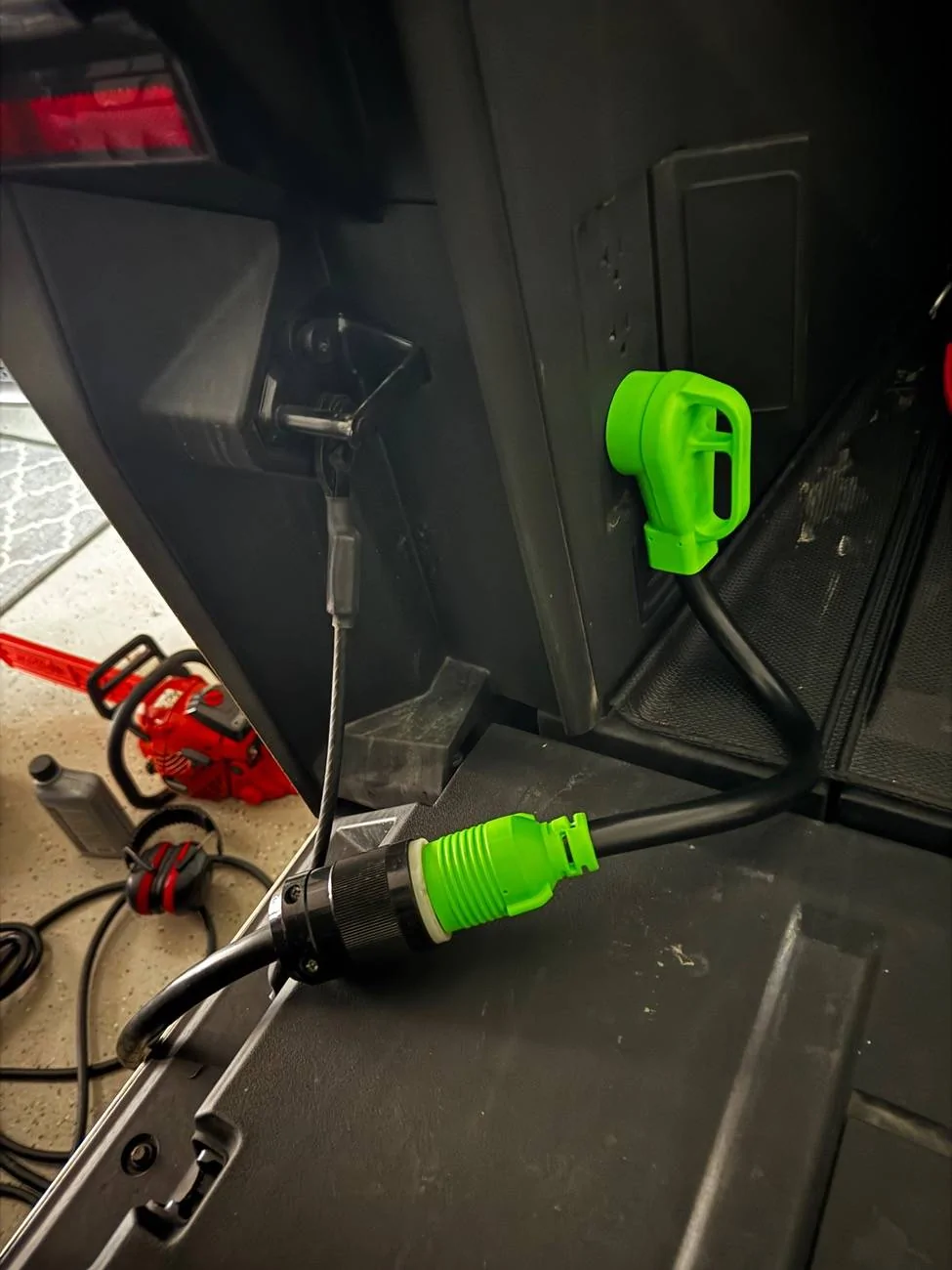

NEMA 14-50 to L14-30 cable

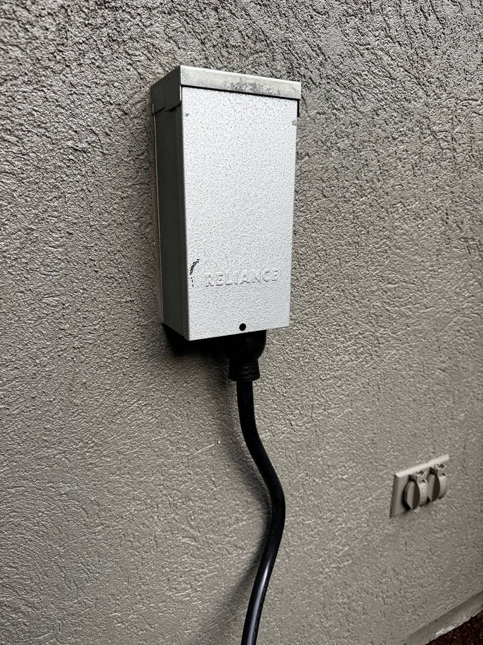

L14-30 receptacle

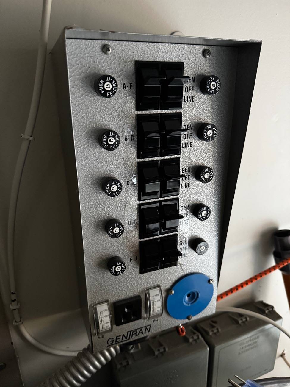

10 circuit 30A transfer switch

Spread the word you don’t necessarily need the PowerShare stuff. Just need a transfer switch and a cable!!! These things are awesome.

I would also like to include there are various styles of transfer switches. Newer ones that basically integrate to your panel so you don’t have to pre-determine your 10 circuits.

I have the same setup (generator inlet box and interlock switch) and live in the Seattle area. We just went through 5 days without power and the Cybertruck powered everything wonderfully. Even had enough power to run the washer and dryer. Given how it performed, I wouldn't recommend the Tesla Backup Gateway based on the electrical install cost. Install costs for an inlet box and interlock switch is much cheaper.

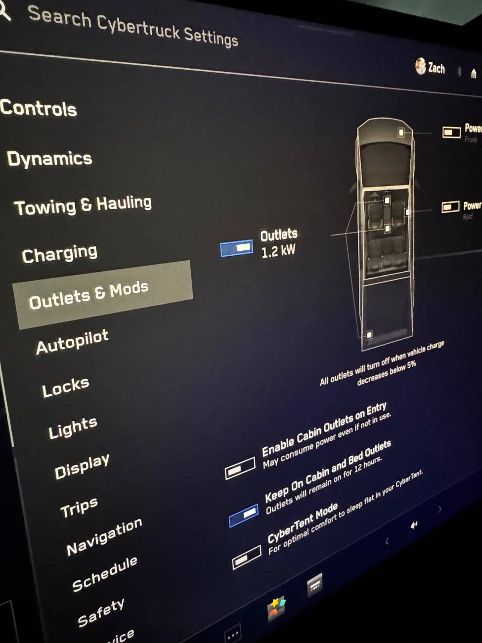

Does the truck require a manual restart every 12 hours for the 240v outlet? Does it need to "cool off" or it just continues uninterrupted?
Shadrack
May 23, 2024
Issaquah, WA
It requires a manual restart and it doesn't need to cool off. The power draw seems minimal compared to what driving it would be. When it's powering the home, the truck makes little to no noise.

Ah ok. Yeah, I ran my house using just the nema 14-50 outlet, hooked up to my 50A transfer switch + interlock kit, but only for a few hours at a time. I've since gotten the PowerShare gateway installed so I'm no longer capped at 12 hours, I was just always curious if it had no cooldown period, if the UI simply let you "extend" the time the inverter was on.
