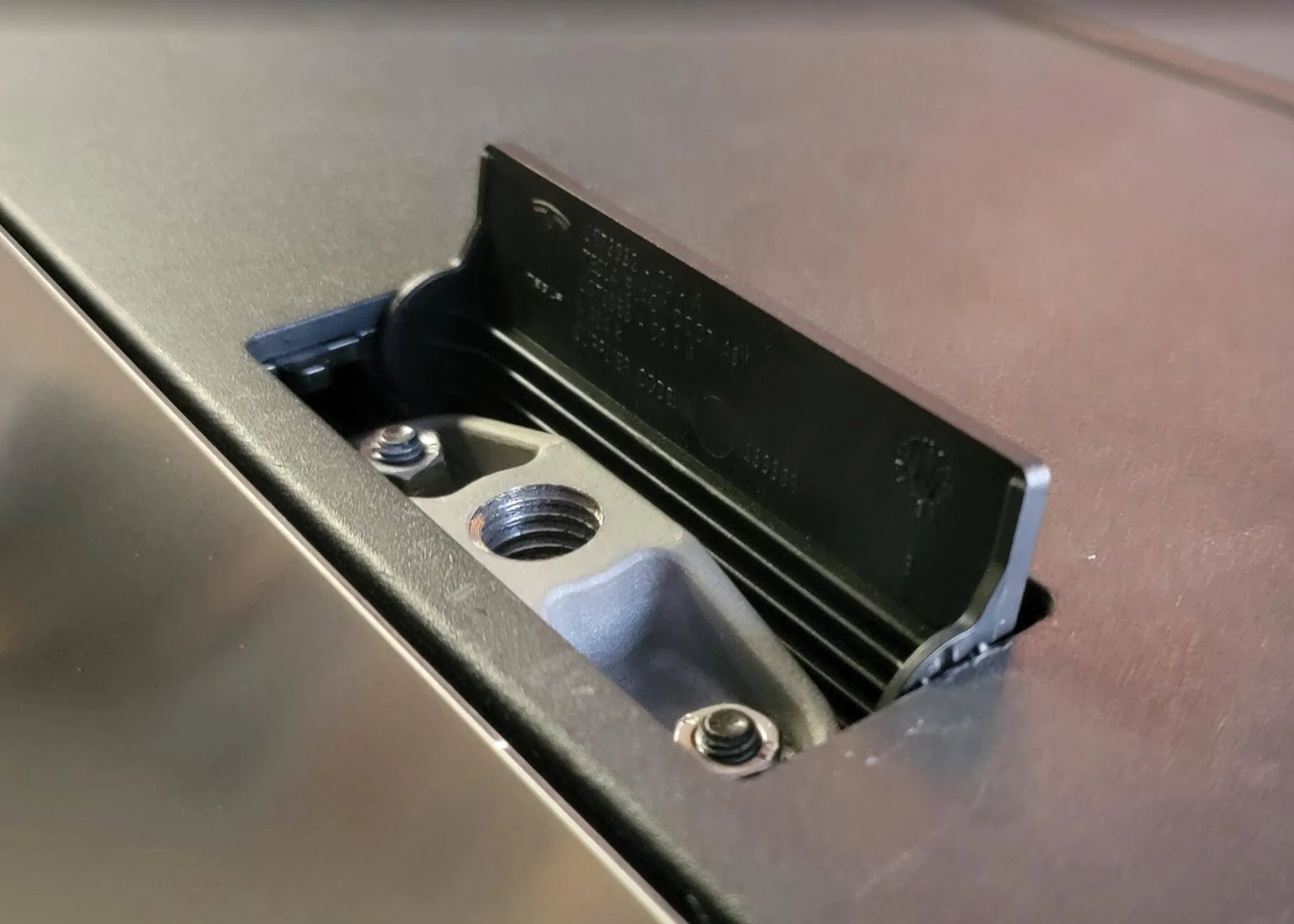

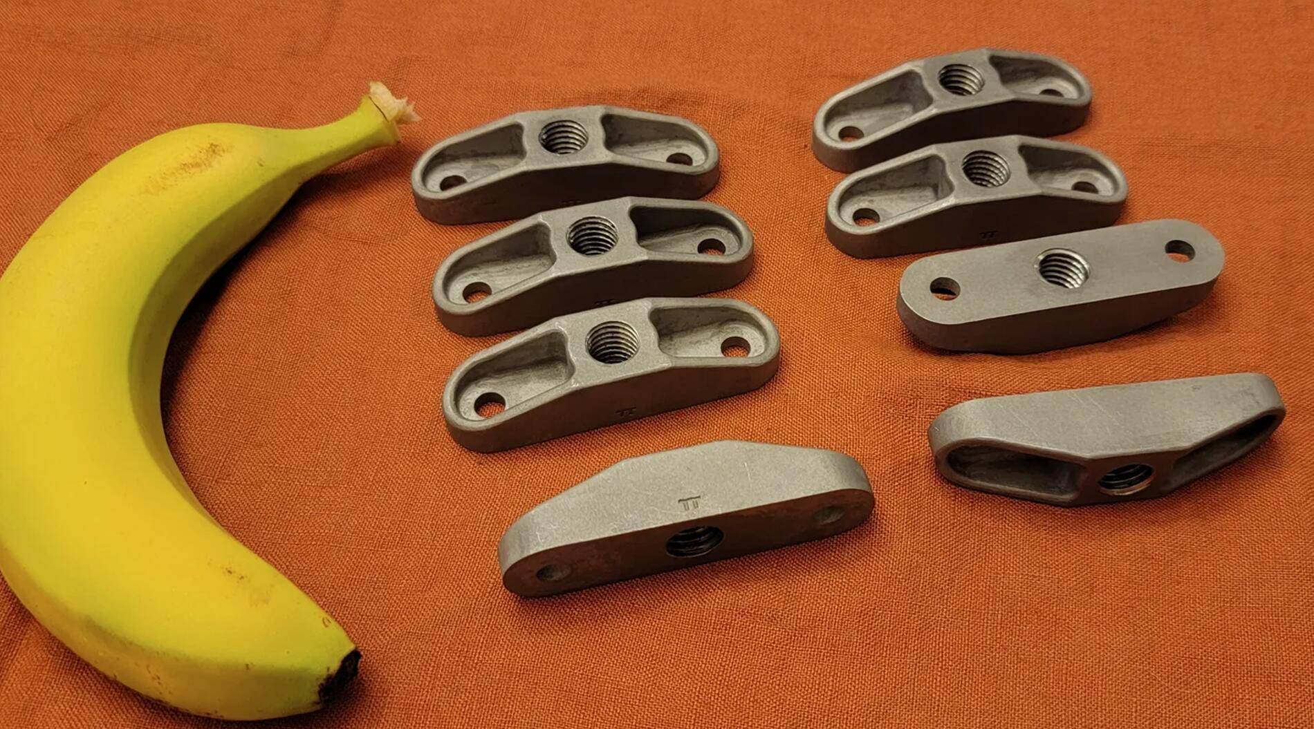

I designed these fixtures to make it much easier to install and uninstall my custom roof rack. The studs provided by Tesla are awkward to utilize so I created these adapters to fit under the flip covers and present a 14-2 threaded hole that is easy to attach to. Just drill holes in your rack above and secure with a bolt. I printed eight of these in 316 SS for $30 each. Yeah - not cheap but worth it to me. Model is free to download if anyone else is making their own rack.
Note: Threads will have to be chased with a 14-2 tap - printed part is not clean enough to use as-is. Also, since I made it fit under the covers, washers or other spacer *must* be used to span the gap between the fixture and the rack to avoid distorting the CT frame when torquing the bolts down.

Really nice, It looks like the studs are centered in you mounts,, every single one of mine was offset to the outside edge. I used 1-1/2 box beam steal and made some mounts, cost about 250 in total. 1-1/14 stainless steal tube for the racks.

Sure. I'll send you a step file. Surprised the STL isn't working for you, though. I have produced Fanuc CNC gcode from a STL using SolidWorks/SolidCam.

Thanks. I really have no interest in going into sales. However I don't mind if other people take my models to sell finished products. Has happened more than once already (usually without asking). My friends think I should be pissed but I was never going to sell them so I really don't mind. I figure they are providing a service for folks without the means or inclination to make it themselves. Just leave my TT logo/stamp intact to satisfy the Creative Commons Attribution License Agreement and we're good.

Not yet. Still a WIP. I need it to carry 20' stock so it will extend all the way forward and have additional supports from the front recovery hooks (why I don't want to have it on year round).
