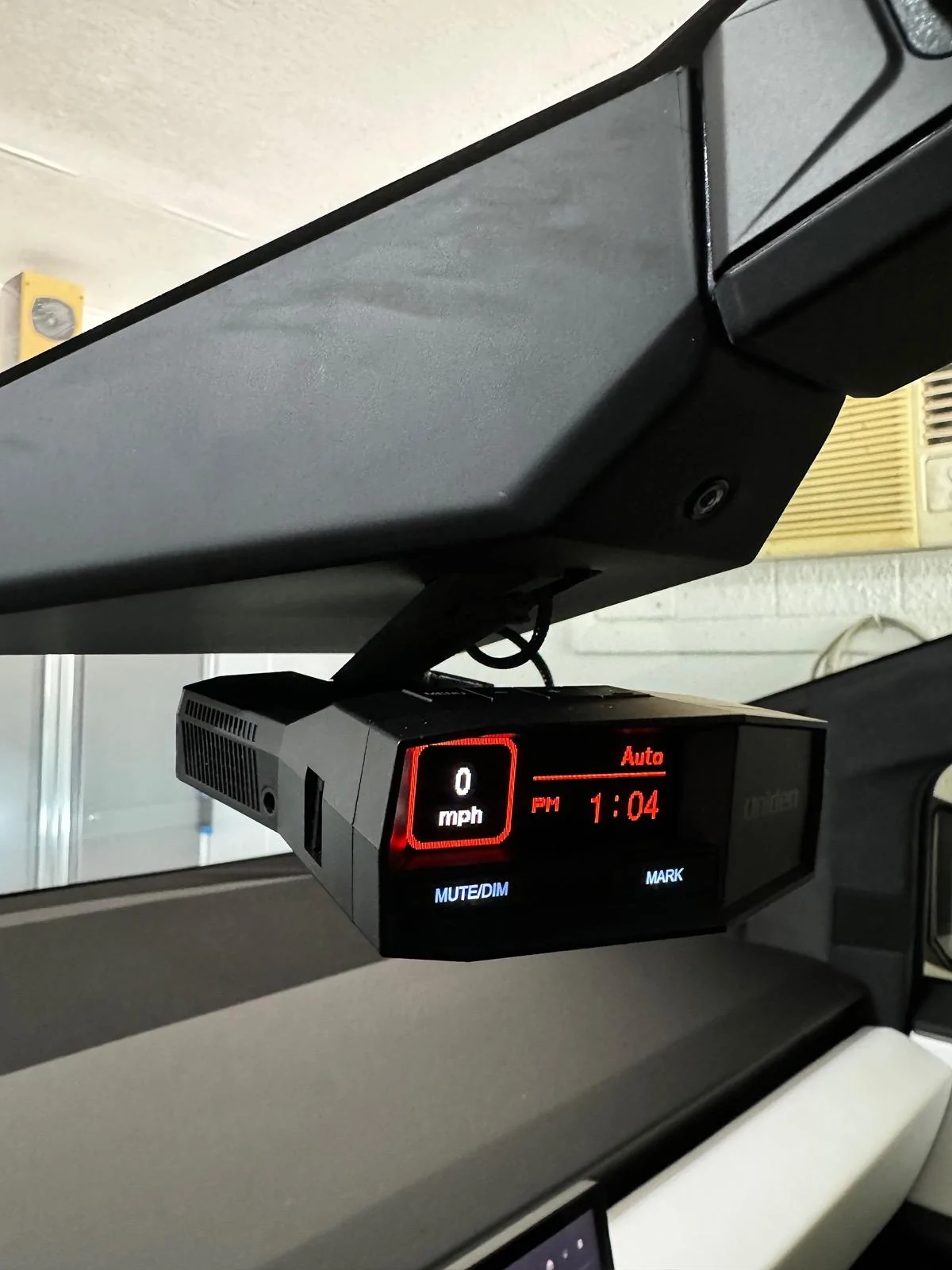

print came out well she does sag a bit but hoping the nylon is strong enough to not break and smash into my screen.
Seems like that nylon is not strong enough to bear the weight.

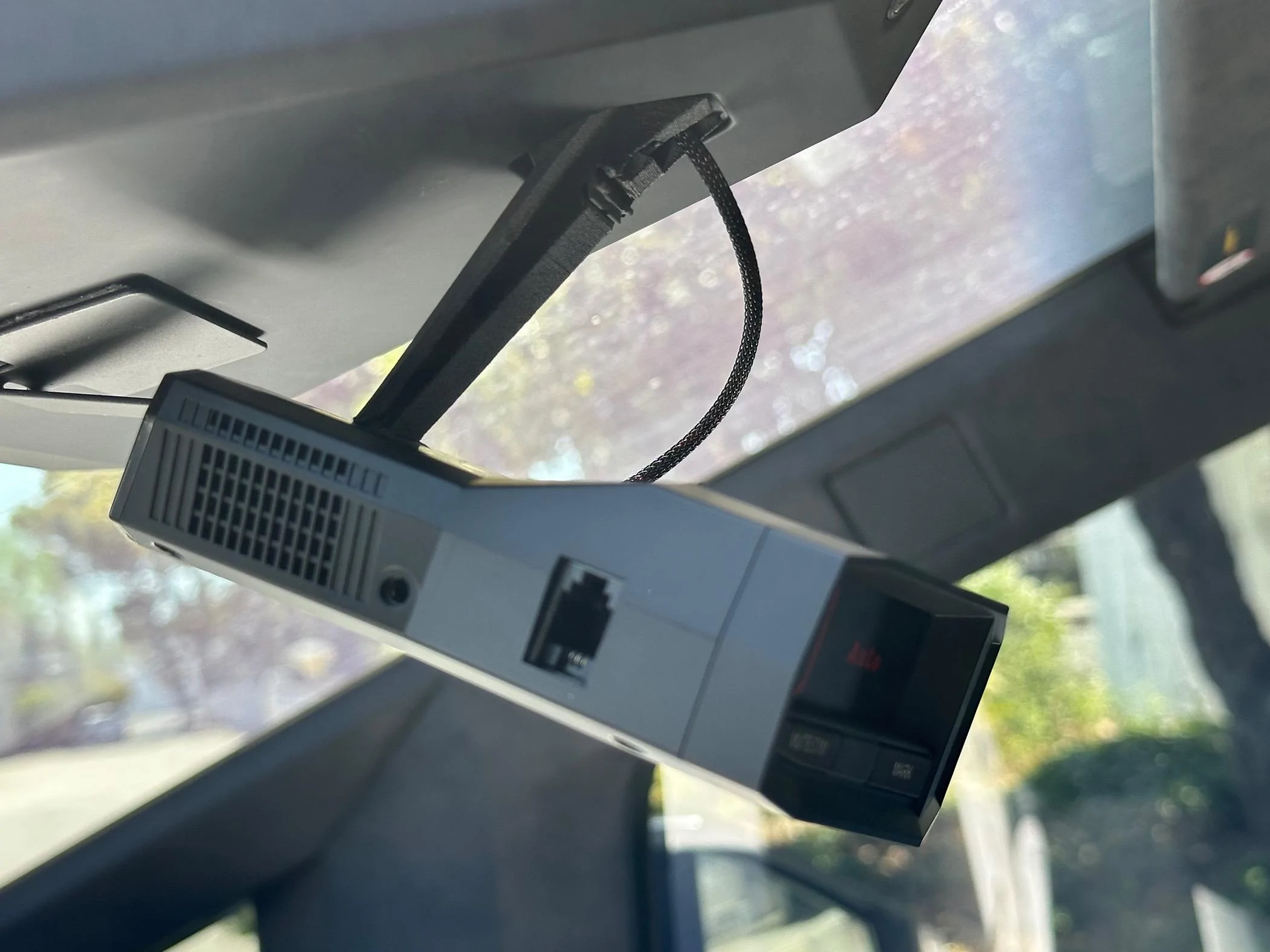

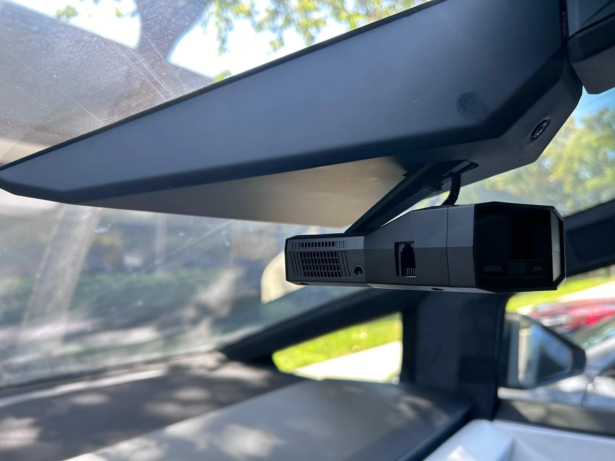

Here is mine when mounted with R8

Then you should try the latest with mentioned parameters. That will increase the strength of the mount.
Even more, you can increase infill density to 100% to create solid block to get the strongest of material but take more filament and time to print.

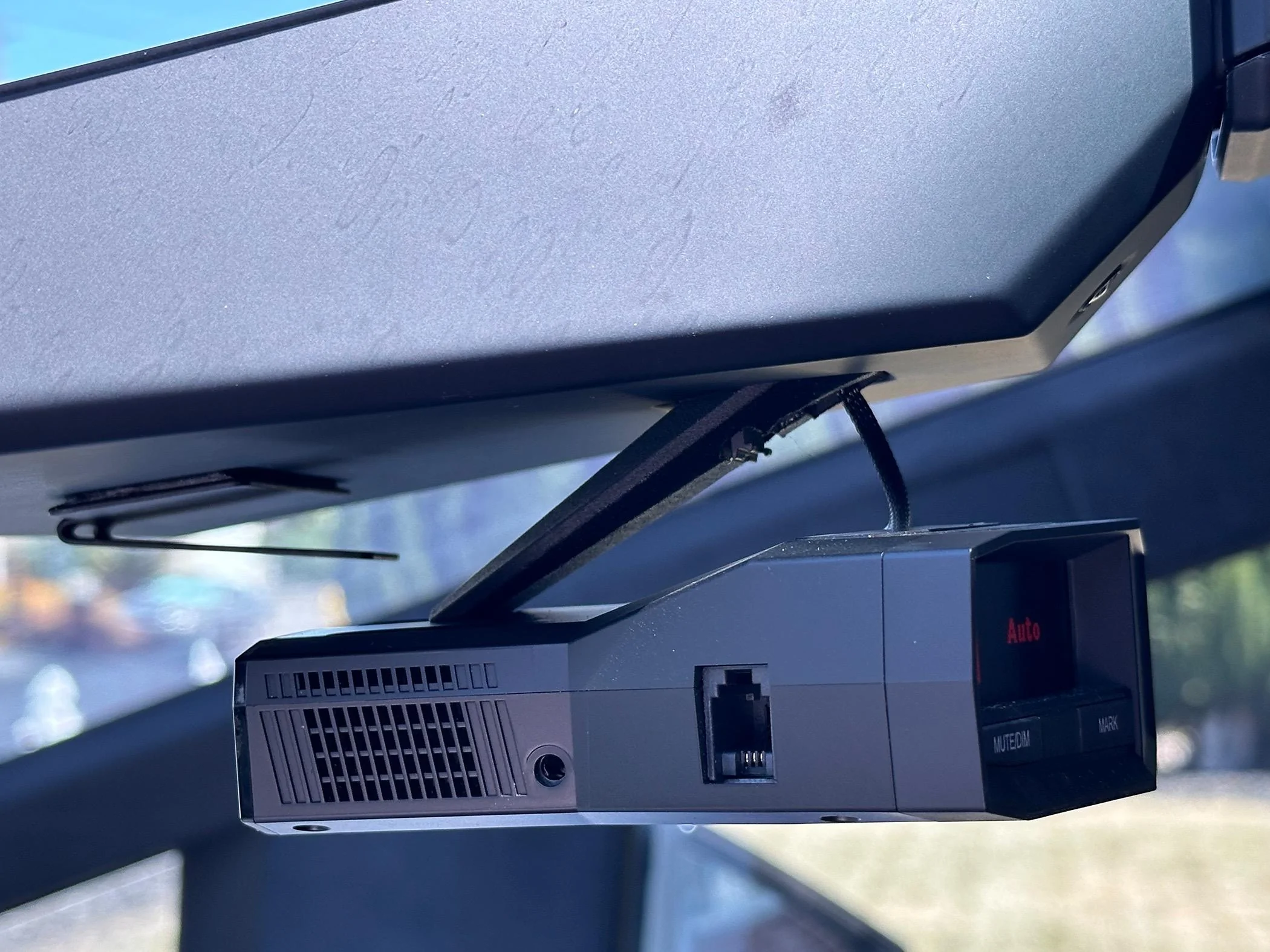

PA6 it is! Would it make sense to also lengthen the mount and put more material at the bend?

Mine still works fine so i don’t think the bend is not strong enough. From your pic, looks like your layers don’t have good adhesion. Is it pa6-cf filament? Did you dry the filament before printing and anneal after that?
