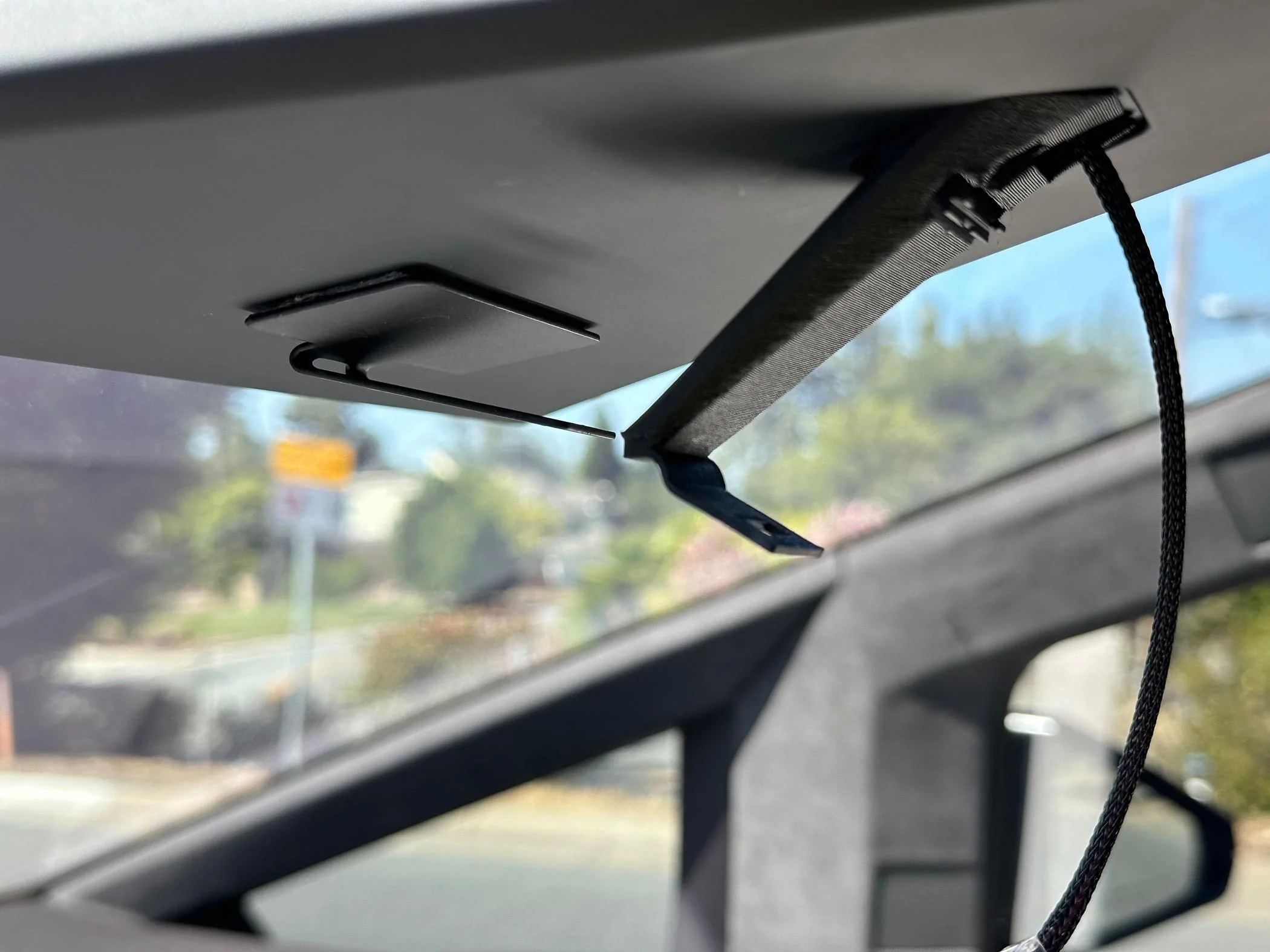

Mine still works fine so i don’t think the bend is not strong enough. From your pic, looks like your layers don’t have good adhesion. Is it pa6-cf filament? Did you dry the filament before printing and anneal after that?
I meant looks like I’ll definitely need to switch.
Okie, i had same symptom when leave the mount in cabin for a while in hot temperature. Switched to PA6-CF fixed the issue. I think ASA filament may work.

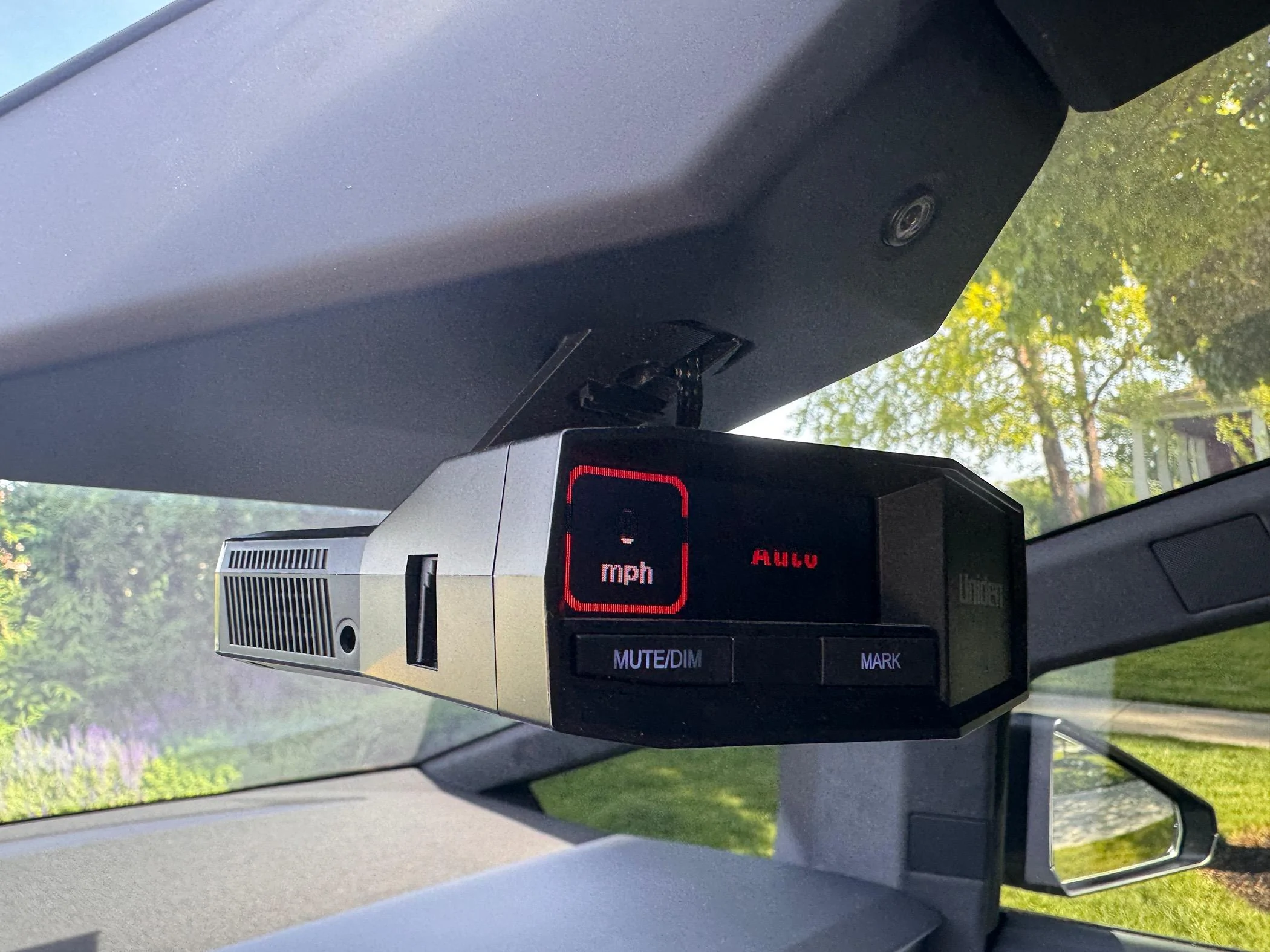

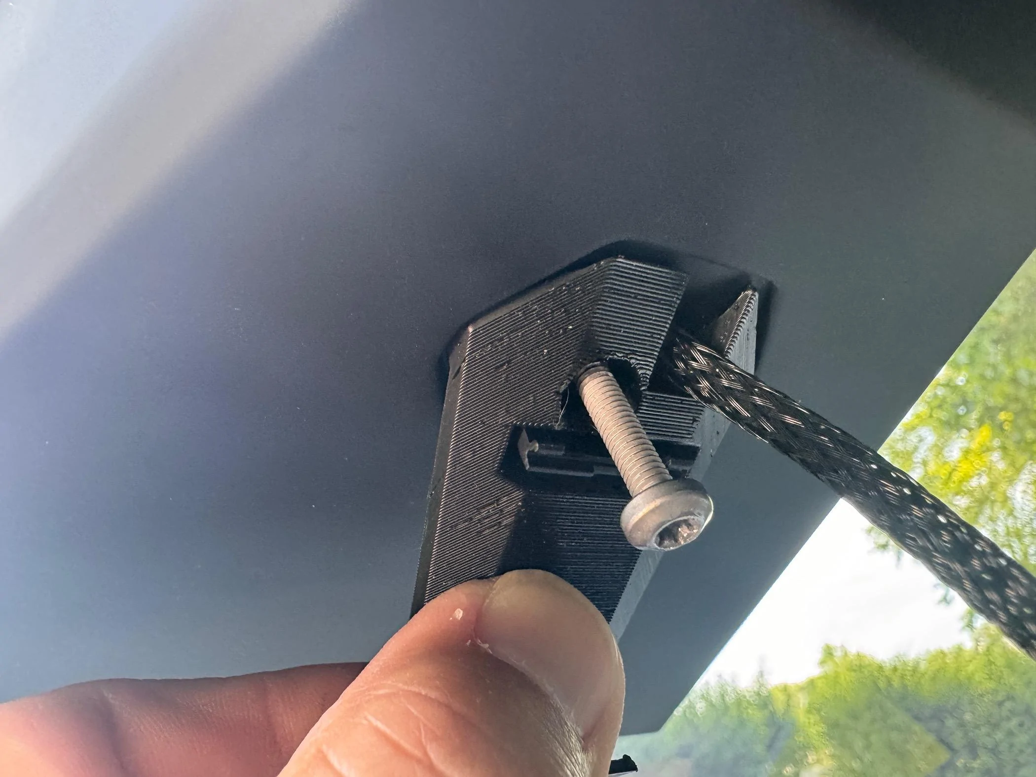

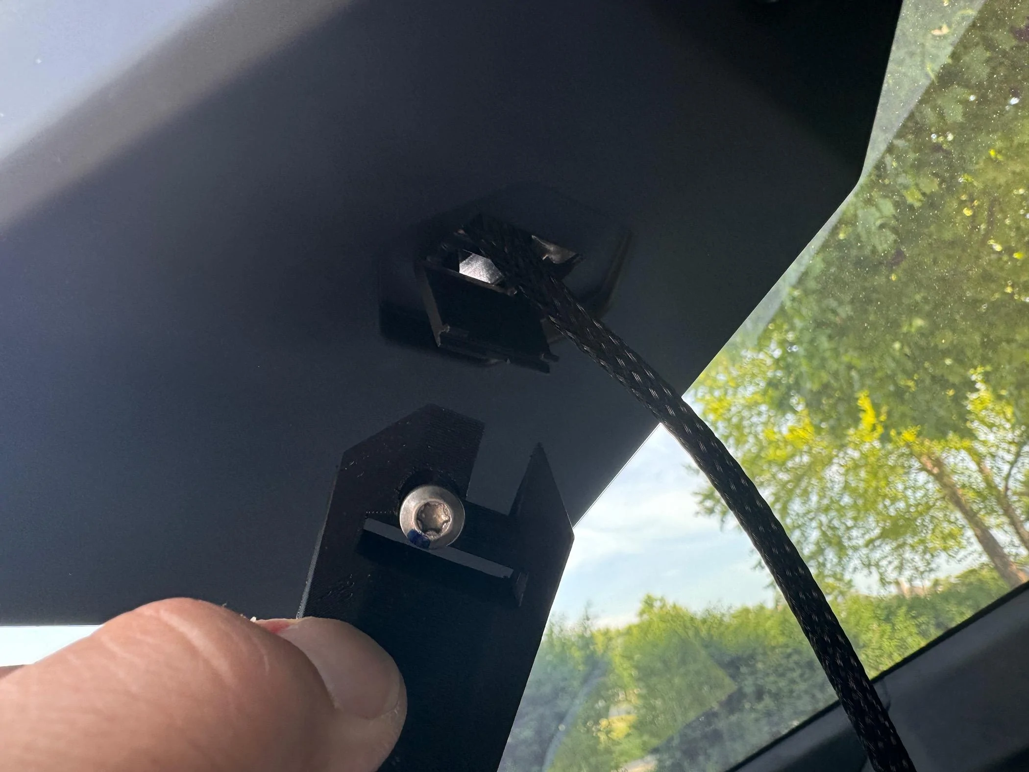

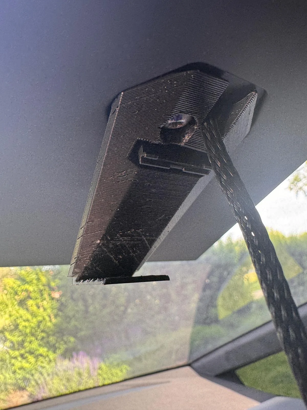

Thank you!!!! Love the design and thought into it. I tapped everything and realized I probably should have fed the wire in first but then realized you built a cut away for the cable afterwards. Smart!
Tesla Cybertruck 3D print mount for Uniden radar detector IMG_4215
Tesla Cybertruck 3D print mount for Uniden radar detector IMG_4216
Tesla Cybertruck 3D print mount for Uniden radar detector IMG_4218
Tesla Cybertruck 3D print mount for Uniden radar detector IMG_4217

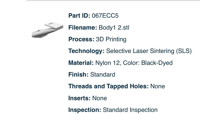

Xometry has SLS and can order this as carbon fiber solid filled nylon 12. Will this be sufficient to be strong and work in high heat? (The truck will be exposed to out door temps at 110).
They also have aluminum 3D prints which should be sufficent but it is crazy expensive.

Did you get it yet? If so how does it perform and can you share any pics?
I’m trying the $20 Xometry Nylon 12 first. It should arrive tomorrow, so I’ll post pics.

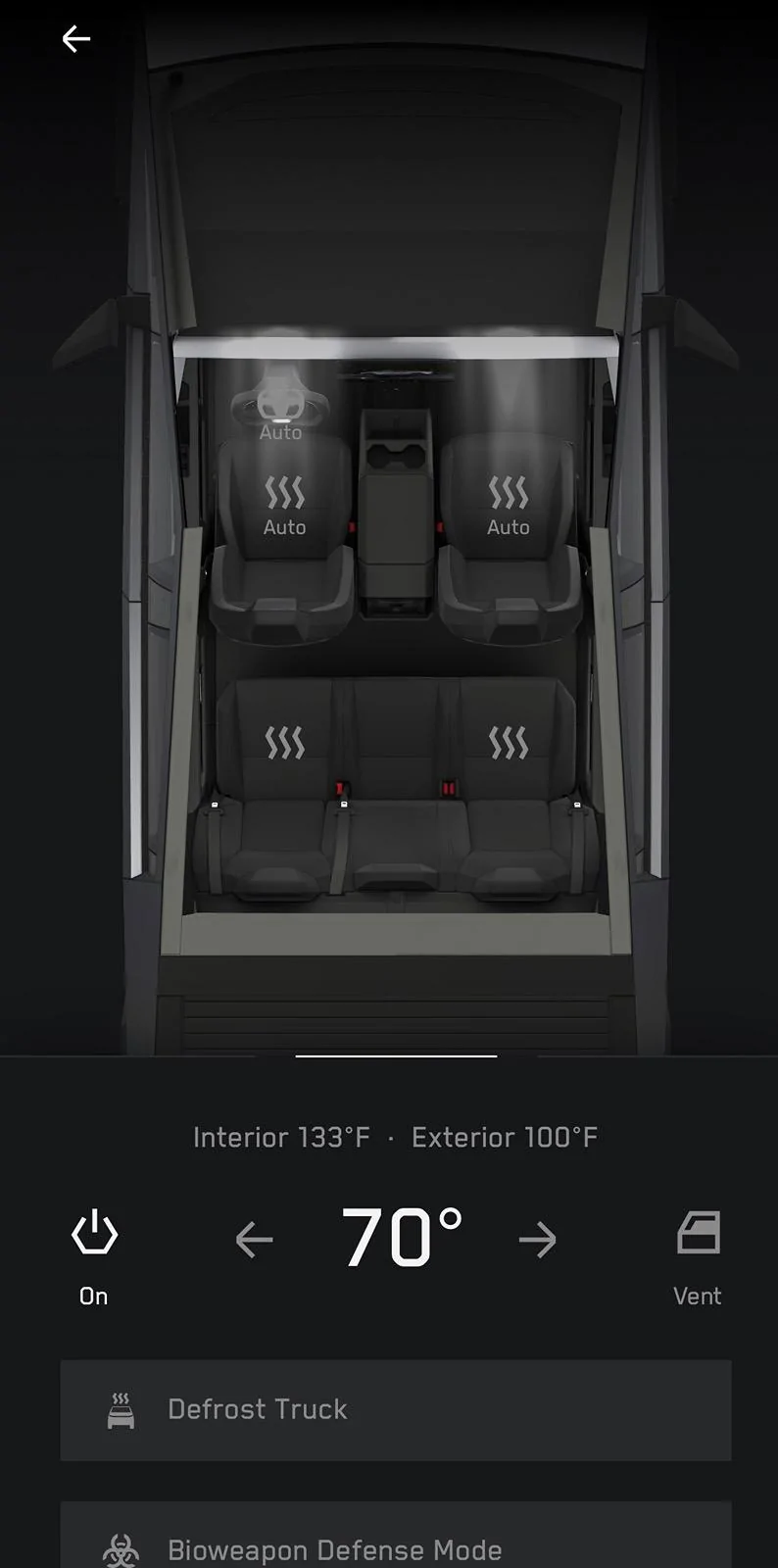

I’m in So Cal where the temp is rarely above 100. Maybe a couple days a year. I don’t often park outdoors for a long time, and I plan on having the setting on to keep cabin overheat protection under 100. We’ll see how that impacts battery.
For $20, trying this first. We’ll see if I have sag right away. Find out tomorrow!
Tesla Cybertruck 3D print mount for Uniden radar detector IMG_1472
