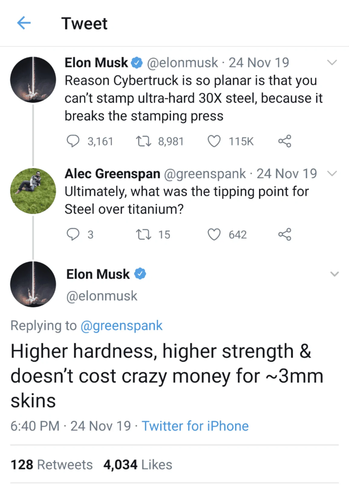

The sheet specified for Cybertruck has been described as "ultra-hard 30X cold-rolled stainless-steel,” indicating an alloy variant developed from 300-series stainless steel. (Tesla)
Tesla’s Cybertruck is audaciously austenitic
2020-06-19 LINDSAY BROOKE
A proprietary 301-series stainless steel gives Tesla’s first pickup truck unique sales attributes while saving tooling cost.
Tesla Cybertruck 3mm thick 30X stainless steel body panels / exoskeleton tesla-cybertruck-steel---autocar_gallery
Not since Ford’s epic switch to aluminum for its F-Series body structures has an automaker’s materials strategy created such a buzz. Tesla’s decision to use stainless steel for its upcoming Cybertruck, as part of what CEO Elon Musk calls an “exoskeletal” structural design, aims to give the new electric pickup strength and durability beyond that of its competitors. The vehicle is slated to enter production in late 2021, with the tri-motor AWD version following a year later.
Musk described the corrosion-resistant, 3-mm-thick (.118-in) sheet specified for Cybertruck as "ultra-hard 30X cold-rolled stainless-steel,” indicating an alloy variant developed from 300-series stainless steel. This popular class was used by Delorean (304 alloy) in its roughly 10,000 DMC-12 sports cars, and by heavy-truck maker Autocar (302 alloy) in a small-volume run in the 1960s. During the same period Ford also experimented with a few stainless-bodied Thunderbirds and Lincolns, also in 302 alloy. Today’s exhaust pipes typically use ferritic stainless steels.
“Tesla’s strategy with this truck is very interesting,” observed Dr. David Matlock, professor emeritus at the Colorado School of Mines’ Advanced Steel Processing and Products Research Center. Reviewing Musk’s public comments on Cybertruck online, Matlock surmises that the material is “very likely a modified version of the lean-alloyed austenitic 301 alloy.” When this alloy system is deformed or cold-worked, it transforms into a microstructure that includes austenite and martensite, primary constituents for a strong and tough metal.
“The more you deform it, such as cold rolling, the more martensite you get. And that contributes to a significant increase in strength,” he explained. Martensitic high-strength (non-stainless) steels are increasingly used in vehicle structures to increase strength, but they achieve their hardness through heating and quenching as is done in press-hardening steel commonly used in automobiles today. By comparison, the lean austenitic stainless alloys can create martensites by cold-roll-induced transformation at room temperature, Matlock noted.
But while Tesla’s proprietary 30X-alloy stainless skin may endow Cybertruck with industry-leading dent resistance, the material spec and the exoskeleton design force tradeoffs. “Cold rolling makes this material very strong but sacrifices ductility and formability. That means a minimum subsequent metal forming is possible and dictates mostly flat panels and straight character lines,” Matlock said. The truck’s outer body contributes to the strength of the vehicle structure, unlike a conventional body-in-white whose strength comes from controlling the A- and B-pillar geometries and using combinations of press-hardened steels.
As a result, the Tesla truck’s polarizing “planar” styling is either Blade Runner-cool or high-school-metalshop crude, depending on your aesthetic sense. The material characteristics and robust 3-mm sheet thickness (typical steel door panels are on the order of 0.7mm to 1mm) spurred Musk to claim that the “ultra-hard 30X” can break a stamping press. Hyperbolic or not, Tesla has engineered a material and manufacturing solution that requires minimal forming operations, enabling huge potential savings in presses, dies and related operations for its radical new pickup.

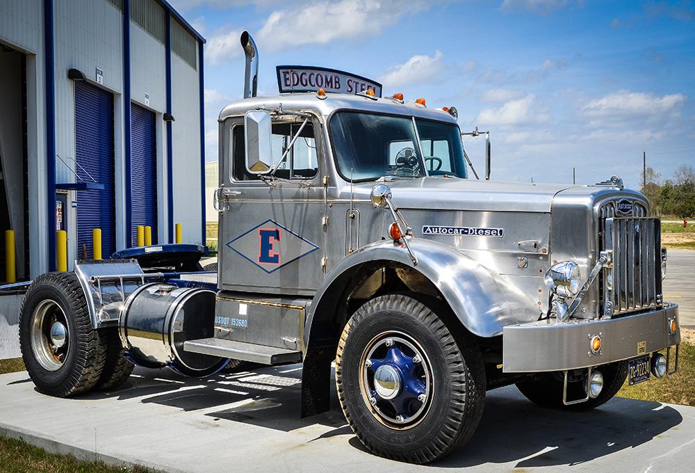

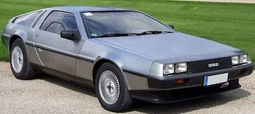

After thinking about it some I'm convinced that Elon was a fan of the Delorean and studied it's stainless steel construction. And after all he did put the gull-wing doors on the Model X. I watched a video interview of Elon and he said he regretted adding the gull-wing doors to the Model X because of the complexity. Keeping it simple seems to be something he's learned about building cars, avoiding production delays/tie-ups, recalls and adding to profitability.
Maybe it's just me but I see some design resemblance from the Delorean that was incorporated into the Cybertruck. The slanted windshield/windscreen for example and a little bit of the front end.
