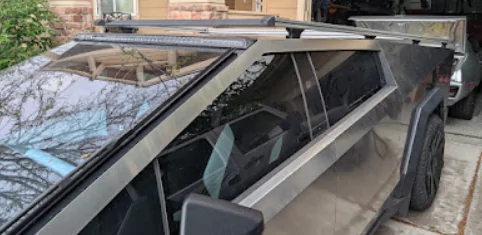

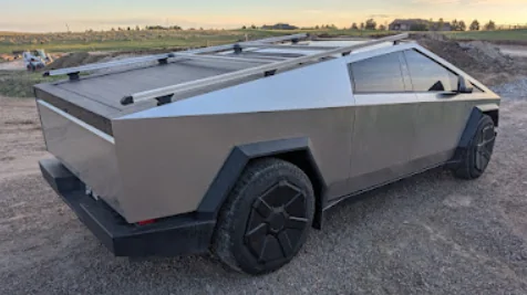

Here is my DIY T-slot roof rack. I made the risers out of TPU with 10 walls and 50% infill, they are super stout yet have a little give.
No change in efficiency noticed with only the mid cross bars. Just added the front bar with a deflector, no data yet on range hit.
All 8 risers are unique to get the bars level.
Files here ----> https://drive.google.com/drive/folders/1nycNY6jZD9laz632Lr6vFt-UWwN2OPsj?usp=sharing

Looks great, thanks for sharing the plans.
If possible, though, I would recommend printing the parts on their side to change the layer orientation and reduce the risk of them shearing/failing over time.

Thanks,
Yeah print orientation can definitely be important. Being TPU, they have very good adhesion and toughness so I went for the cleanest look. As of yet I have been unable to break one in bench stress testing, but I will of course keep an eye on them. They also have a couple additional levels of sheer resistance...40 mm long stainless sleeve nuts for lower reinforcement, and additional ports to add screws for upper reinforcement.
Tying all 8 points together makes for a very strong platform.

Ah, didn't realize the bolts went most of the way through. Even without them I'm sure it was mostly fine (especially being TPU like you said), but thought I'd share
What printer did you use? It did a good job with the TPU

What kind of static and dynamic load failure tolerance do you think these have?
I highly skeptical about the idea of printed plastic resins being used as anchor mount points for something like a roof rack. I think it's asking for trouble.

Depending on print orientation, printed parts can be pretty robust. If I make one I'll probably use polycarbonate. If printed with layers aligned vertically (printed on its side) I would expect static loads in the hundreds of pounds. Polymaker publishes alot of data around their filiment load tolerances.
https://airwolf3d.com/2017/07/24/strongest-3d-printer-filament/
