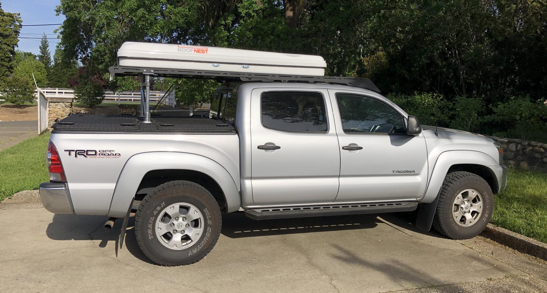

I liked the simple tubular rack idea. I want to be able to get into the truck bed as well as hauling larger things with the bed open. I replaced my OEM roof rack on a 2013 Tacoma with a Prinsu cab rack then added a modified Prinsu tonneau cover rack to extend it over the truck bed so I could carry a rooftop tent. The rack is about 8-ft long allowing me to easily and safely carry lumber 12-ft long. Haven't tried 16-ft pieces but that would mean only 4-ft on each end not tied down. I build the tonneau cover vertical support out of 1" aluminum tubing. Don't have a welder so everything bolted together. I could see a similar idea using the roof rail mounting brackets (if they are actually there) with simple aluminum brackets using extruded aluminum rails. Lightweight, strong and easy to remove.
As for tires, I upgraded to Toyo Wild Country Trail 4SX because they're 10-ply tires, giving me more stability when hauling rock and dirt. I'm not going to do a ton of off-roading, I just bought this model of Tacoma because it was on the lot and it had upgraded cooling and factory towing. I'd rather have a nice highway tire that won't pop when going off-road and will carry heavy loads once in awhile.
Tesla Cybertruck Full Length Roof-Bed Cargo Rack Concept IMG_3387

I like your rack as far as functionality. I would be worried about when going over an obstacle that the bed can flex one way while the body flexes the other way and put a lot of pressure and strain on the rack, which appears to be mounted to both the body and the bed. Have you encountered any issues related to that?

cool. But knock out those black panels for SS, or just no panels and keep the framing. Too different styling of the black panels to the rest of it. Doesn't help those panels have circle cut outs. Circles clash with the polygonal paneling of the rest of the truck as there are literally no circles on the rest of the paneling. Circles are the antithesis of polygons. At least match the shapes if you are going with those cutouts in the panels.
I'd just rock that with the rack and raised secondary flat storage surface.. no sides.

I felt the flexing of the cab vs bed which is why I changed how I mounted the rooftop tent. Previously I had six mounting points, four on the back, but now I only have two up front and two in the back. This allows some flexing. The roof rack is made out of 1/4" aluminum so it does flex left to right but could bend front to back. I've had plenty of wood, including plywood, lashed down and so far nothing has broken or cracked.
Hopefully the CT will be stiff front to back and any roof rack won't have this potential problem. I only have the rooftop tent attached when I'm using it and have removed the back half of the roof rack so I can remove the Diamond Back tonneau cover when hauling stuff in the bed. I'd like to have this capability with a CT rack. As I said before, my rack is lightweight, not requiring any help to lift on and off the truck. The rooftop tent is too heavy for one person but I've used kayak/bicycle lift pulleys when I had a garage and now I built a platform in a shed so I can slide it off without too much effort. The CT has to have the ability to easily install and remove a roof rack without requiring a chain hoist or four tall people.

Looks like it might be tough to bolt that rack into Cybertruck's roof, being glass and all.

I really like the idea of a rack like this that can also drop down to be at the same angle as the sail pillars. if it had a roller on the back it could fold down and almost act like a lumber roll off. And if not roll off then at least the angle would reduce the friction due to gravity and make unloading boards or equipment easier.

In spite of the name, roof racks don't get bolted to the roof, they get bolted to the frame, just above the door. The Cybertruck definitely has that. Whether they have roof mount attach points or not is a whole other question though.

Semantics. I know racks attach to the frame, which on the Tacoma is accessed through drip rail. I don't think anyone is actually attaching anything to the sheet metal roof.
I've seen the photos showing what looks like attachment points but until someone at Tesla actually says that's what they are for, I'll wait.

Not semantics at all. I was replying to someone who said it would be tough to bolt it to *glass*, not your post.
I like the rack you posted a lot better for the CT than the one at the top of this thread. It looks a lot more practical and aero.
Lots of renders are based on "Looks Cool" not "Does the job well". The top one falls into the former category. Yours the latter (and yours looks fine too!)

I realize that, but this particular one in the pic I'm referring to is bolted to the roof (bolted, glued, screwed, tattooed, whatever, but its connected to the roof.
