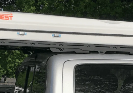

You just gotta look a little closer.
There is a seam there where the sheet metal of the roof joins the frame. Most visible just above the rear window.

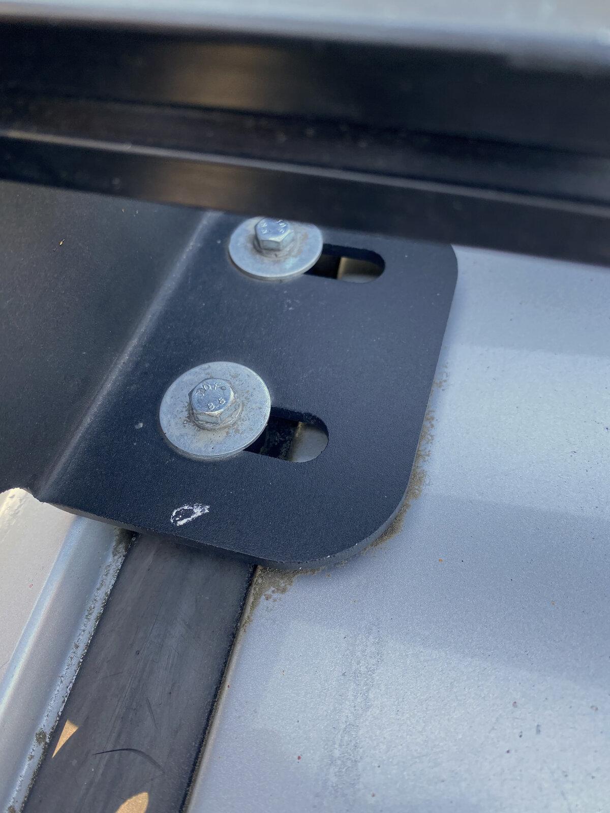

The rack consists of 2 laser cut side rails constructed of 3/16″ 5052 aluminum plate. These rails have 3 mounting tabs each that will allow you to bolt the rack into the 5 factory mounting holes on each side of the roof.

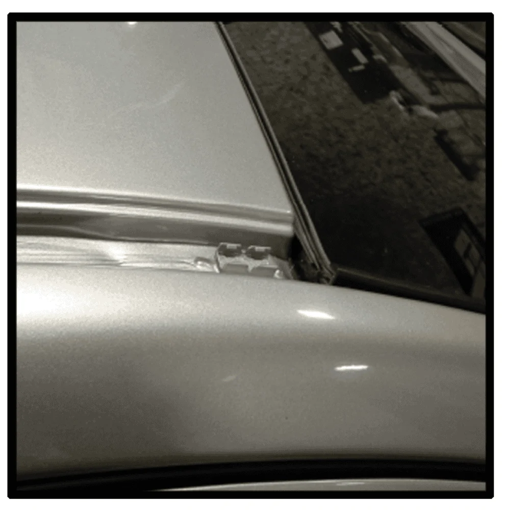

Prinsu calls it the roof but when you look at the rain gutters, the roof panel is bent and welded to the frame, therefore the roof rack is actually attached to the steel cab frame. I'm not going to argue one way or another on this, but I do know how I installed this roof rack. You can say it's attached to the roof if you want to but I see it being attached through the roof.
Photo shows the leading edge of the rain gutter, which is normally covered by a rubberized strip. That strip is removed, holes drilled where the bolts go, then reattached. Second photo shows how the bolts go through the mounting tabs. The rack is lifted a bit using metal tubular spacers. See prinsu.com for information.
