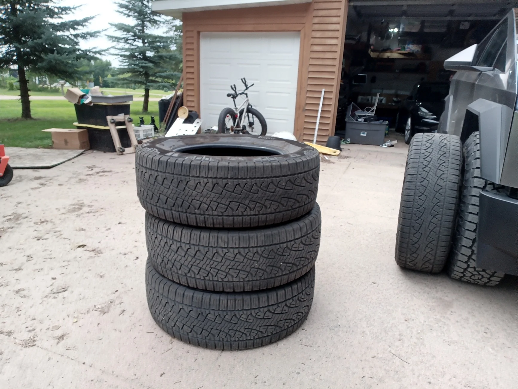

The only tire that this works with is the Toyo AT III EV tires in 285/70R20.
Tesla Cybertruck How to fit 36" tires (35.7) on stock wheels without rubbing. a98821c5-816e-4a8e-8811-df7ca8b791fc
Tesla Cybertruck How to fit 36" tires (35.7) on stock wheels without rubbing. Tires

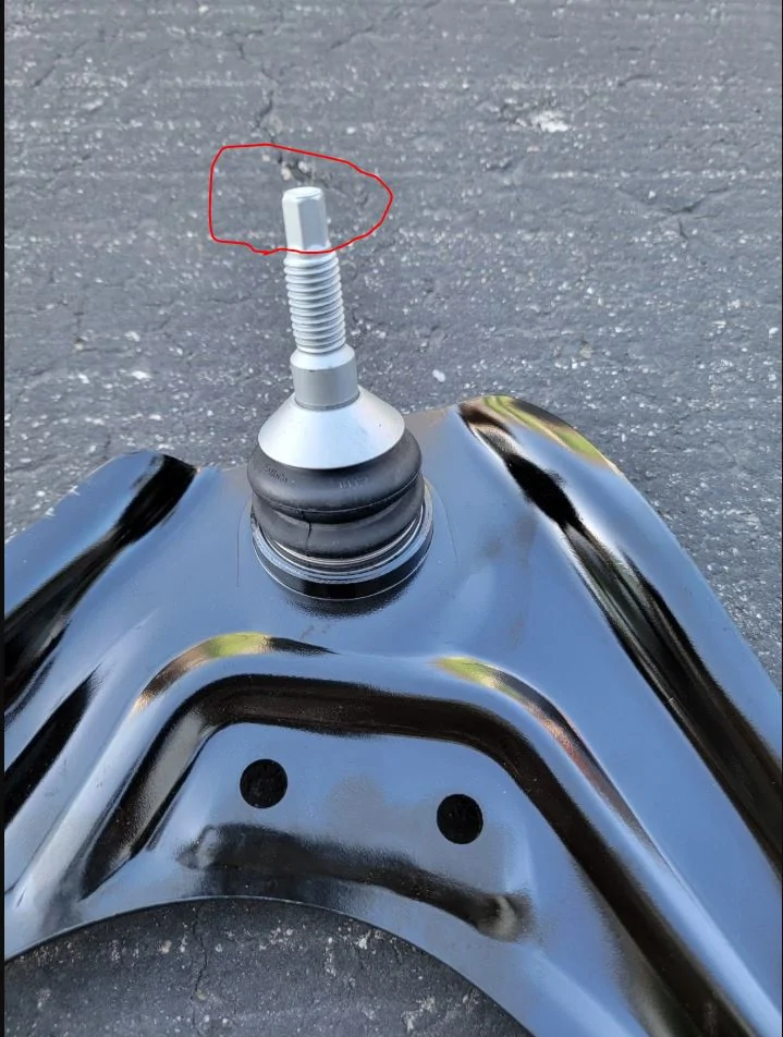

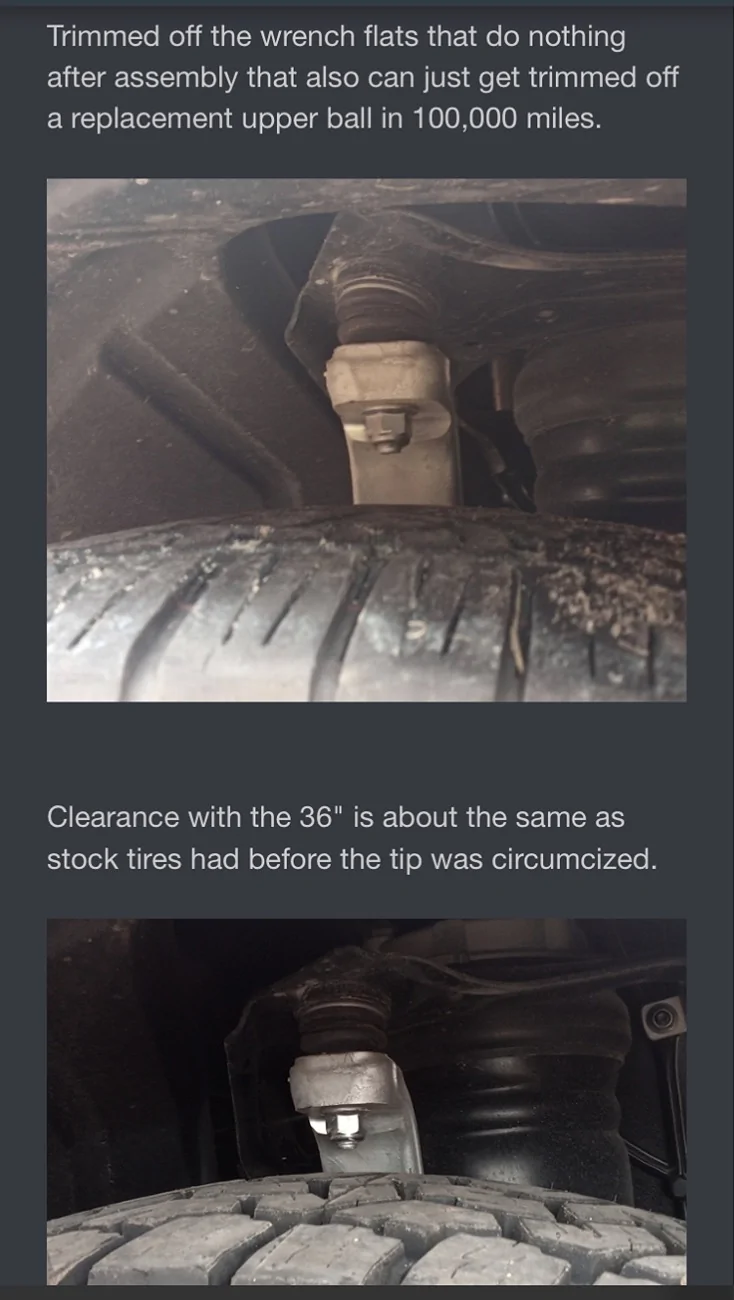

Trimmed off the wrench flats that do nothing after assembly that also can just get trimmed off a replacement upper ball in 100,000 miles.
Tesla Cybertruck How to fit 36" tires (35.7) on stock wheels without rubbing. Trim

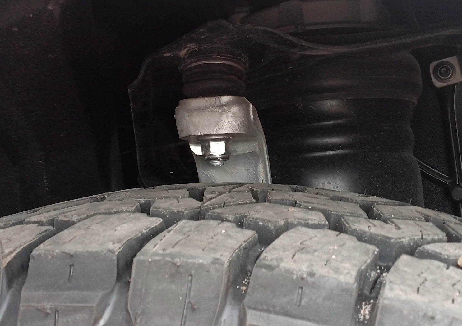

Clearance with the 36" is about the same as stock tires had before the tip was circumcized.
Tesla Cybertruck How to fit 36" tires (35.7) on stock wheels without rubbing. GxipqXDWwAAJHOQ

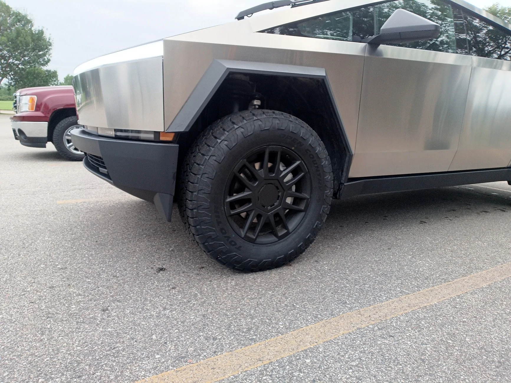

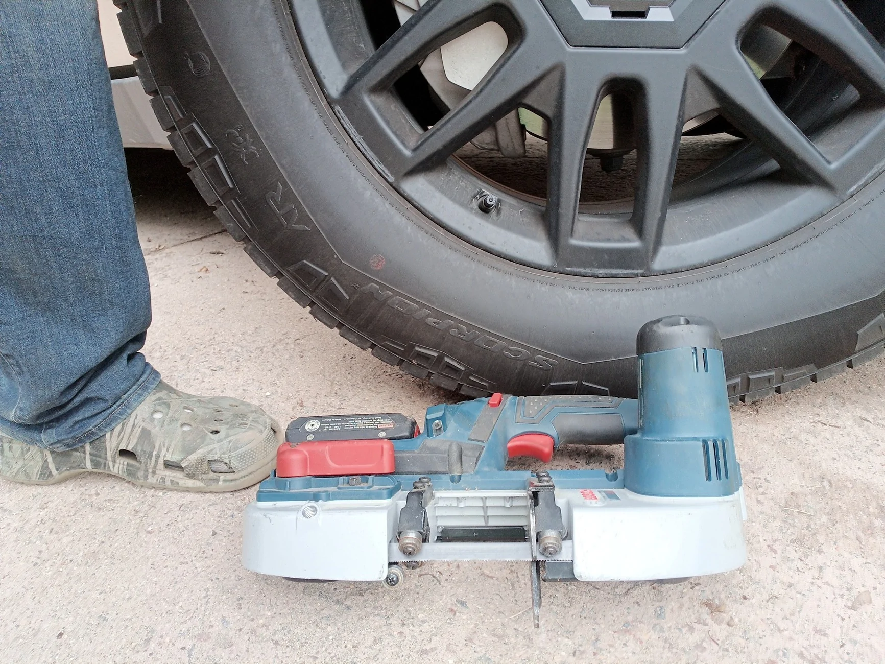

The Port a band took about 30 seconds per side. The camo Crocks are optional but no mullets.
Tesla Cybertruck How to fit 36" tires (35.7) on stock wheels without rubbing. Sa

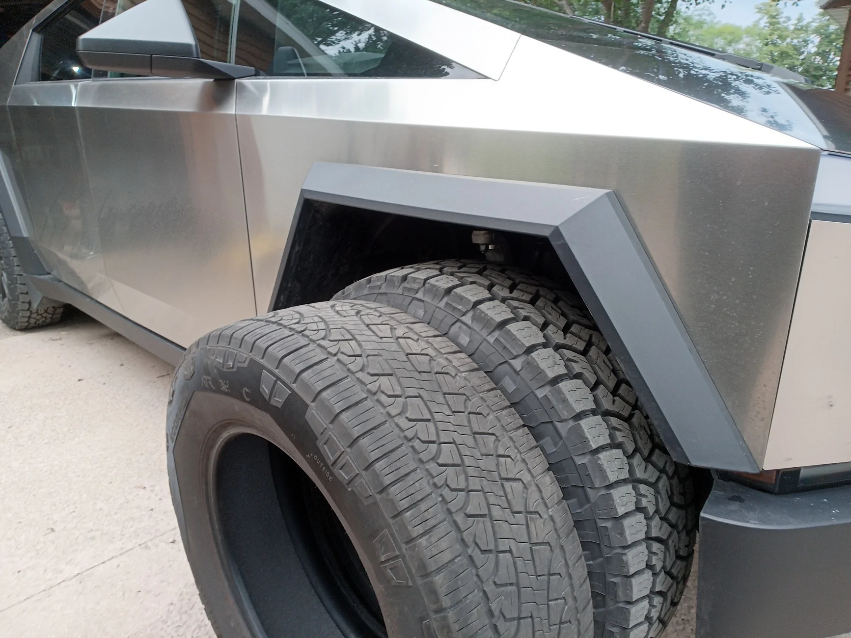

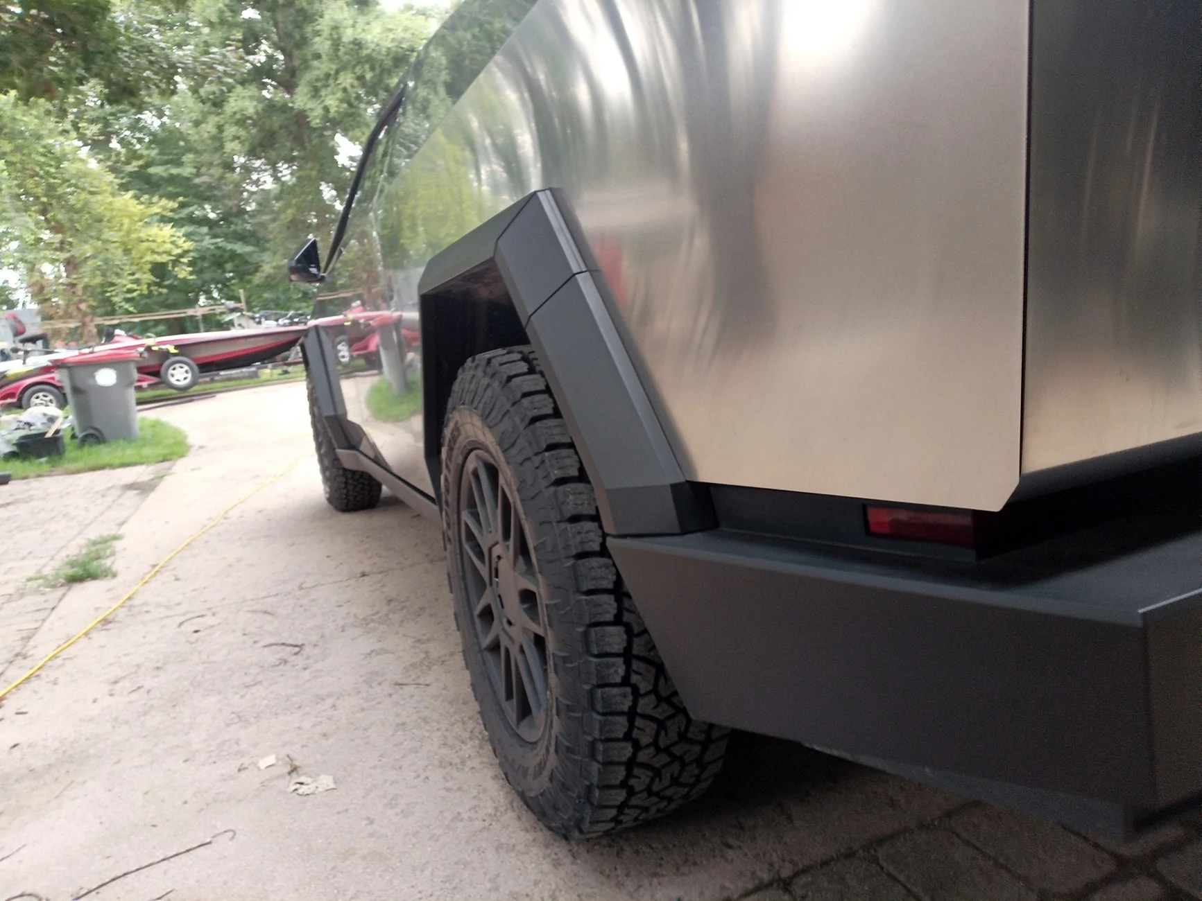

A lot better, almost as quiet despite being actually great tread in snow and dirt. The energy app actually shows less energy consumed per mile since the upgrade but I'll drive 100 miles and compare the 100 and 200 mile history for energy on the energy app and then comment.
Tesla Cybertruck How to fit 36" tires (35.7) on stock wheels without rubbing. Rear
This is the high on road height but I can drop it all the way down to entry or go up to the highest offroad setting, turn the wheel all the way either way and not rub.
Tesla Cybertruck How to fit 36" tires (35.7) on stock wheels without rubbing. Front

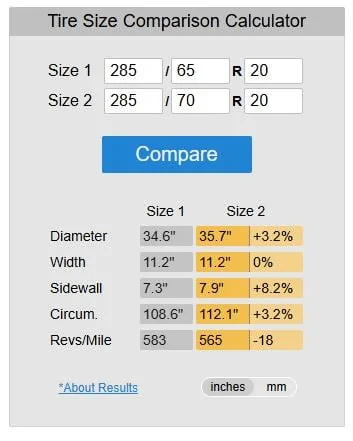

What Tire Size Calculator app did you use?

So it was no go with trimming the ball joint? I thought it would be very close. I would be concerned about removing the ball joints. I guess you use an impact driver?
By the time they need replacement the tapered shank of a ball joint is typically stuck enough in its bore that it wont spin with an impact and it takes a hammer tap to get it to move after the nut is backed off.
The new tires having as much clearance as the stock ones did was my goal for good reasons.
The mountain pass UCA's look like they have an internal allen so it has about the same clearance.

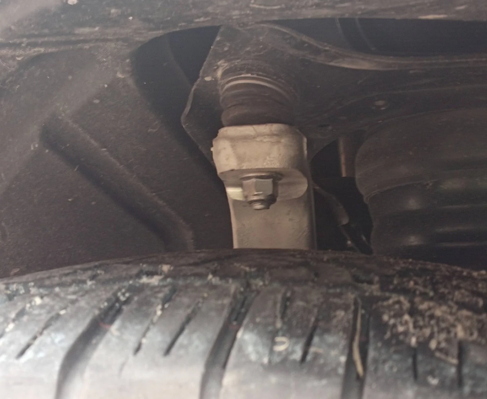

Forgive my ignorance but these look the same to my old eyes. What exactly did you trim?
Tesla Cybertruck How to fit 36" tires (35.7) on stock wheels without rubbing. IMG_5798
Tesla Cybertruck How to fit 36" tires (35.7) on stock wheels without rubbing. {filename}
That is because it was trimmed off in both those pics.
Just cut off the wtench flats that stick out past the nut. Here is a pic of a upper taken apart so its easy to see.
Tesla Cybertruck How to fit 36" tires (35.7) on stock wheels without rubbing. Captur
