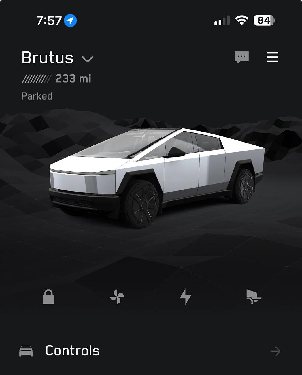

50 miles of battery usage parked over weekend I’ve known I’ve had excessive drain for a long time now, but finally decided to pay attention over the w

From what I gather, pending software update isn’t handled properly…the existence of an update ready to download prevents vehicle from sleeping. I normally get the “advanced” updates but I think I’ll switch that setting back to normal just before my next trip and hope for the best.

That’s not what occurred. Climate control is off. Sentry is off. It’s apparently a known bug in Tesla’s software. If they have a software update available and you don’t install it, then the vehicle can’t enter sleep mode.
Overheat control at 100° used about double the power of the software update not letting the car sleep bug. Once I install the update, the electricity theft through software negligence will cease. It’s never had a phantom drain before.

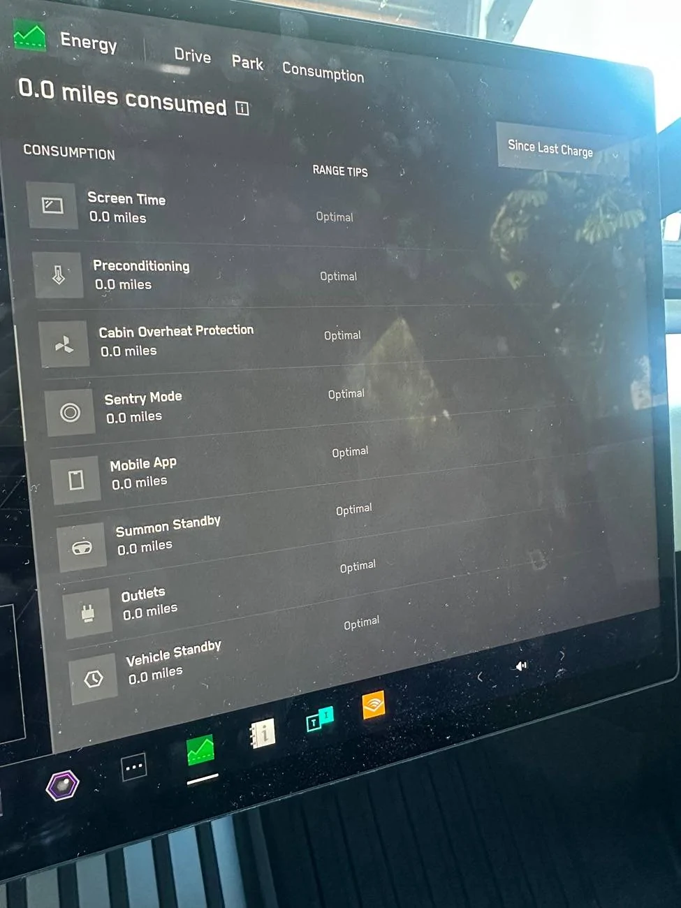

Made it home from Finland. CT had 10% battery when I got back after 1 week. Parked at 62%.
I didn’t go to energy settings to see what the major malfunction was before driving to two charging locations (first one navigator selected was behind a “team members only” badge reader, which meant I had only 7% left to go find another supercharger.

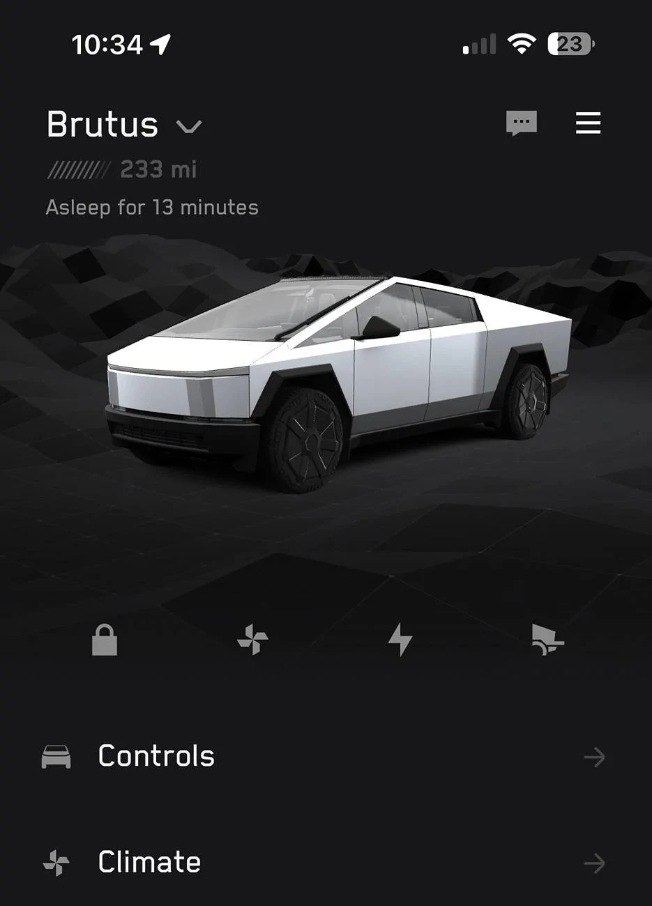

Almost 10 hours and zero drain. That accessory on button really hosed me, but at least going forward the drain at home and work should be negligible. Crappy thing is I sized my upsize on my solar panels based on my usage over the last year, which was apparently grossly overstated thanks to my lack of focus on getting this dialed in. Oh well - more AC usage this summer ;-)

I left my truck for 8 days while out of town, it lost less than 0.5% per day. I have Sentry disabled while parked at home, since I have security cameras. That 8-day drain drain even included applying a firmware update lol.
If you're burning significantly more than that, open a service ticket. (Sentry efficiency was "improved" a few releases ago, but it's still a pig at 4-5% per day.)
