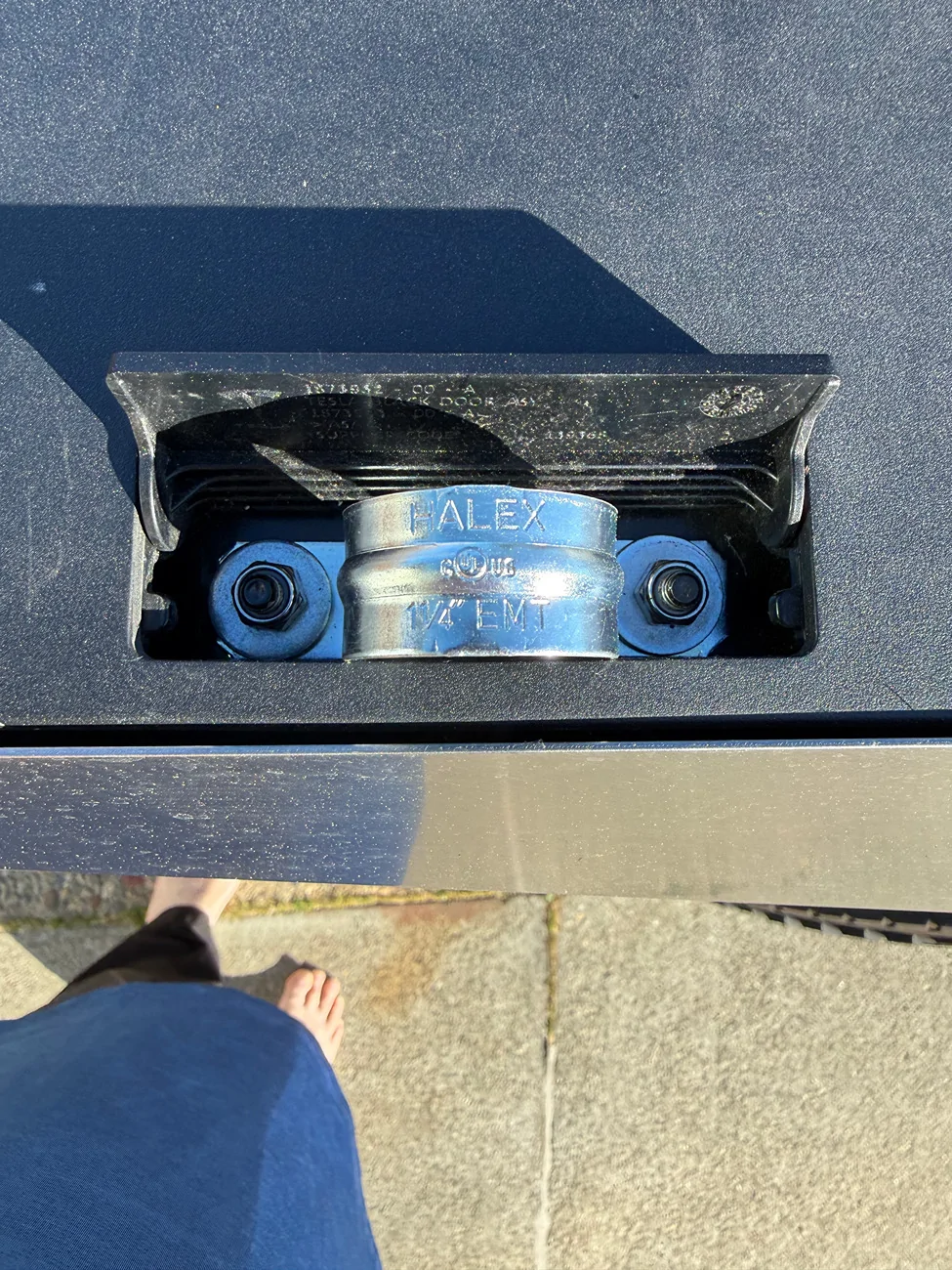

Home Depot special when you are in a hurry to move that queen sized mattress.
Four EMT clamps, eight 8-1 nuts, eight washers. 10 MM deep socket. 30 minutes.

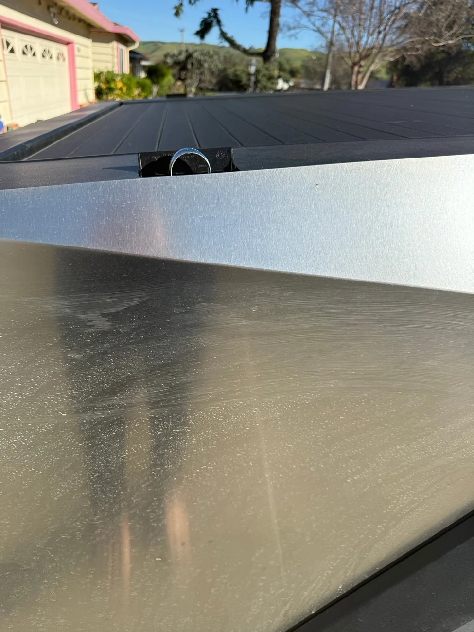

Huh. I wonder if L-track could be mounted in there and still leave room for the flaps to close.

Similar approach using Oatey pipe hanger strap would give you the tie-down - but still be able to close the hatch.

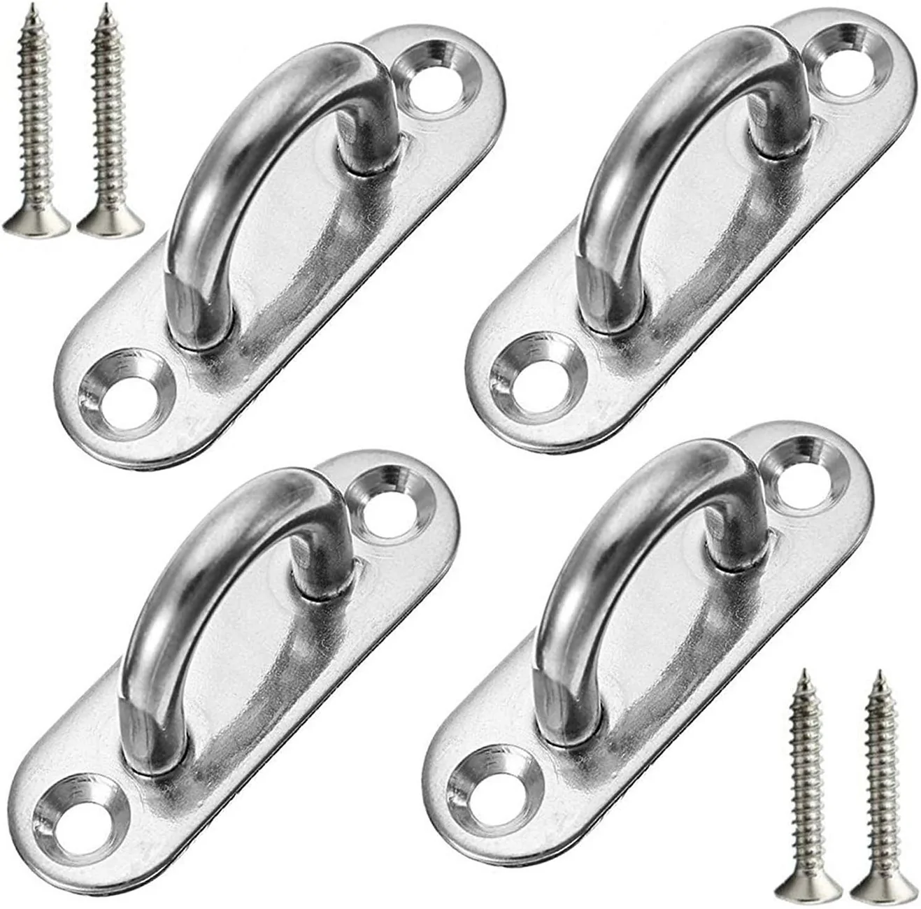

I don't have the dimensions yet, but was wondering if fixed D rings for sailboat rigging would work. Many different sizes and materials are available.

How do the flaps come out? Just squeeze them and disengage one side?
I believe so yes.
Edit: I've seen a description of removing the door somewhere; could not find that post, sorry.
I'd certainly be interested in a link to a stainless loop that lets me open and close the door.
This is more what I was thinking of, but the ones I used in the past had proper welds around the base of the Ds. There is also a style with a strap, like the conduit strap, but for holding a D-ring. Width and D-ring size are the issues with that type. The strap could be altered to hold a smaller or shorter D-ring to allow it to fit.
