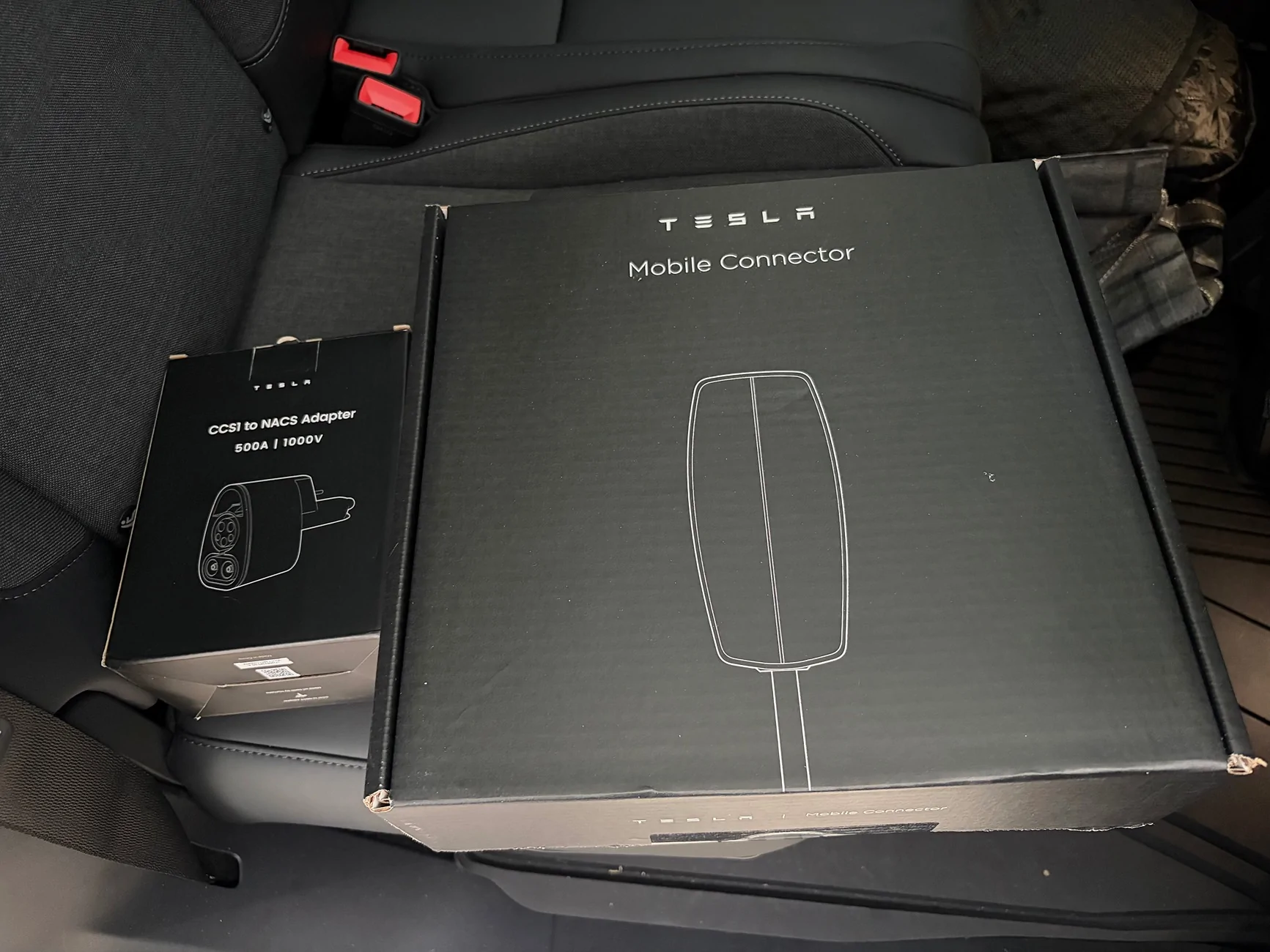

I believe a lot of people have received a mobile connector which comes with 14-50. If I were you, I would keep it just in case you visit a rural area, like for camping at a national park or someone's house in the boonies with access to a 14-50 plug.
