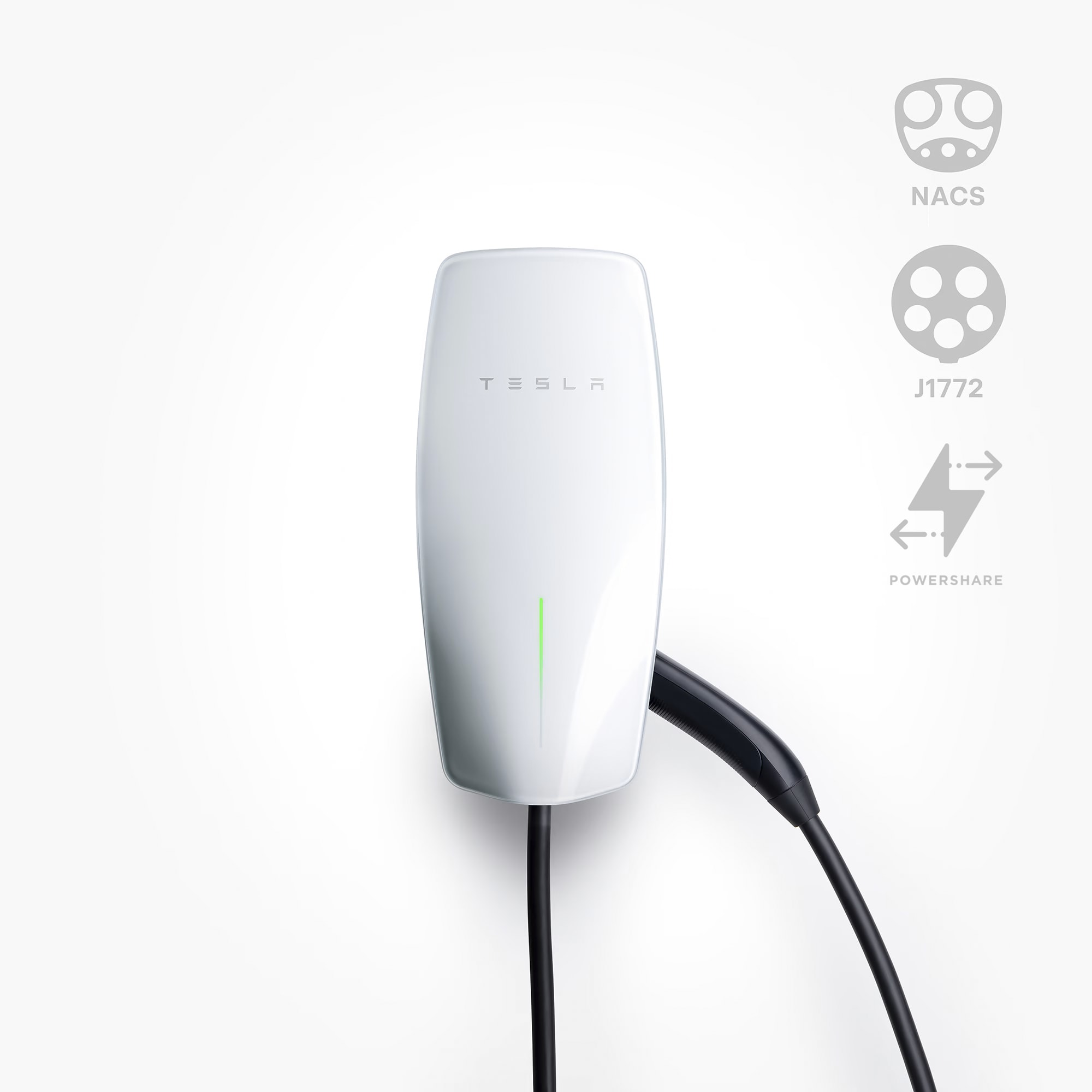

Mobile Connector: 32A on a 14-50, ~20 mi/hr. Portable, good backup.
Wall Connector: 48A hardwired, ~30 mi/hr (needs a 60A circuit — on a 50A you’re at 25).
Universal Wall Connector: same 48A, built-in J1772. Worth the premium if a non-Tesla ever parks in your garage.if you are thinking of using your CT as a backup power source, you will need the UWC along with the Power Share.

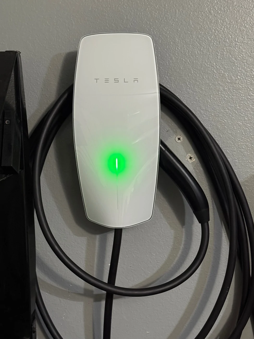

I just took out my 14-50 and installed the WC for my Model Y and the UWC for the CT.
I would gladly send you the 14-50 plug if you need it. I have no use for it.
I believe a lot of people have received a mobile connector which comes with 14-50 adapter plug. If I were you, I would keep it just in case you visit a rural area, like for camping at a national park or someone's house in the boonies with access to a 14-50 outlet.

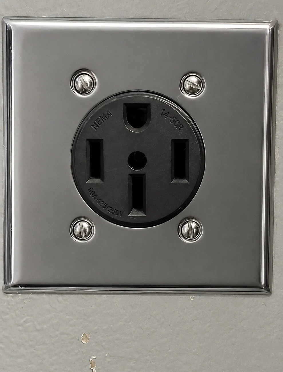

On the brand question, I think that’s about the outlet itself, not the cable. The cheap 14-50s aren’t made to sit at 32 amps for hours and they can overheat. Hubbell’s the one people usually point to.
I need to look what brand of 14-50 I have. I do remember I didn’t buy a cheap brand. Been using it since 2021.
Hubbell also makes Bryant and they are the same 14-50 sockets. But the Leviton and most of the other brands you will find at the local hardware store are not up to the task.

Third, the reliability of charging on a NEMA 14-50 outlet is limited by design and quality of the outlet your electrician buys. There is a $15 (Leviton brand) residential grade NEMA 14-50 outlet sold at Home Depot that is not sufficient to support daily vehicle charging. The Leviton outlet has fiberglass insulators that tend to melt out after a few months of vehicle charging. The outlets are not designed specifically for EV charging; they are designed for plugging in RVs and range ovens. Ranges will pull max power once in a while when we roast a turkey, but EV charging will be pulling maximum amperage for hours on end every night. For this heavy use, we recommend an industrial grade NEMA 14-50 outlet, by one of these three brands: Hubbell, Bryant, or Cooper. These use glass or ceramic insulators and should last 3-5 years before they, too, eventually need to be replaced. At $50 – $100, they are not cheap.

Given it's your first EV, you will see many different ways people deal with their charging situations. Some go for convenience, some lower cost, some in between. I think you need to assess your situation to figure out a few options first, then go with the one that makes most sense.
Here are my recommendations: I would NOT go with 14-50 route for everyday charging. Before EV, we didn't have anything that pulled 7.5KW or 9.5KW of power continuously for 10-12 hours. Yes, I understand the 20% debating, but why take a chance not knowing the type and condition of the existing wiring?
Also, absolutely do not trust those dryer plug switchers. There are no reputable brands that make them. Do they work? Sure. But are they reliable, who knows.
With a Tesla UWC, you have so many advantages. You can do scheduling, know everything about the connection on a phone, things like how many times the contactor was opened and closed. Not to mention, brand new circuit will give you peace of mind
You bought a CT, I would say go one step more and do it the right way. You will never regret installing a UWC, but you might regret not installing one.
I forgot one thing - check with your electric company, they might have programs that will make EVSE install cheaper by hundreds to more than thousand. I got two $500 reabates for both of my WCs and that basically made them free.

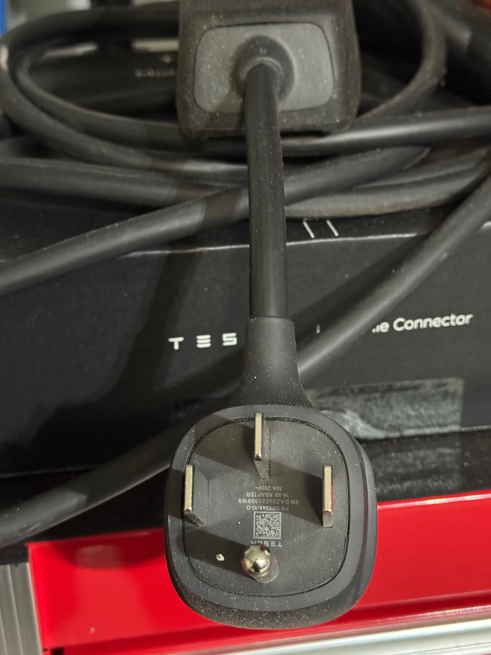

Tesla Mobile Connector still comes with 2 adapters: 1 5-15 (110V, 15A) and 1 14-50 (220V, 50A) - both derated 20% for continuous duty.
So, In the response that @Alpine posted on 14-50 outlets, it stated that the mobile charger adapters were not included with the vehicles. Does this mean that the mobile charger that comes with the vehicles does not include the 14-50 adapter, but it is included when you purchase a mobile charger directly? Can someone who has taken delivery of their 59k tell us what they got?
-CYBRG-
Jul 15, 2026
2026 Cybertruck
It's either the entire package (1 mobile connector, 2 adapters) or none. Some had this in their trucks, some didn't.
The three times that I did CT demo, they all had brand new mobile connector box (including adapters) in the vault of the bed. The base CT that I checked out at the service center also had this box on the floor behind the driver's seat.
All Teslas in the USA used to come with J1772 to NACS adapters. Then, there are municipalities that have additional regulations for EV manufacturers. For example, in some parts of California, Tesla includes CCS1 to NACS adapters to meet local / county laws.
So I'm guessing, in some areas Tesla includes the mobile connector. But if they do, it's the entire package - 1 connector and two adapters.
Tesla does sell various other adapters for the mobile connector. Dryer outlet is NOT 14-50. That's 14-30, and 14-30 adapter you'll have to buy additionally. May be people are confusing the two.

There should only be 2 options for home charging your Tesla or any EV:
(1) Tesla Universal Wall Connector - Powershare future proofing (+$65 well spent)
(2) Tesla Wall Connector - if you never have a need for Powershare and have to save $65
Will a mobile connector on a NEMA 14-50 work? Sure but if nothing is there already, go the Wall Connector route, you'll thank me later.
In Oct 2023 when we bought our first Tesla, Model 3 RWD, it came with no mobile connector and after running the numbers of installing a 14-50 vs a Wall Connector, the latter was an easy decision based on overall cost, ease of electrical wiring and code compliance. My only regret was that the Universal Connector wasn't available at the time ($100 difference in 2024) and I was limited in the location I could easily place the charger in the garage. With my install, I have to back in the Model 3 parked on the left side of the garage to reach the Wall Connector, right side Model 3 can be parked straight in.
Here are my parts cost to install the Wall Connector, no labor included since I did it myself. My breaker panel was not in the garage, hence the 30' of wiring. All parts costs have increased since 2023, though breakers have come back down in my case.
