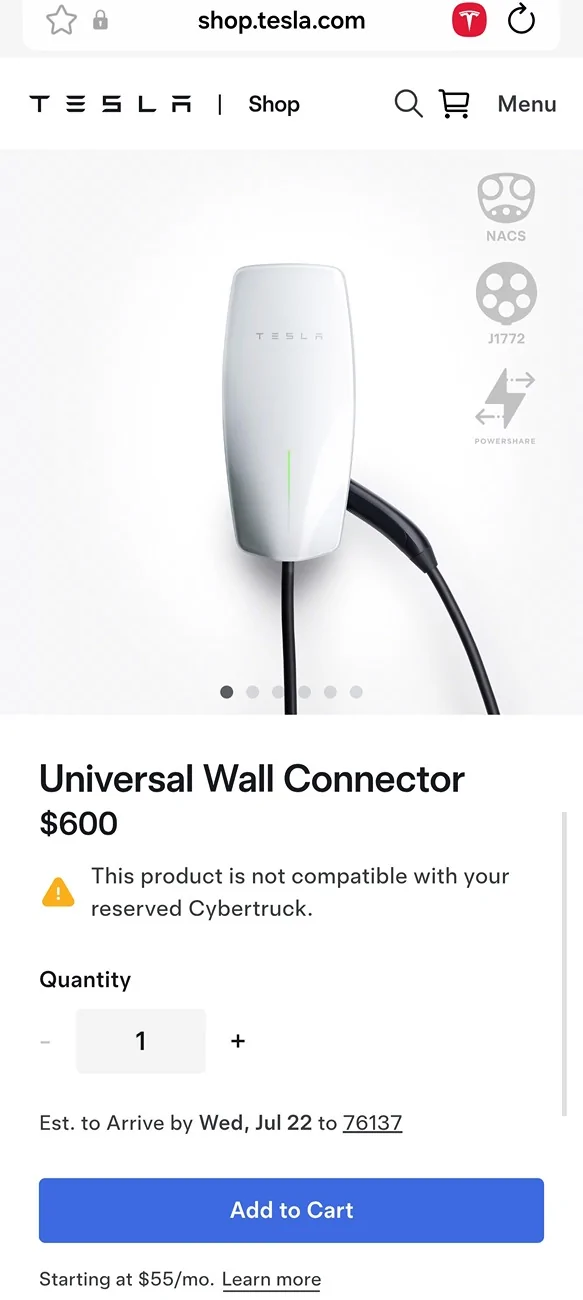

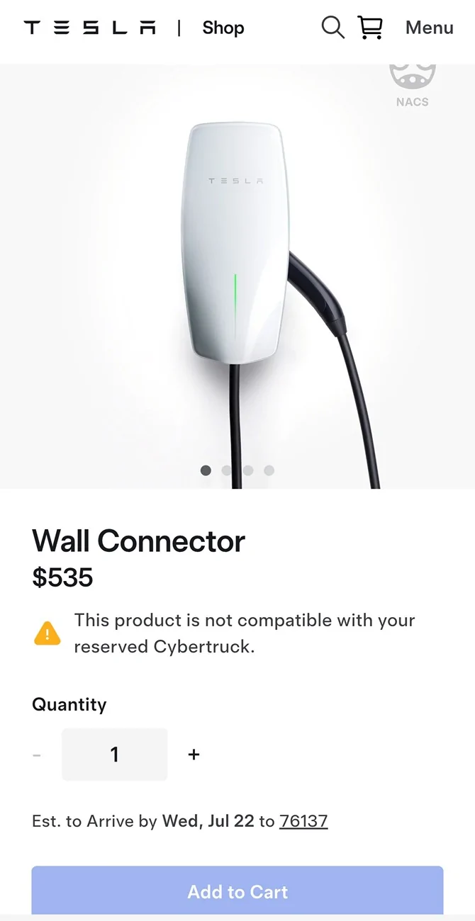

Im a first time EV buyer so my account is blank. I haven't purchased anything.
Well oops, says the same thing on the universal charger but I clicked on it and it will allow me to purchase it even though I get the same message that its not compatible
The regular charger i cant even buy
Ok - it's what I thought. Tesla shop usually checks to see if the item you are looking at is compatible with any of the vehicle in your account. If there is one, it says it by name. If there are more than one, it says "not compatible with any vehicle in your account". It doesn't count order / reservation.
For just $65 price difference, you definitely want to get the Universal Connector. It's the only one compatible with powershare feature of your CT.
