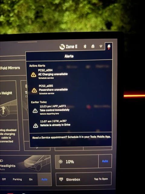

Noticed my CT wasn't charging last night. Went out to see what was up and saw two alerts on the screen PCS2_a094 & a095. AC Charging and Powershare issues. I don't have PowerShare set up and haven't used that before at the house but my level 2 is not working to the vehicle. I have scheduled a service and the earliest here in the Bay Area is March 4th....CRAZY. Wondering if many others are having same issue and that is the reason for long wait times getting into any service center?? Grok says many CT owners are having the same issue following the last software update. I am going to try a super charger today and hope I can get some juice there.
Got my update last night. Same issue. AC unable to charge.

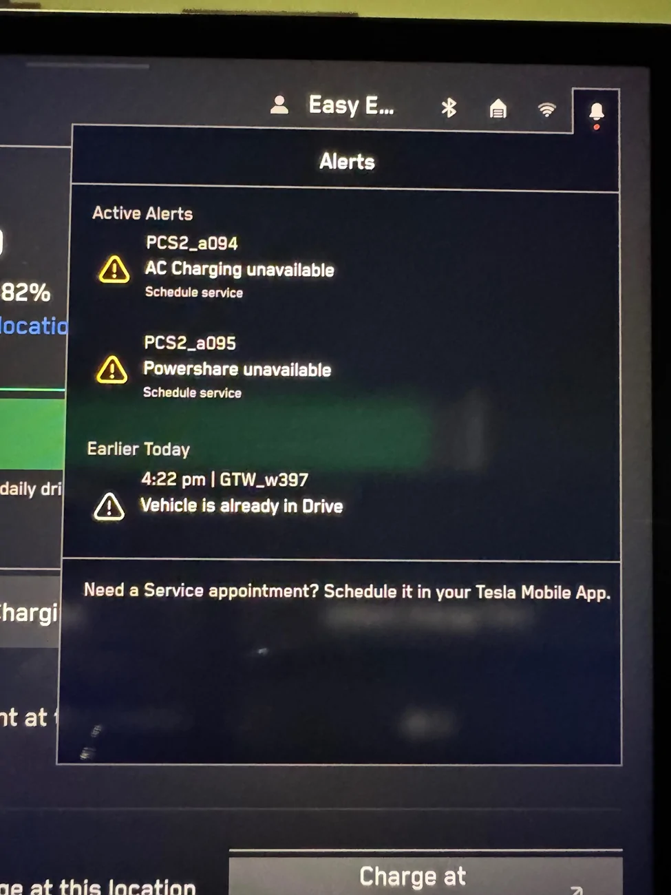

I had a service request for April 6th for the darn windshield wiper, which is now dry wiping (only on FSD) so much it’s scratching my windshield. I keep it as clean as I can along with windshield. Anyhow noticed the PCS2 thing on my work order. I trust that it’s necessary and didn’t given another thought. UNTIL tonight stopped charging at 77%. Went to go look at CB and there it friggin’ is! Latest update? Tesla OKC has notified me they won’t have wiper or other part until April 13th!! What the hell is happening. Home charger at 48. 19k. 2024 Foundation. Someone please reassure me at some point our CT’s will be 100%, nothing else goes wrong and maybe we’ll get lucky and get an “I’m sorry” via Elon and we will finally get ActualSmartSummon! I can dream, can’t I?

I know the feeling. My experience was surprisingly VERY GOOD. Had about the same charge amount and service request said over a month to get me in but when I called they said bring it in as soon as you can and we will check it in and give you a loaner. This was on a Wednesday, by Friday the app said your vehicle was ready for pick up. I also had the wiper blade replaced while it was there. I have AWD FS and charge at 48amp. Hope you get the same turn around. Tesla knows of this issue and it seems like they are proactively pushing the part out to the service centers.
