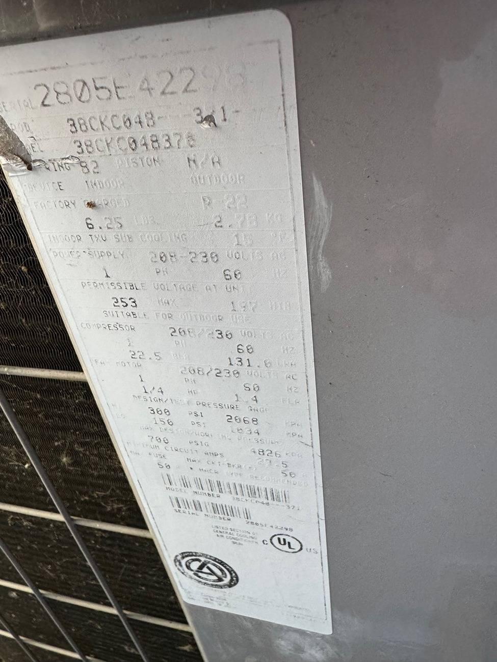

I believe mine is LRA 82, but the AC is pretty old and the label is really worn so I cant be sure. I asked installer twice and he said his boss stopped by and said it would not work. I told him to just do it and Ill install softstart at the later date, but he said no and he needs to protect the system. I decided not to push it. There are total of 12 spaces and AC breaker would take 2 spaces. So I decided to pass at the moment and connect some other breakers. They were not able to finish because I could not connect the charger to the WIfi so they are coming back.
Is the unit old enough to consider replacing with a mini split system?

It is old, but while it works I will keep it
