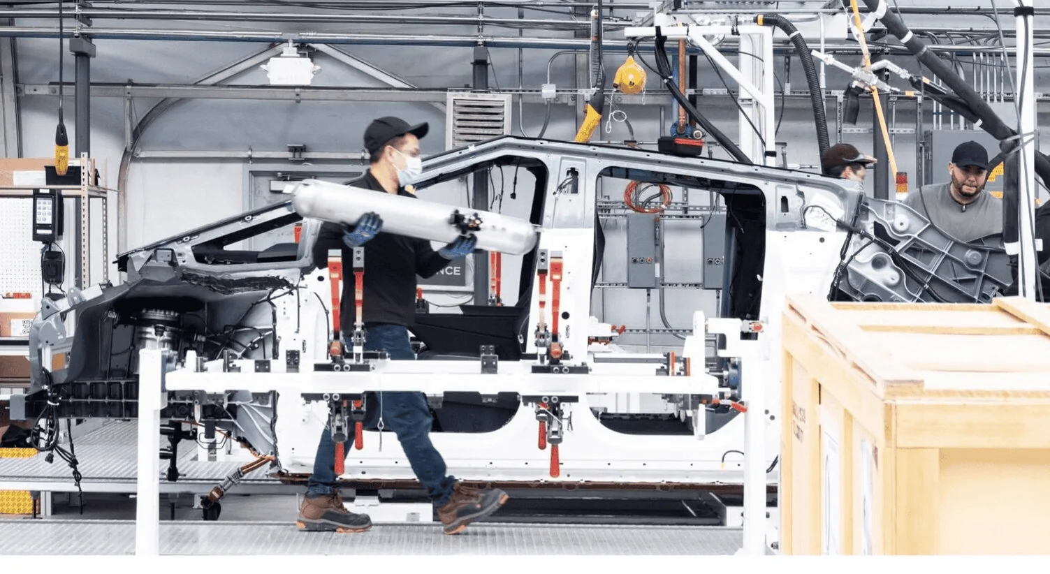

This spring we saw a photo of a Cybertruck team member carrying what is almost certainly the air tank that will support the needs of the air suspension. Judging by the size of it, the air suspension will have substantial capabilities and need a compressor of suitable size and duty cycle to deal with that. Auxilliary air needs are when the truck is parked, so it shouldn't affect the duty cycle too much, as long as the air tap is used for the intended purposes, nothing more demanding than filling a tire or adjusting the tires pressure higher.
Tesla Cybertruck Air compressor hose connection? 1699927233587
That looks to me like it holds about 5-6 gallons. Let's be conservative and say 5 gallons. Atmospheric pressure is a bit under 15 psi. Boyles Law states that when pressure is doubled, volume is halved. That means at 120 psi a 5-gallon tank can hold over 8 times as much air, or 40 gallons of air when that air is at atmospheric pressure. In all likelihood, the pressure will probably be around 160 psi to support the air suspension. This is enough to seat the bead on a large tire like the Cybertruck has, even though it would require the compressor to cycle to complete the job. And that is not even the likely intended purpose. Airing up all four tires after off-roading might be accomplished even if the compressor was turned off before the process was started, depending upon how low of a pressure they were aired down to.
The Cybertruck will be able to monitor how much air is being used by the suspension (simply by monitoring the tank pressure during suspension adjustments). It can also monitor how much air is being used by the owner and regulate that as needed, to ensure the on-board compressor isn't abused for unintended applications. It's likely to also have a thermocouple on the compressor cylinder to auto-shut-off if there is an over-temperature situation. The one item I think would be good to support a user air tap is an electrically operated valve to shut off that tap if it detects a leak while driving (air pressure declining while not operating the suspension) or excessive usage.
