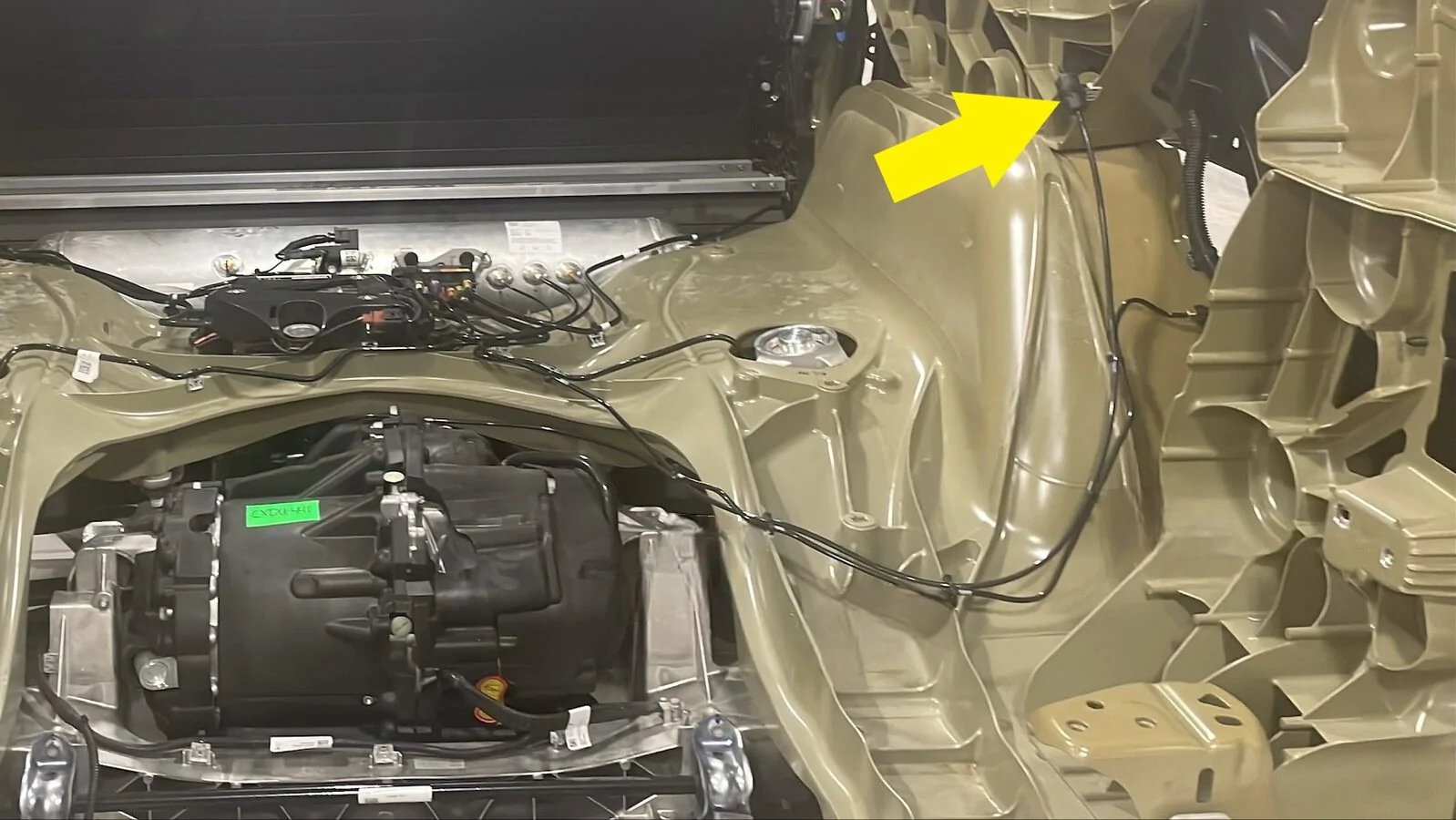

Open system
120 psi shop air is only 8.2 bar, system refill is 18 bar or 261 psi so high pressure nitrogen tanks are used to quick fill the system after servicing.
In operation, it pulls from ambient air here:
Tesla Cybertruck Air suspension fails. Second Time in two years! GUID-060E32F9-F8E9-4156-890F-C405DEAA00E7-online-en-US(2)
