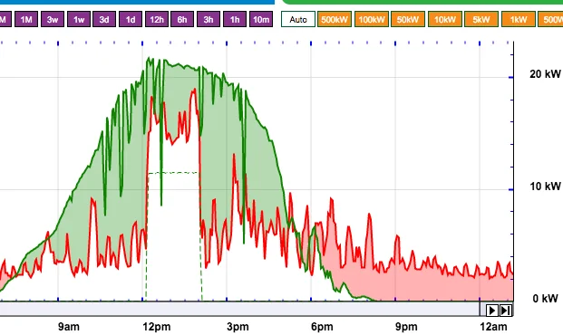

In a typical installation your house will be connected, via a transfer switch to either the utility or the generator - never both. The solar system's inverter(s) will be connected to the utility side. When the utility goes down the generator starts and the transfer switch throws. Your house is disconnected from the utility and the solar system. If this happens in the middle of the night while your truck is charging the charge will be interrupted when the power goes down. The generator will wait about 30 sec before starting and after a couple more seconds, when the generator is up to speed the transfer switch will throw, the truck will sense normal voltage and the charge will resume. The THD from your generator is good enough to run the appliances in your house and good enough to charge your truck (I don't think your truck even cares).
When the utility is up it doesn't matter when you charge. If the solar system is producing then energy from the array will go to the truck to the extent that the array output can meet the charging load and any short fall will come from the utility. Assuming you have 1 for 1 net metering and flat rates (a kWh is x ¢ any time of day and you get a credit of x ¢ for each kWh you send the utility) it doesn't matter when you charge. If the rates are time adjusted then it gets more complicated but it's probably not worth long nights with the Excel Solver trying to figure out the optimum strategy. If you drive the typical 10,000 miles a year that means about 5000 kWh electricity used which, at 10¢/kWh is $500.
Now if you want to be able to boast "My truck runs on fusion." or "My fuel cost for the truck is nothing per mile" then you want to see to it that your truck charges exclusively from the sun. To do that obviously you have to charge when the PV array is producing and you have to set the truck's charge rate to less than the array is producing. It looks like this.

Charging started at a little after noon at the maximu 11.5 kW. As the solar system was producing over 20 kW for most of that time and the total load, including the car was always less than that all the energy going to the car has to have come from the PV array. Exception was the brief interval at about 12:30 when a cloud went over and production dropped to 8 kW. In that interval some of the energy going to the car came from the utility.

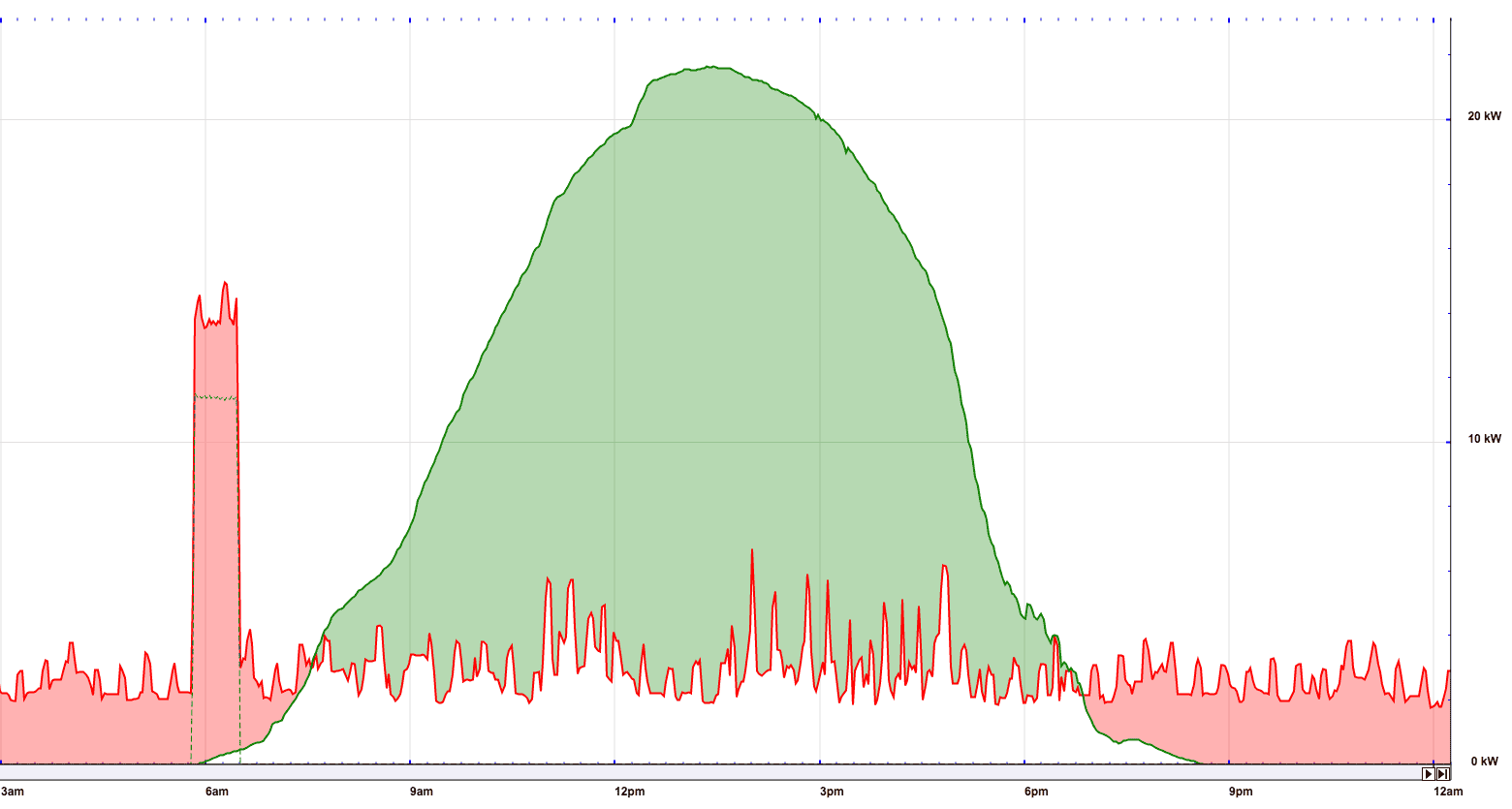

Yes, our standard rates are 10 cents/KwH. Sometimes only 5 cents. June through Sept it goes to a demand rate for 5 hours per day only.
Do make sure you understand exactly how your tariff reads on this. Demand chargers ore based on the notion that while you may have an average demand of 4 kW if you ever draw 40 kW the power company must be able to provide that 40 kW and should be compensated for 40 kW service. For example my Jun electric bill showed that, net, I sent the power company, 2138 kWh. IOW I took no power from them. Looking back over the month I see this for the 17th:
Tesla Cybertruck All electricity equal or not? Demandch
We were heading out to the lake that day and so at a little before 6 AM I decided to run the SoC up to 90% for the trip and charged 7.4 kWh at the max rate (11.5 kW). The PV system was producing a paltry 300 W at that time and so most of the entire load, car and rest of the house, came from the power company. This was the most I drew from them in the entire billing period. The 30 minute average from the start of charging to the end of the highest bump on the top of the pedestal was 13.7 kW and my bill lists "Demand 13.2 kW". Note that's kW, not kWh. They have the right to charge me a lot for those kW. I don't remember what it is but they aren't charging for it. This may be because of new pro-solar laws passed here (Virginia) recently. If they charged what the old tariff allowed demand charges could be a major factor in my electric bill. Hence my advice to you to be sure you understand what your utility will do in this regard and takes steps to dodge demand charges when and if they are in effect. In Virginia demand charges were an attempt on the part of the utility to discourage solar installations. It sounds as if in your are they are intended to relieve demand during the "duck neck" part of the day.
The picture makes it clear that one way to dodge demand charges is to defer charging until later in the day i.e. dip into the abundant 161.4 kWh (I think that's my max ever) of solar collected on that day. Couldn't do that on th 17th as by the time the sun got cranking we were on the road. As the picture shows the solar could easily handle the Tesla and the house load with 5 kW to spare. Another strategy is to charge at lower than the maxiumum rate i.e. at 5 or 6 kW rather than 11.5. I tend to do that anyway reasoning that it's easier on the battery and I'm not in a hurry (unless leaving on a trip where, as we have seen, I just crank it back uo). If the demand charges are in the afternoon and there is a discount at night then charge at night.

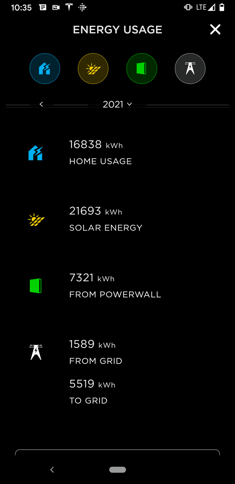

Tesla Cybertruck All electricity equal or not? Screenshot_20210808-070243

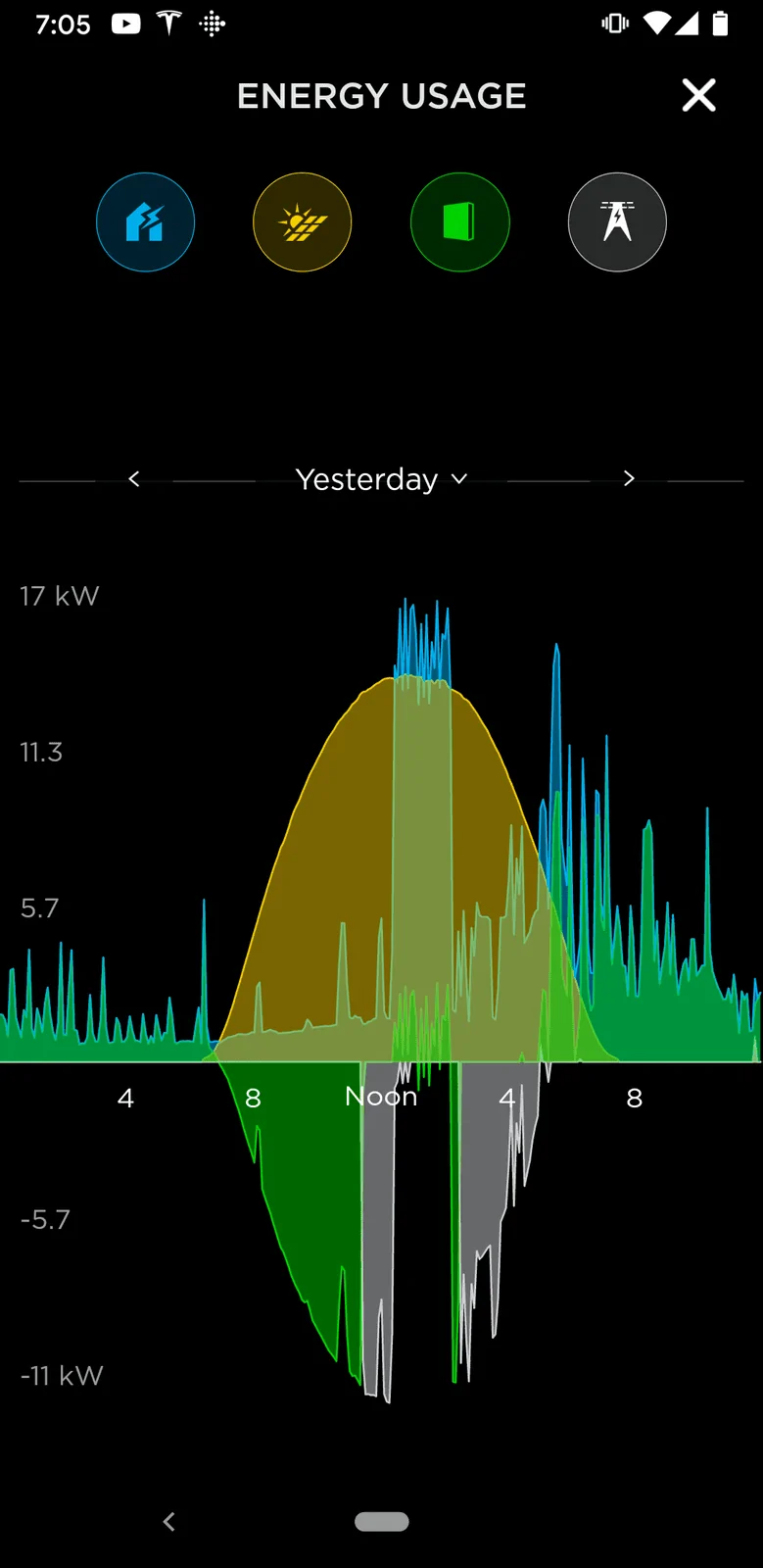

In all seriousness though. I haven't used the grid significantly in almost a year. I only charge at home. One day, energy will be solved, and it won't be with big power plants or generators.

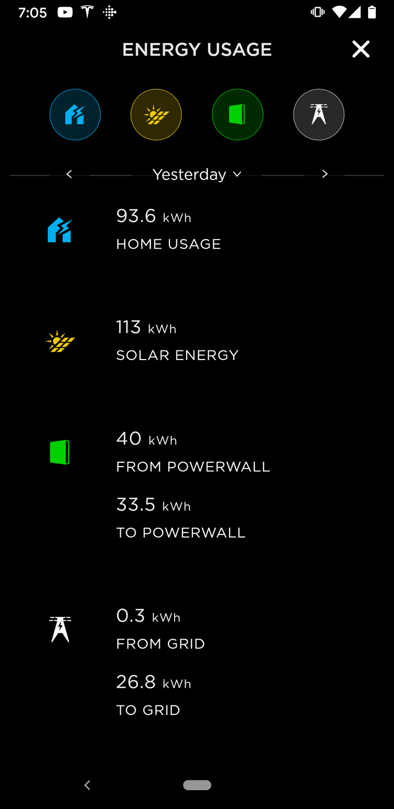

This was yesterday with about a 40% charge on my model 3 long range.
Tesla Cybertruck All electricity equal or not? Screenshot_20210808-070548
Tesla Cybertruck All electricity equal or not? Screenshot_20210808-070558

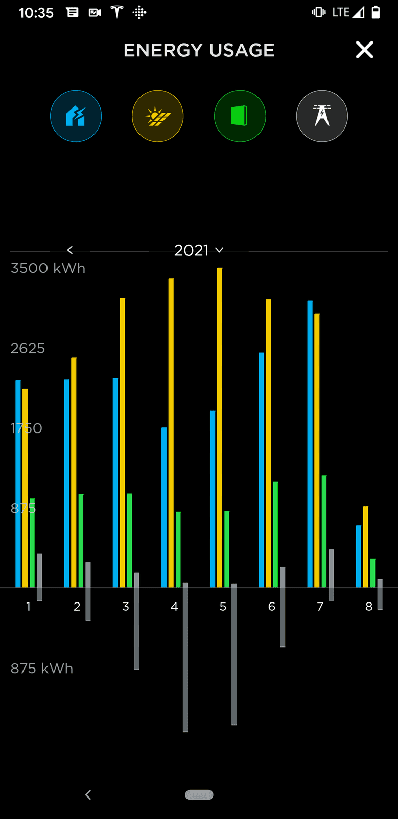

To get to your question: Without the EV charging, I would be more than able to power my family's home indefinitely. When I put 60kwh / day into the car, however, not so much. But even with the car, I would have no problem without the grid as powerwall automatically reserves 50% (it's a setting) for my home use in the case of a grid outage. Meaning, if I have no grid and I plug in my car, it will charge until the batteries are at 50%. Half of my powerwalls easily covers us for 2 days and a single sunny day can recharge from 0 to 100. In that event, no long road trips.
According to the app, the longest I've gone without power is 350 hours.
Since I do have the grid, I do use it when I need to charge the car a lot.

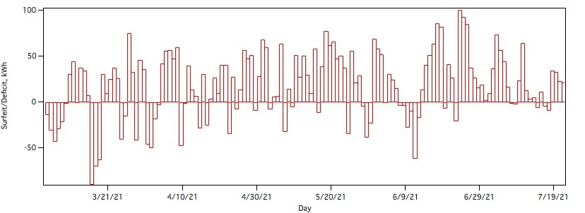

On average (if there is such a thing) , how long would a typical powerwall setup supply non rationed power to a "typical" home during a prolonged outage? 24 hours? 48? 72? A week?
I realize there are multiple variables.
I think you realize that this is an impossible question to answer. It depends on how you use electricity and on how mother nature supplies it to you. If you live in one of those all too rare places blessed with nearly continuous sunshine and modest seasonal demand variations it's not too hard to design a system that will supply power indefinitely most of the time but even in those places statistics will eventually catch up.
Think of a can with a tap at the bottom from which you draw water as you need it and which is filled (bt yy rain) at the top. You are asking how long is it before the can is empty. That depends on how fast the rain fills it and how fast you draw the water from the top.
As I can't answer the question for your particular circumstances the best I can do is present example data and let you draw your own conclusions. The following picture shows by how much solar production exceeded or fell short of demand at my place over the last few months.

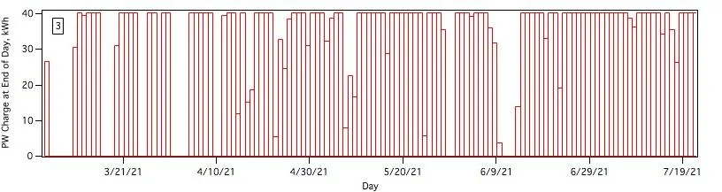

The next picture assumes I have 3 Powerwalls and shows how much charge would be left in the bank at the end of the day

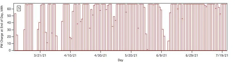

And this last one shows the same thing assuming 5 Powerwalls
Tesla Cybertruck All electricity equal or not? 5PW
When the bar is at 0 that means your Powerwall bank is fully discharged. As there is no utility, the Powerwalls shut down until enough sun returns to recharge them.
Perhaps rather than asking how long the system will run before discharging you should ask how many shutdowns are typical in a given time period. For the period shown in the pictures here there were 7 shutdowns with 3 Powerwalls and 4 with 3 in this 5 month period. We'd have to install 9 to get down to 3 and a whopping 17 to have no failures.
If I gave data for the 5 months around December the results would be very different as my demand is higher and solar production lower.
The message is that it all depends on the statistics of insolation in your area, the statisitics of how you use power and how many shutdowns you are willing to tolerate. And your goal in doing the analysis is plainly to determine how many Powerwalls to buy (not that Elon is actually selling them).
