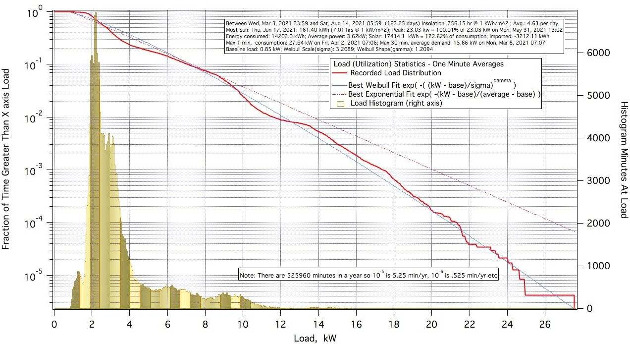

A little arithmetic: A 4 ton A/C is going to pull about 4 kW. Each fully charging BEV is going to pull 11.5kW. Thus a 20 kW generator is not capable of running the A/C and charging to BEV simultaneously but it is capable of supporting all three of those if you manage the loading on it. I've said earier in this thread that you don't want to charge BEV on a generator unless it's absolutely necessary because the cost of a generated kWh is usually several times the cost of one bought from the utility. The same goes for other large loads such as clothes dryers and electric ovens. Avoid using them when the power is out if you possibly can. This is especially important if you are on propane as the events that cause prolonged power outages may prevent the propane truck from getting out to you to refill your tank.
I thought I'd gotten into load management in this thread but it must have been somewhere else. Deferring laundry, using the barbecue instead of the oven, charging one BEV at at time are all examples of load management. You can even handle more than one air conditioner if you have a proper load management system in place. This is a system that is usually a part of the transfer switch that measures the generator output and, when it gets high, starts to turn off loads in order to keep the generator load at about 80% of capacity. For example, if you have two A/C connected and they both come on the load management system senses the current rise and shuts off, say, the clothes dryer. If the clothes dryer was running and that reduces the load enough then both A/C continue to run. If the clothes dryer was not running then disconnecting it obviously doesn't help and the system shuts off another load - perhaps one of the A/C. When the remaining A/C has satisfied it thermostat it shuts down and the system senses reduced load and puts the second one back on. The order in which loads are shed is set into the system so that, for example, the main house A/C takes precedence over the one that serves the mother-in-law suite.
Fairly recent changes in the NEC WRT generators have made automatic load shedding systems common. A generator must be capable of serving all the loads connected to it. The goal of shedding equipment is automatically insure this.
The obvious question is "how big a generator should I have". It should be obvious that this depends on how you use electricity. To determine that you need to monitor your usage for an extended period, create a histogram from the logs and from that prepare the complementary cumulative distribution function. Now I don't expect that anyone will be able, prepared or inclined to do this but bear with me for a moment. The graph below shows such a histogram going back to March 3 of this year. Mean consumption was 3.62 kW and this implies an average demand of 86.8 kWh per day which, while it isn't Al Gore, is about triple the average American household's use. The house has 400 A (96 kW) service and based on this I bought a 48 kW generator (200A). Was that smart? No, it wasn't, because the cumulative frequency curve shows that I never used more than 27 kW and used more than 25 kW less that 0.00001 of the time which is 5 minutes per year.
Tesla Cybertruck All electricity equal or not? Loaddist
Suppose that instead of a 48 kW generator I had chosen a 20 kW unit. My usage history shows that I use more than 80% of that (16 kW) 0.002 of the time so that during a 2 week outage I would have to shed something for a total of 14*24*60*.002 = 40.32 minutes or 24*60*.002 = 2.88 minutes per day. I don't think having some load or other shed for 3 minutes each day is so burdensome and so think that in fact a generator capable of 16 kW at 80% load (20 kW machine) would have, based on this chart been fine for me.
All that's dandy but if you don't have the historical data, how do you pick a generator size? You do, in fact, have some historical data and that is to be found on your electrical bill. As the picture above shows a demand pattern depends on three variables: a baseline load which is present 99.9% of the time on top of which there is a varying load which follows a Weibull distribution quite closely. The history shown by the heavy line is approximated well by a flat line up to 0.85 kW (the baseline load) and, above that, by the thinner blue line described by exp( -((kW - base)/sigma)^gamma) in which base = 0.85 kW, sigma = 3.2089 and gamma = 1.2094. Note that if gamma = 1, and the actual value is close, the distribution is a simple exponential with scale parameter sigma = (average - base) and
exp(- (kW - base)/(average - base)) then gives the dashed curve shown on the plot. This can be solved for the load for a particular desired fraction as
kW = (average - base)*(-2.303*log(f)) + base
With the observed average of 3.62 kW and a baseline of 0.85 kW for the same 0.002 fraction we'd have (3.62 - 0.85)*(-2.303*log(.002)) + 0.85 = 18.0676 kW as 80% of the generator capacity requiring a 22.4 kW machine.
To estimate the size of the generator you need go to your electric bill and find your total consumption for a year (kWh). Divide this by (365*24) to get the average kW/day, Now look to see if there is seasonal variation. If there is find the part of the year with the biggest demand and calculate the daily average for that period. While my last 143 days have averaged 3.62 kWh/da in the winter the average goes up to 4.91 kWh/day Putting that into the sizing formula we get 1.25*(4.98 - 0.85)*(-2.303*log(.002)) + 0.85 = 32.9387. Of the B&S Fortress generators I was looking at (1800 rpm = quiet) I chose the 48 kW model when it appears the 35 kW model would have been fine. I have never had a shedding incident and never observed generator load greater than 16.5 kW (47% of a 35 kW generator). Not surprising as loads that big occur anout 0.2% of the time and the odds of that being during a power outage are small.
