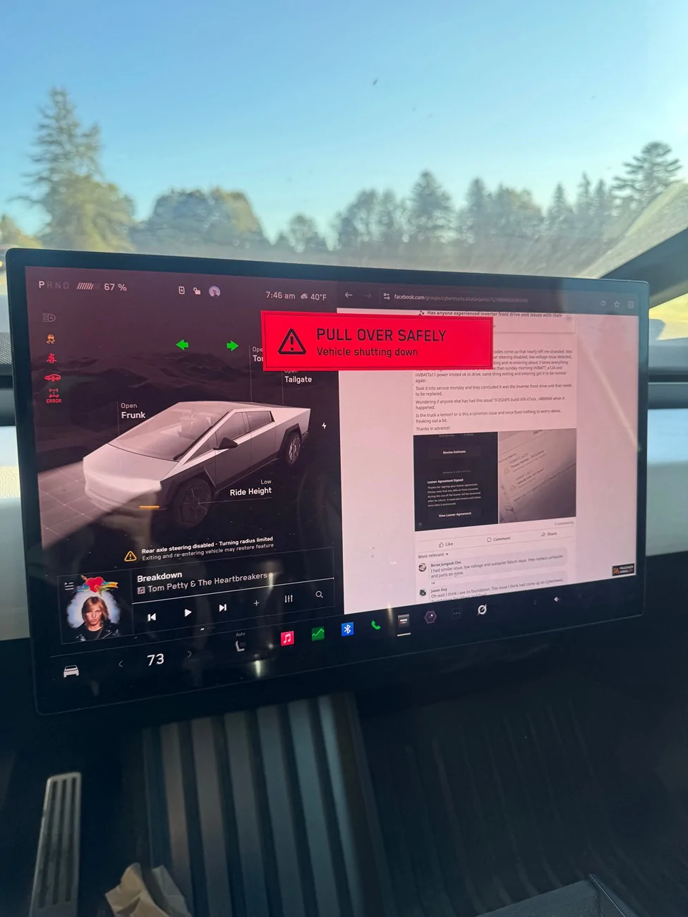

Idk but similar happened to my vin 5611
Tesla Cybertruck All of the (warning) lights! IMG_6173
I’m starting to lose faith in the platform.

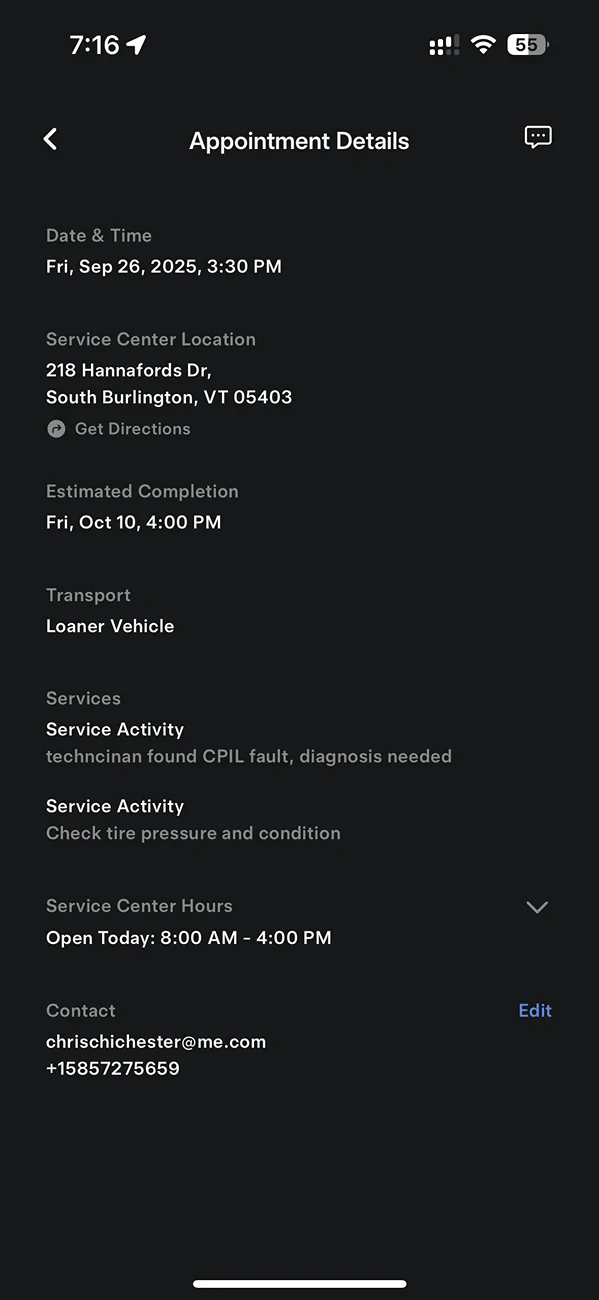

They replaced a rear drive unit twice on mine. That was like 20k miles ago.
then they replaced the PCS and just today finished the HV. It’s like they keep breaking stuff as they fix
