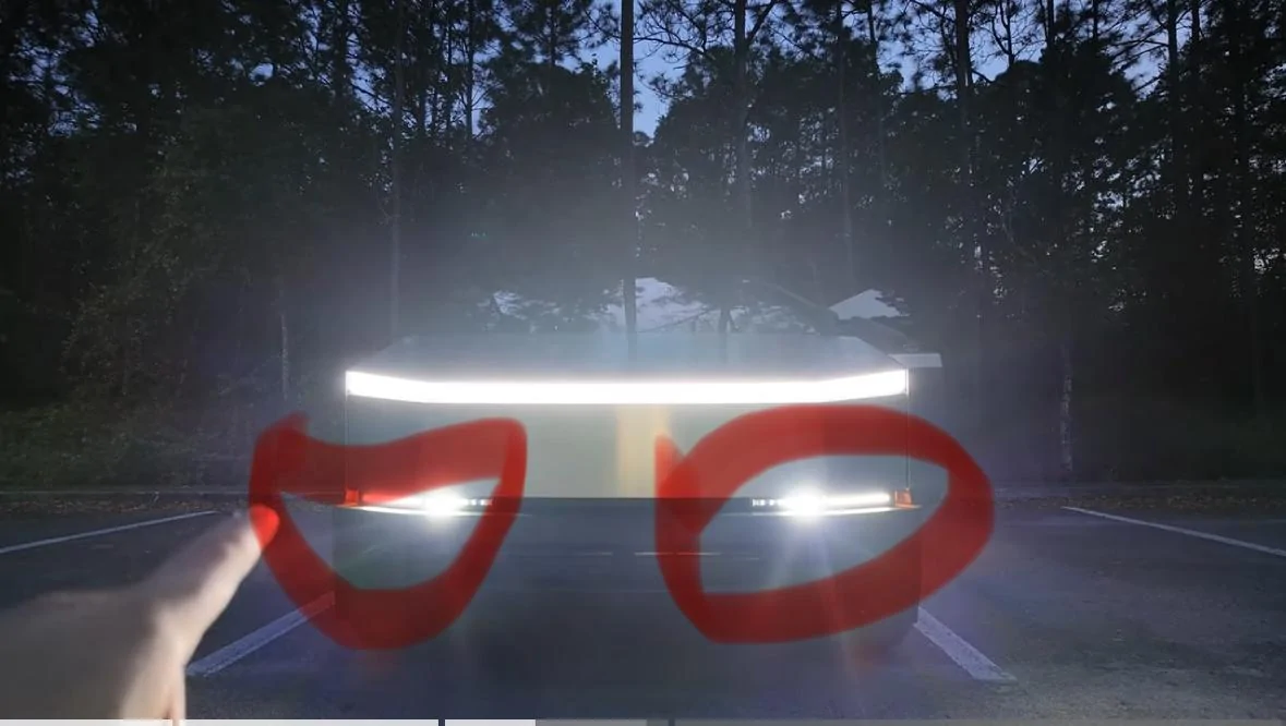

Are you sure it isn’t because of the fog lights? I’ve seen two CTs driving with their fog lights on and they are horribly angled and 100% blind oncoming traffic.

I thought the lights below the light bar are fog lights as usually that’s the case. Either way these are really annoying to oncoming traffic. Something about them aren’t pointed right.
Those are the headlights.
Light bar doesn't project light over a few feet in front of you, it's the daytime running light.
oh learned something new lol
Then yes, it is the headlights that are terribly angled from the factory then.
They are not fog lights, they are headlights. And their aim is adjustable from the center screen.

You could adjust the angle of the lights and lower the cut-off. It's a setting on the touch screen. I have read some owners received their trucks with it set too high.
mine was set too high also. It took a while to get them set right, but I was guesstimating by pulling up to a building on what I thought was flat ground but when i got out on the highway it was still too high. I finally have it set right.
