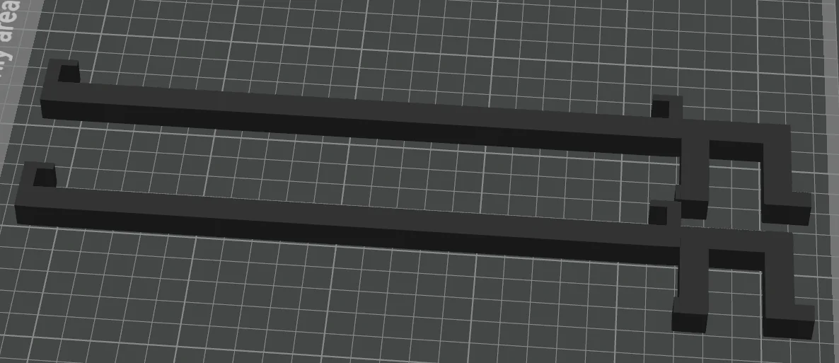

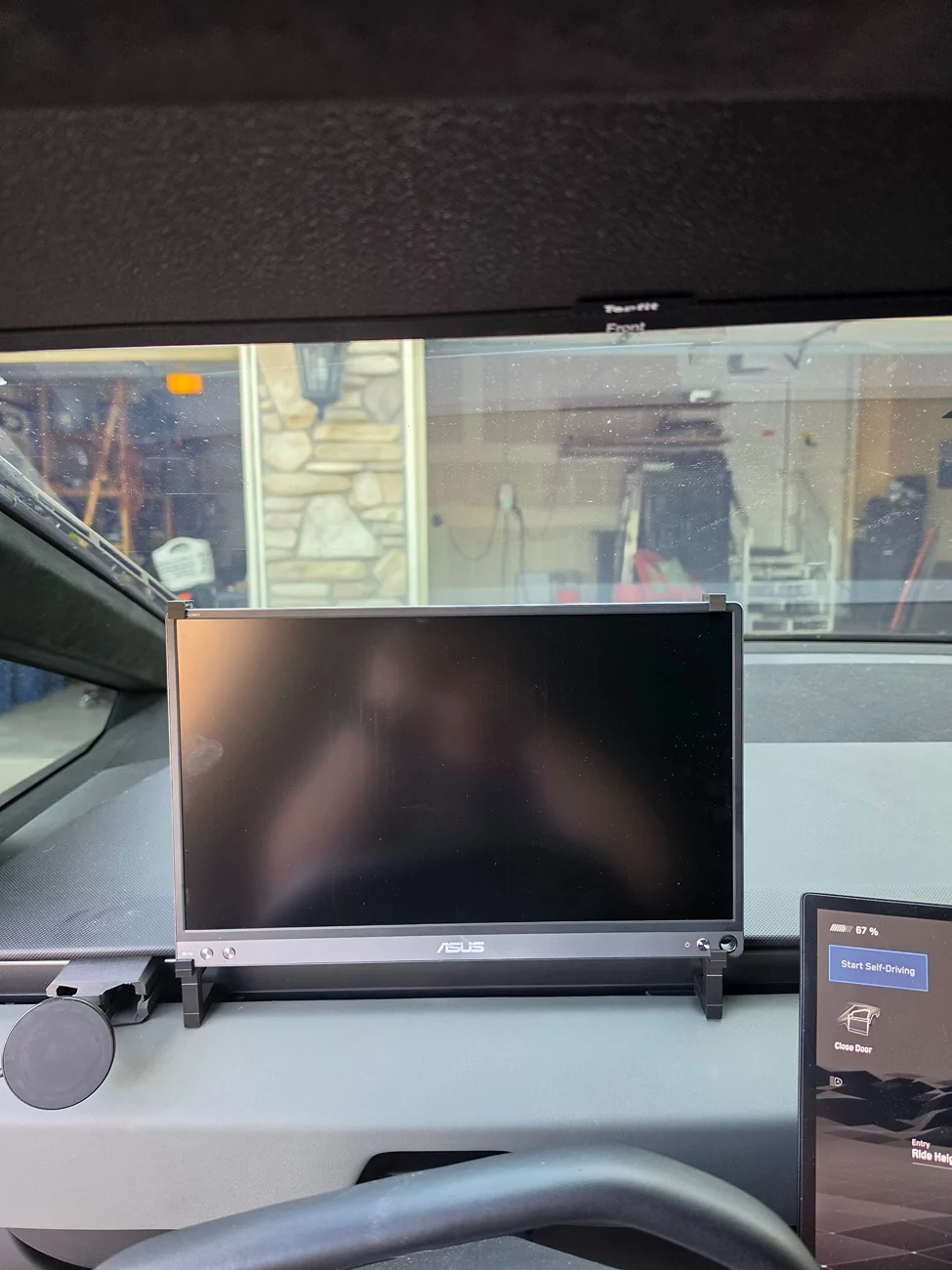

Have V1 of the monitor mount printing now. Very rough but the test fit was perfect. I am, however, second guessing the screen size. Granted I had the seat in the lowest setting so maybe once my driver's profile loads it won't be so bad. I wanted the monitor a bit higher so it wouldn't block the vents.

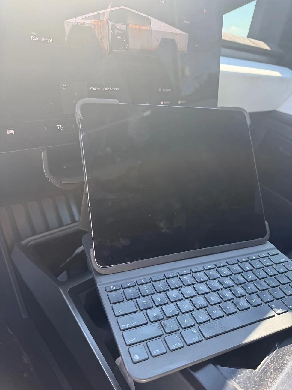

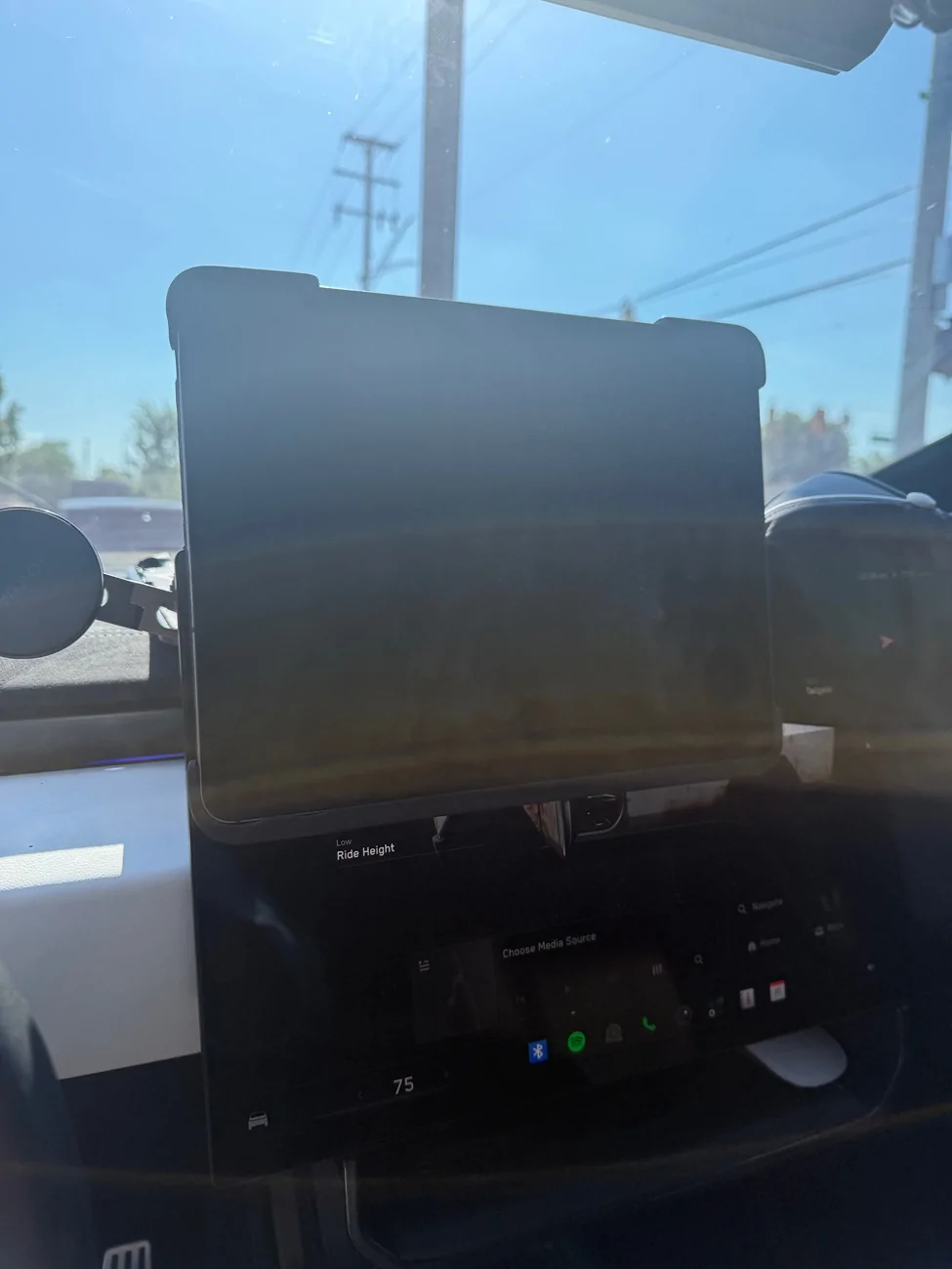

If you get the right Logitech case the iPad fits perfectly over the screen. I use a blue tooth key board and mouse and can flip it out of the way to see the screen with the touch of a finger. It’s like a workstation on wheels. And easy for passengers to see.

Fit came out perfect. Doesn't block the vents at all which is what I was going for.
I would want something about 1/2 to 2/3rds this height as IMHO this blocks too much of the forward view especially of the road ahead at a distance. What is this screen connected to and what are you showing on the screen? I have that 10.88 inch screen that I installed recently as a secondary screen to show info about the truck but sadly the maker doesn't have a Cybertruck to probe for signals so a lot of features are missing or don't work correctly. I have one on my Model 3 that is great. About the only use I have for it in the Cybertruck is to run Waze when I am on trips but I don't run Waze on a daily basis, maybe I'm weird that way.
Kudos on the bracket that is a good solution for allowing air and still having a screen. I'm assuming you'd just adjust the height in your 3D printing software for a shorter screen. Looks promising for sure. I know the person who has the first truck like mine has a shorter and longer screen in his truck that he has tied into some sort of portable PC that sits down in the center column area. I need to read the rest of this thread and see what you are connecting this to. :)

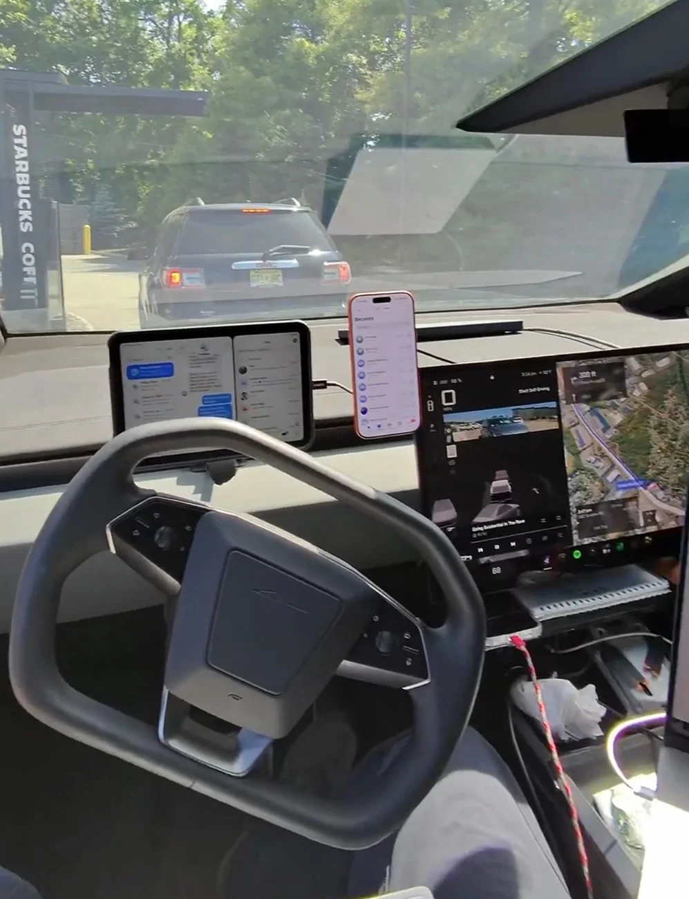

I have done something similar to this, where I mounted an iPad Mini to the dash so I can still see completely through. I also have a Bluetooth keyboard and mouse that I use. I stream my laptop to the iPad while I'm driving. It works quite well, but it is sometimes annoying to set up and get going. Once it's going, it's pretty fluent. The only other thing I would say is that it's very distracting to run that setup. Lately I just use my iPad Mini as kind of a dashboard for seeing my daily actions, where I'm not doing too much production on it until I get to my next destination, just for the simple fact of safety.

I'll just be using a laptop that supports display port alt mode. Then use my wireless keyboard and mouse. So I'll be running Windows 11 on it. I do a lot of driving with my job and am significantly less productive somedays due to being on the road. I've tried dictation software but find I spend just as much time correcting everything after the fact. After using my laptop side saddle for a bit, I found i was getting more work done while on the road. However, fsd nagging me was interrupting my flow.
I'm 5'10" and have the seat to the highest position. Drove around a bit today. The height of the screen does take some getting used to, but I can see cars in front of me without issue. Would I go with a smaller screen? I don't know at this point. It's very light weight, but you're right, I'd be able to adjust the mount pretty easily if I wanted something smaller. Getting it to fit firmly in the dash was the trickiest part, but everything else is simple.
