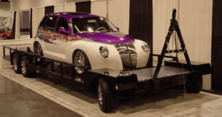

The 30,000 Lbs. Solution
Tesla, Presently, does not have a fully functional, light to medium capacity Trailer design division, and with the introduction of the CyberTruck, I believe it is the most opportune time to bring in the New CyberTrailer with self-steer system equipped trailer, as seen below. The image below was changed to illustrate the optional Self-Steer system explained below.
Tesla Cybertruck Article: Tesla advertising Cybertruck can pull “Near Infinite Mass” — What Does That Even Mean? 1680226950045
Please visit my YouTube “getafix56” channel for an old design from 2002 example of Front self-steer system in action.

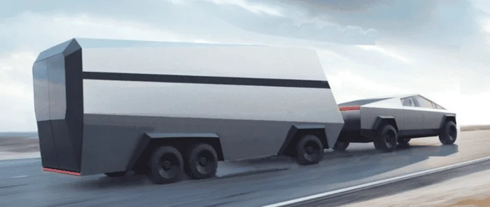

The question to answer is “ How can we make the 30,000 Lbs. towing by a CyberTruck a possibility, and also improving the towing efficiency?”

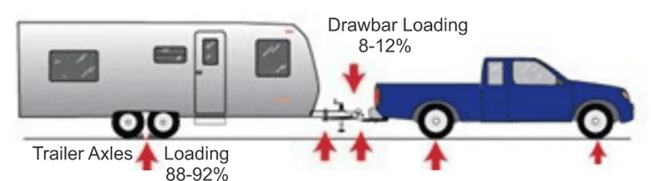

The most common Tow vehicle/Trailer combination, below, shows that most general-purpose trailers loading, consist of a load bearing axle or axles located on the trailer to carry ~ 88 to 92% of Gross Trailer weight rating (GTWR), while 8 to 12% is tongue loading. This is carried on the Tow vehicle hitch. The added hitch loading is passed on to the vehicle’s rear axle loading, robbing it from useful vehicle payload.
Tesla Cybertruck Article: Tesla advertising Cybertruck can pull “Near Infinite Mass” — What Does That Even Mean? 1680227140388
Tesla Cybertruck Article: Tesla advertising Cybertruck can pull “Near Infinite Mass” — What Does That Even Mean? 1680227172835

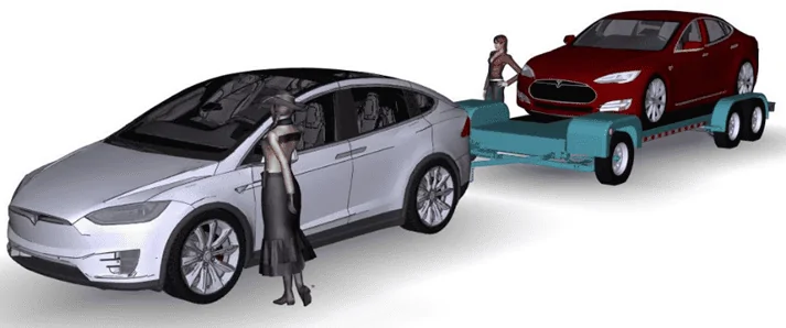

The Tow vehicle weight limitations are attributed by:
  • Tow vehicle traction, such as heavy, battery laden Tesla such as with Models S, X and CyberTruck.

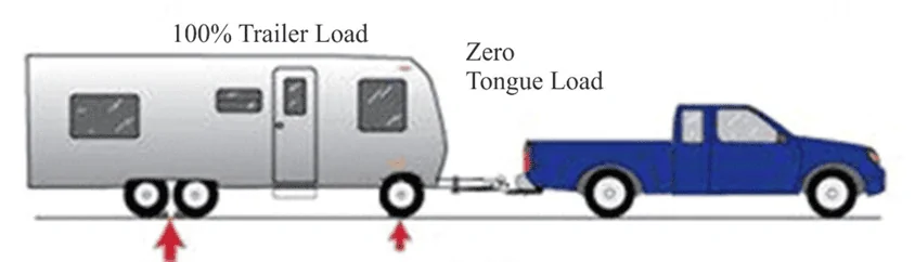

  • Standard Trailer Gross Trailer Weight (GTW = 5,000 Lbs.), when hitched to a tow vehicle, will result in weight transfer of up to ~ 12% to the tow Vehicle Hitch.

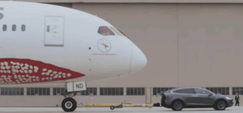

So, if say, model X, has a GVW of ~ 5,800 Lbs., with Rear Drive Axle loading at about 50% = 2,900 Lbs. This means that the Model X will experience extra hitch load of ~ 700 Lbs. which is also, Model X payload loss. This is the case with Standard Trailer design. Also, the Rear Axle Tires rolling Resistance is 24% higher.
In Pulling the plane scenario, not towing, it was only possible, with a Zero Hitch load setup. There would be no drawbar hitch load exerted on the rear suspension system, tires or axle components in the Tesla or any electric tow vehicle.
To allow electric cars, trucks and SUVs to take advantage of their true towing capabilities, trailers with Zero Tongue/Hitch Load is needed, such as the dolly Pop-trailers, (Wagon hitch set-up), or Self-steer zero tongue/ Hitch Loading trailers, as will be shown later.
Zero Tongue weight = Zero Tongue Load = Zero Hitch Load.
This also eliminates extra Tow vehicle Tires rolling resistance due to typical drawbar load transfer. This will produce a more efficient tow.
it’s also only “possible” if merely “pulling” and not “towing,” where with the latter safe performance is gauged not merely by resulting tongue weight, but ability to safely launch, accelerate, decelerate, maneuver at speed, etc.
To do those things, much of that tongue weight you’ve just eliminated along with ”inefficient” tire friction, is the exact same weight and tire friction needed by the truck to create sufficient contact to utilize any fraction of its available torque. Put a 30,000lb trailer behind a 8,500lb CyberTruck, and launches or decelerations alike become more of a tire-smoking show?
since you’ve raised the pulling stunt of the car and 747 to show what a vehicle is capable of pulling if relieved of fatal hitch load, I’ll inject a different but similar stunt to show what a vehicle is incapable of towing absent sufficient weight and so tire contact:
As initially impressive as the 747 stunt, double clicking on the physics of the CT vs F150 stunt shows that the result has little to do with torque (or hitch weight), but instead comes down to the physics of a 2WD (with single powered wheel) that weighs 20% less than another vehicle with AWD. The CT could have had 1/4 of the torque as the F150 and still dragged the F150 like a rag doll based purely on the CT’s superior weight/contact/friction.
Meanwhile, back to your trailer: even assuming the friction you’ve taken away from the back tires isn’t needed for towing performance, the entire “Zero Hitch Load” setup fails to address the predominant efficiency issue with BEV towing: aero drag.

- Pulling like a train or pulling a trailer with a Dolley, you pull as you pick up speed, fast acceleration is not a factor with pulling a trailer. No safety concerns there.
this is, respectfully, patently incorrect

A single human can “pull” a 44 ton airplane on a runway - that doesn’t mean DOT will allow that person on a highway with an airplane.

My good man, I agree with you all the way, but that was not the point I was making.
Both the standard style and SS-trailer styles are both effective and productive. I am comparing the standard 3 point trailer with, say, dolly style trailer, they both must pass certain standards, but the difference is that the dolly driven trailer will not have an exerted tongue load like a three point setup.
The SS-Trailer would have a 5 point setup. The trailers that were produced and used in Texas and east coast worked very well, as you can see the images. check " getafix56 " YouTube channel.
The trailers have brakes and work well with tow vehicles. This trailer does not jackknife, both in forward and reverse.
It was really fun to use. Lost financing, thus is on hold.
