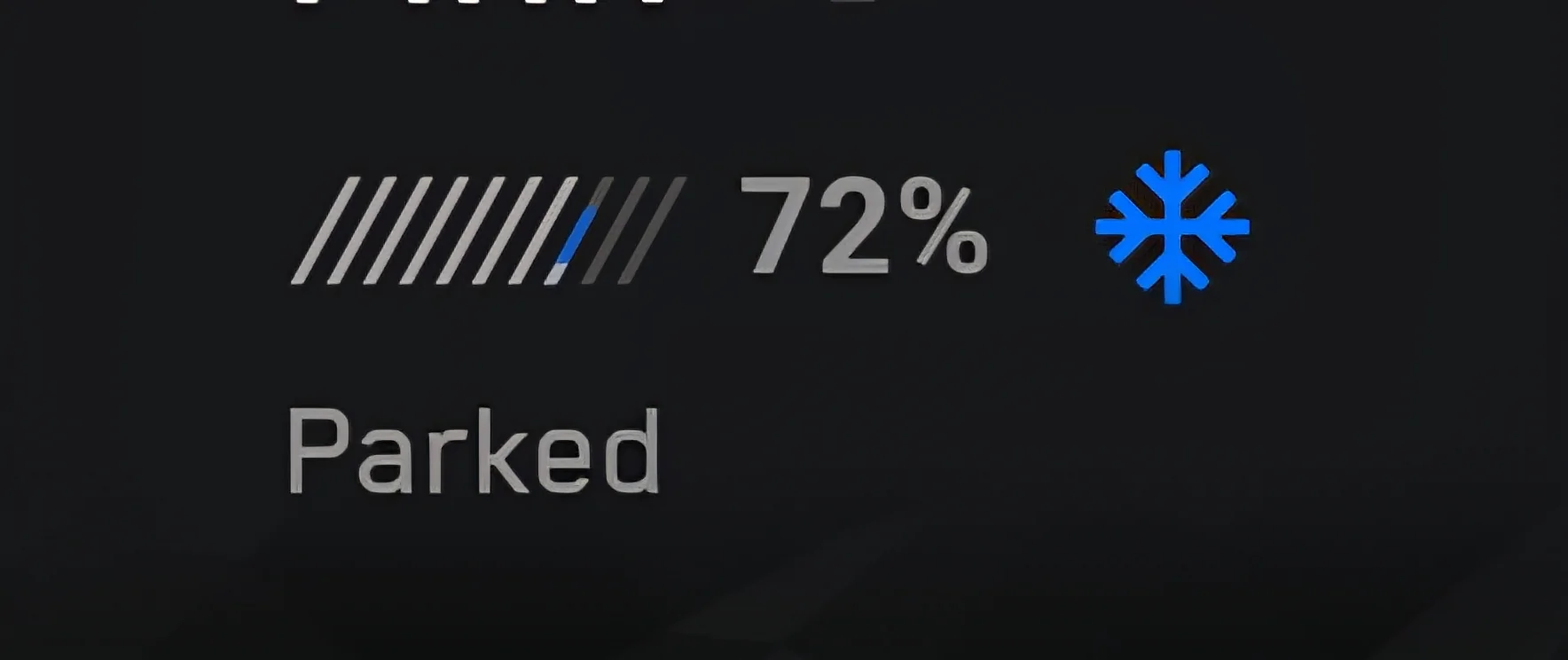

The charge limit was set to 80 and the vehicle had charged to there.
Then the temperature dropped and time passed.
So the pack was at 77% with a 5% cold derating and the UI showed 72%.
I activated climate control and 90 minutes later, it had added 3kWh net to the pack to get it to 80% with 1% cold offset, so reading 79%.
So it was always charging to 80%, but that doesn't account for cold adjustment and the UI won't necessarily read 80%. Same deal with Superchargers.

The read out says 73%, but the look at the bar graph it will be at ~80, with 7% blue unavailable energy.
Here's mine from this morning , 72% but really 77% with 5% blue.
After 90 minutes of preconditioning and charging, it got up to 80% with 1% blue.
I s now paid attention and this does not happen at all. How you get the blue bar i have no idea

It should show up in the app when the pack is cold
