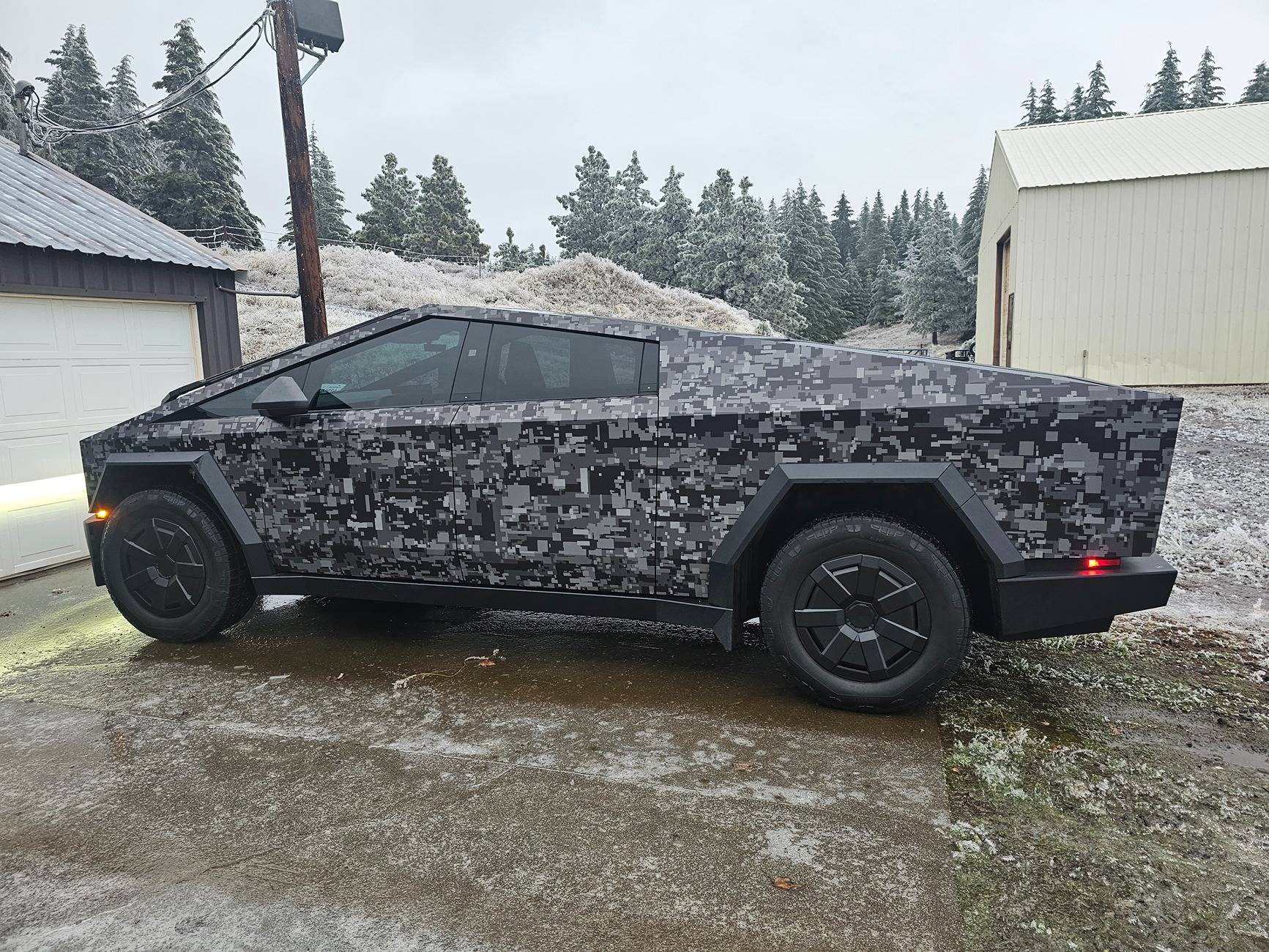

I'm a new cybertruck owner in Klickitat Heights, WA. I have a tesla charger in my garage and I keep my truck plugged in when not on use. I have my settings to charge to 80%, but the truck never gets above 72%. Even if I preset departure times. It is saying that the battery is cold (shows the blue snowflake-less energy due to cold battery).. my question is: if it is plugged in, why can't it sort out warming itself and get to the required level of charging set?
Hope i asked this correctly. Thanks millions!
