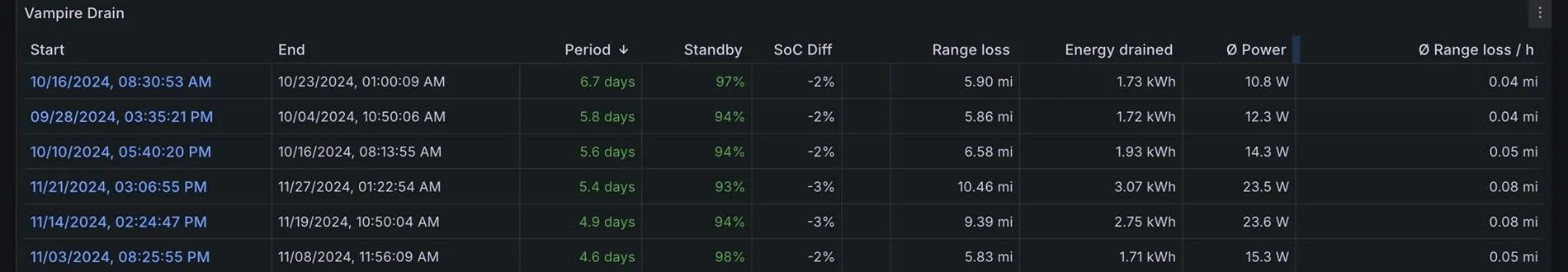

Wanted to post some data from our 2020 Model X for reference on the statement “Give Tesla time, they will get the software fine tuned.”
Our X does amazing with vampire drain. Keeping in mind we make sure our key fobs are away from the vehicle so they do not keep it awake. No Sentry Mode active. Often see it “asleep” for 4 plus days.
Tesla Cybertruck Battery Vampire Drain Observation Data (sitting in cold temperatures) IMG_0068
