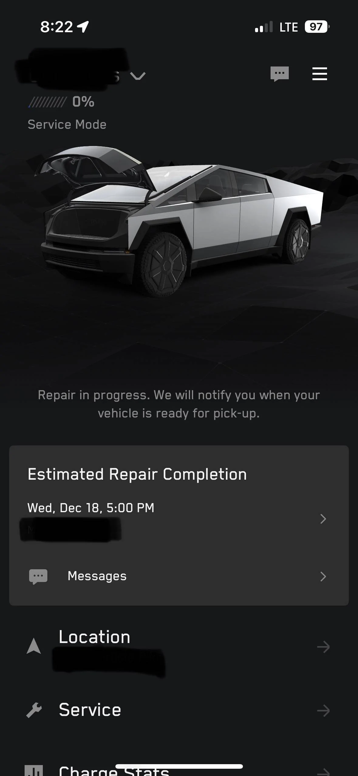

Thanks everyone. I did message service. Out of the country right now. Not sure if they called the body shop but they put it on the charger. 120v!
Was just worried this will kill my capacity or bug out some modules. I'm not sure how long it was 0%, but it was 1% last night. So I hope it didnt affect the 48V battery
I hope it will ease your concerns to know that the car is designed to be discharged to 0% (and 0% is not really 0%, more like 15%). All EVs have a buffer on the top and bottom of the battery that is there to increase the useable lifespan of the battery.
Nothing wrong with taking it down to 0% (it can actually help the battery management system get a good read on the state of health of the battery and calibrate your battery meter more accurately). And, thankfully, they didn't leave it at "zero" for any length of time.

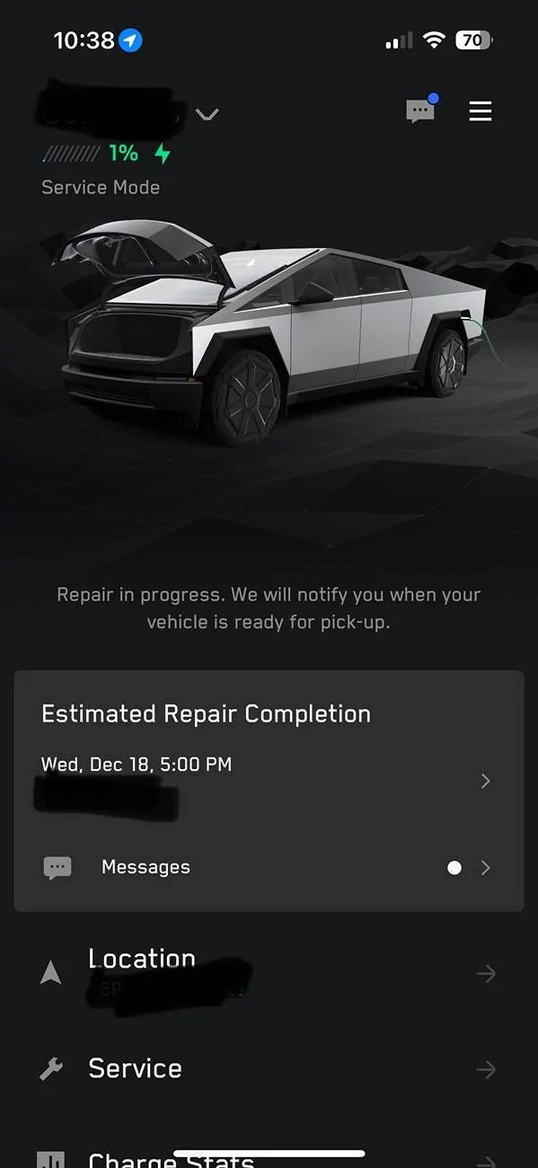

Hello all. Any issues, future problems that can occur when the battery is depleted to 0?
My truck is at service center body shop to take care of issues with scratches they caused. Just saw that the battery is 0%. Now I am worried that this can lower the battery capacity, etc. or affect other modules of the truck.

There is a buffer, but you absolutely should not be draining your battery down to 0% if you care about the longevity and health of your EV.
10,353
34,337
The pack SoC is based on voltage. At 100% the voltage is ~ 4.3V per cell (?ish) and 0% is something like 3.2V (there is a defined range for each cell type). Being at "0%" is fine and will not hurt the cell, but dropping to zero volts will damage the cell, and the voltage will slowly drop due to internal discharge.
But does that take 1 week or 1 year? IDK, I can't find any data on that, although it should be very slow.
The BMS will stop charging the MV battery when the HV pack is depleted (1%?) so the short-term risk is getting locked out and being forced to jump-start. It's strange that you could still get the vehicle status with a 0% charge, so maybe the shop already had the MV battery disconnected and was using a power supply. ?‍♂
