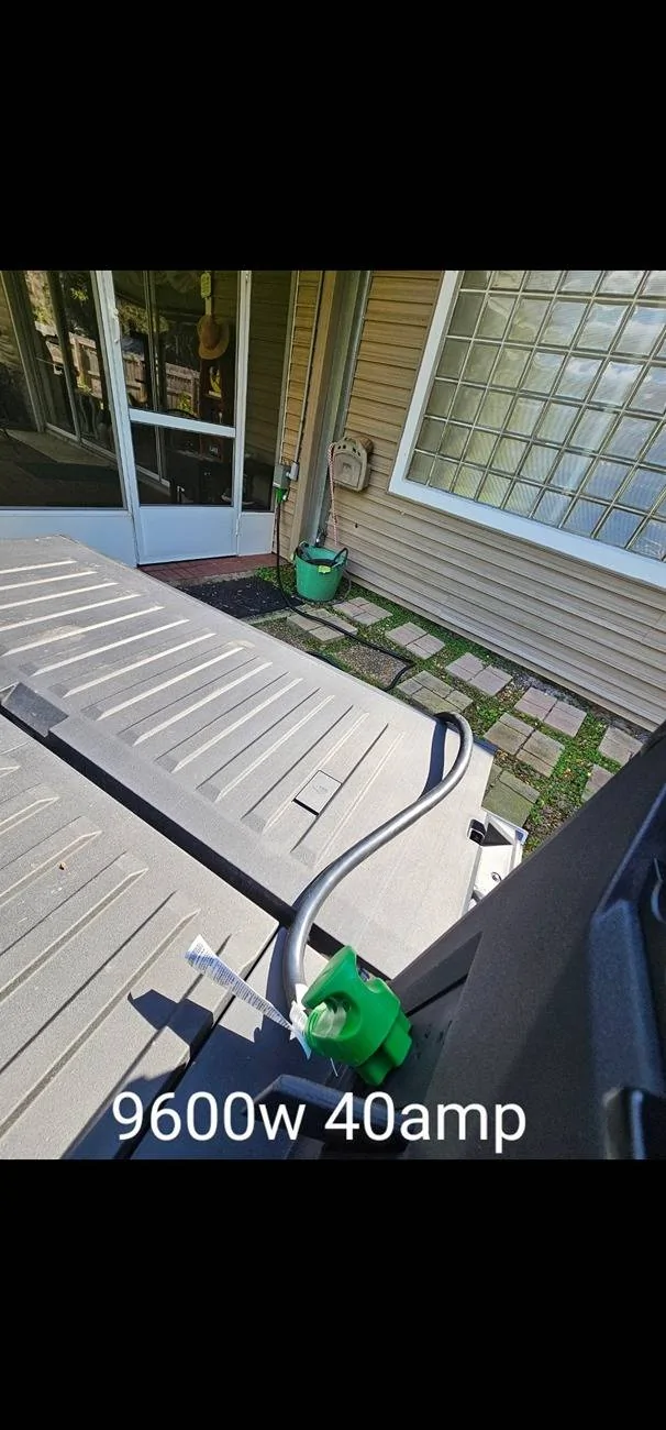

There are some video's on YouTube show this easy Truck to home power.
If you know how to have a portable generator power your home using an interlock switch (or manual transfer switch) the truck can do the same in case of a power outage. See picture.
Tesla Cybertruck Manual "Powershare" $0 1000106328

Yea, and if you don't have an inlet box you can install one for about $80, the large extension cord will cost about $150
Or if you know nothing about electricity you can get an electrician to do it for about $200 depending on your setup.
VERY affordable and easy to do, and as a bonus any electrician can do it and you don't need Tesla to "activate" your inlet, or go through Qmerit.

I have Powershare (no Powerwall, but I don't think it matters) which is before the circuit breaker panel, and then have a generator inlet connected to the panel with an interlock. Technically I can power the house using the truck connected to the generator inlet but that would be silly.
Instead, I rely mostly on the CT for short (1-2 day) outages, and if my truck gets down to 20% then I will disconnect it and use a gas generator to power the house. Then I have a mobile connector plugged in to the wall (being powered by the generator) to recharge the truck. A day is usually enough to get the truck back to a good state of charge and I can swap back to CT power for a few days.
Slightly annoying to have to manage the swap every few days but it's only needed for prolonged outages.

Cost me $175 to have an electrician do this. The next day we lost power.
It worked.
