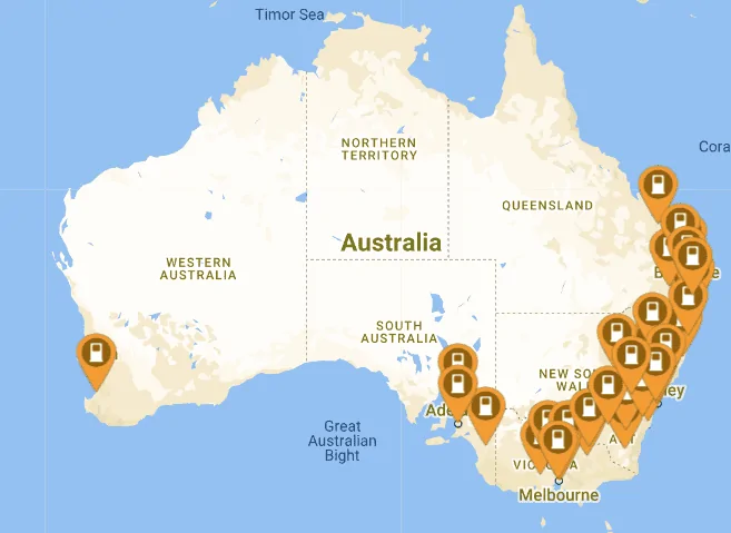

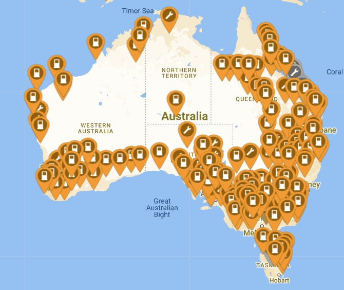

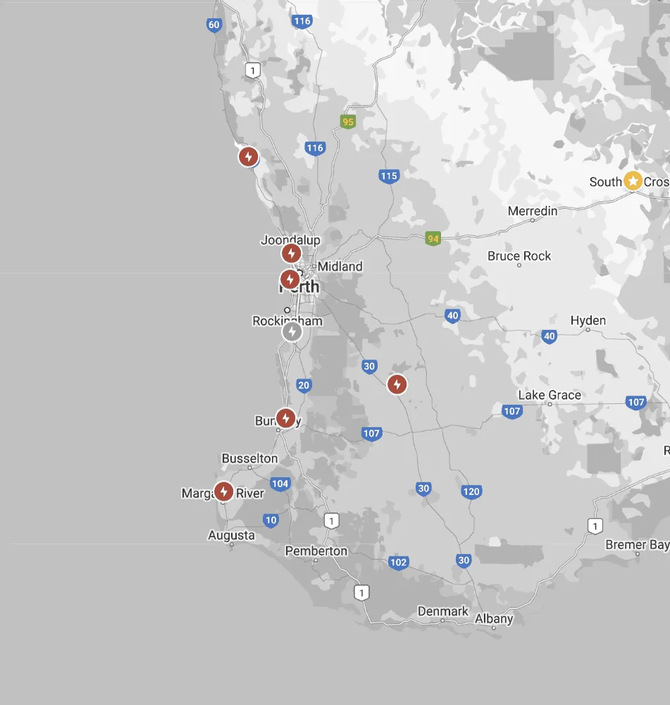

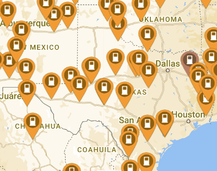

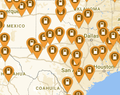

So, I'm not going to let you off saying that there are only 5 Superchargers in the country. Like Europe, you're a CCS country.
And a great number of those locations have Tesla connectors as well
So sure, if you are going inland, it's an issue.
But you may have a lot more than Texas does.
And yes, like I did my generator, oversizing your controllers is never a bad thing to do.
Lol ok.
State is Western Australia that is 3.6 times the size of Texas by itself. Australia is the same size as the contagious USA, so much larger than 3.6times the size of Texas. CSS is a connector type but far from a "Supercharger" let alone a Tesla one. These are the now 6 Tesla Superchargers in Western Australia. There's a few recent non-Tesla Horizon Power installs that have gone in late this year under the national EV charger expansion program, but many of those are only 50kW, and top out at 150kW in regional areas because the grid can't cope with more.
Tesla Cybertruck Solar → Battery →← Powershare - How to this? 1704037010134

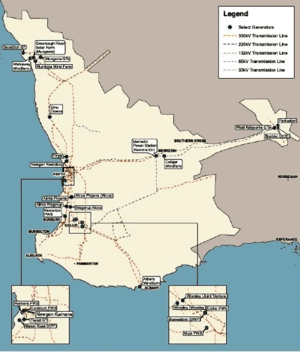

This is the extent of the WA SWIS grid:
Tesla Cybertruck Solar → Battery →← Powershare - How to this? 1704037861530
